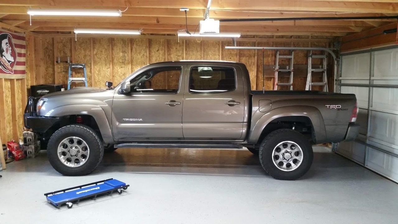

    So Discount Tire damaged the center hubcaps on mine and has offered to replace them with OEM or aftermarket. Anyone care to find me alternatives that will fit these wheels? Mine are the darker ones that came on the FJ. Pic below for reference.
    I really don't like how my sockets scrape the inside of the hub caps.
