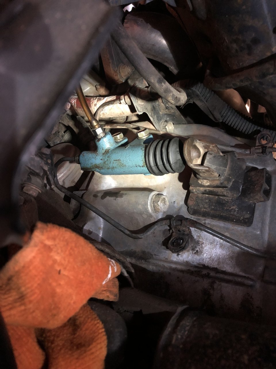

    Issue: The clutch pedal failed to return all the way again. Bled the slave cylinder and a bubble popped out again. After awhile the clutch pedal showed the same symptoms. I decided the 21 year old rubber seals in the slave cylinder were probably the culprit so I rebuilt the clutch slave cylinder with part number 04313-17010 from Toyota. Simple job. Clutch pedal return is normal again.
    Also - I flushed the cooling system and filled with 50/50 mix of Toyota Long Life red and distilled water. I actually removed the radiator first and sprayed the fins with water to clean out the bugs and dust.

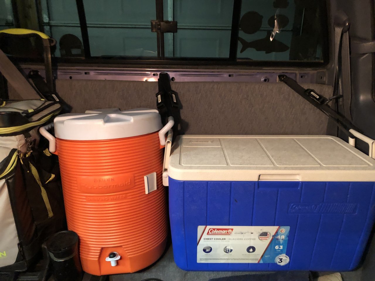

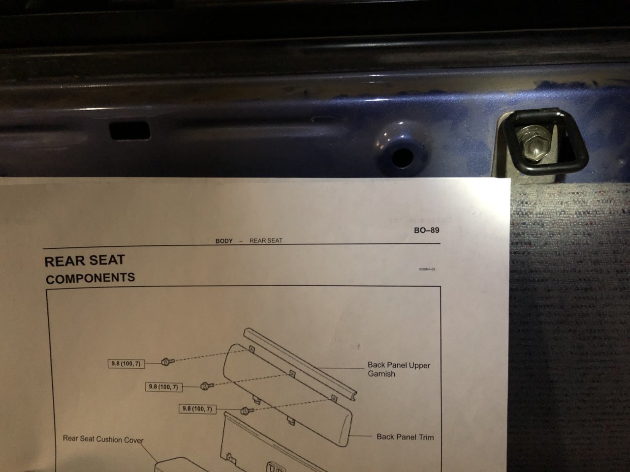

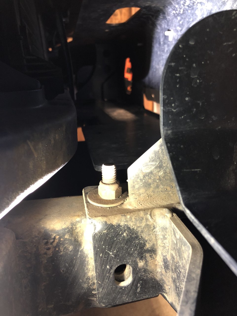

    Issue: I carry a 5 gallon Igloo water cooler and a 48 quart Igloo cooler in the back of the extended cab on weekend or longer off road trips. The coolers tend to slide forward on trails because they are not tied down.
    Solution: Figure out a way to tie down the coolers.
    I looked at the Factory Service Manual page B0-89 "Rear Seat Components" diagram and noticed there are 3 hex bolts under the back panel upper garnish. Those would be good tie down points. I pried the garnish off with a screwdriver.
    I bought some D-Rings and installed them.
    I went to Murdoch's and bought 12 feet of 1 inch wide nylon strap and 4 buckles
    I cut the strap into four 3 foot lengths, added the female buckle, looped the strap through the D-Ring and cooler handles, then added the male connector. I also have a Rhino Tech Titan soft sided cooler strapped down with the seat belt. The 3 coolers fit snugly preventing lateral movement. And now the new straps prevent forward movement.
    So the next time I go to Steel Bender, my ass will not get wet from the 48 quart cooler sliding forward and tipping ice water onto my seat. :cookiemonster:

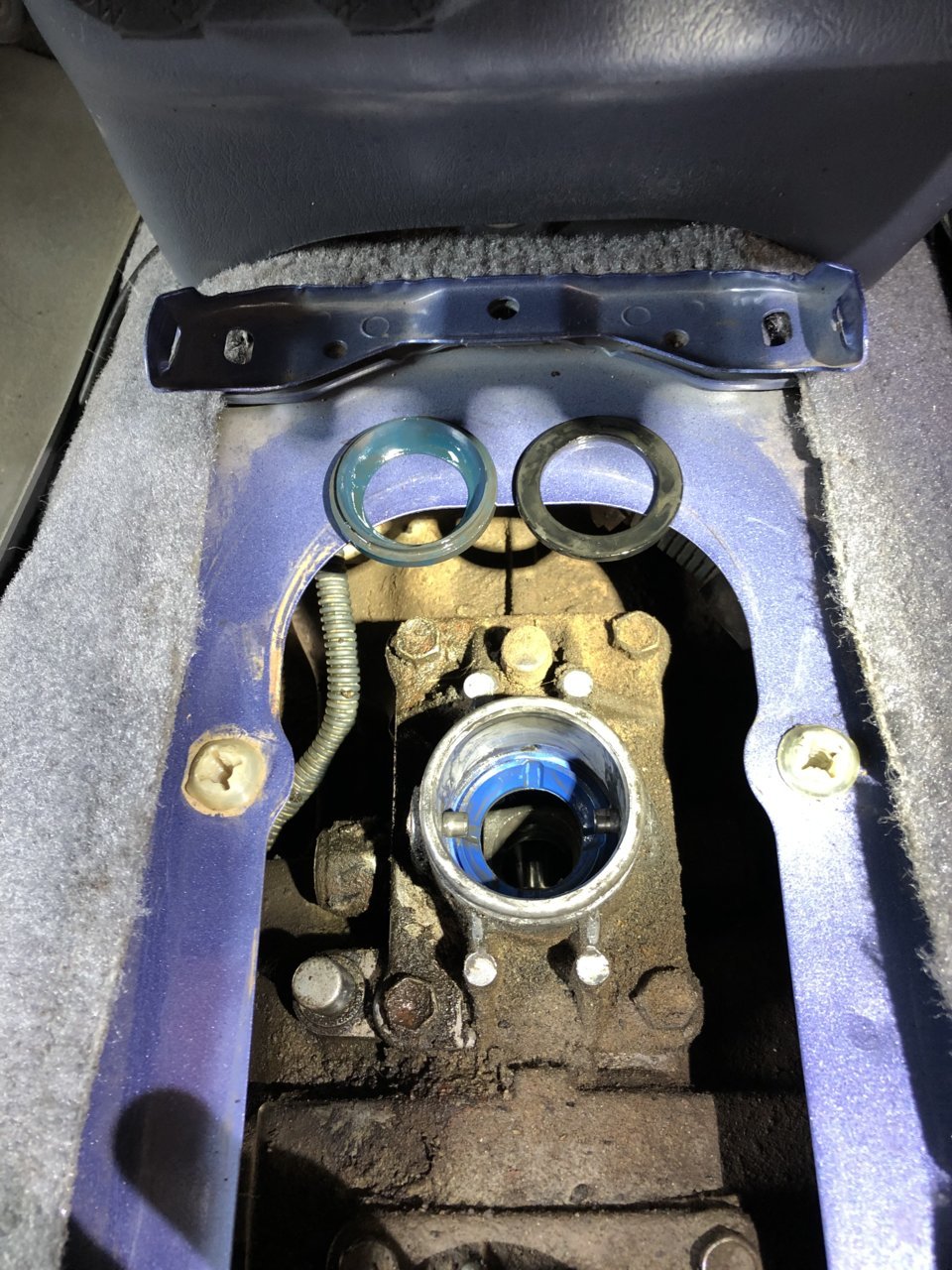

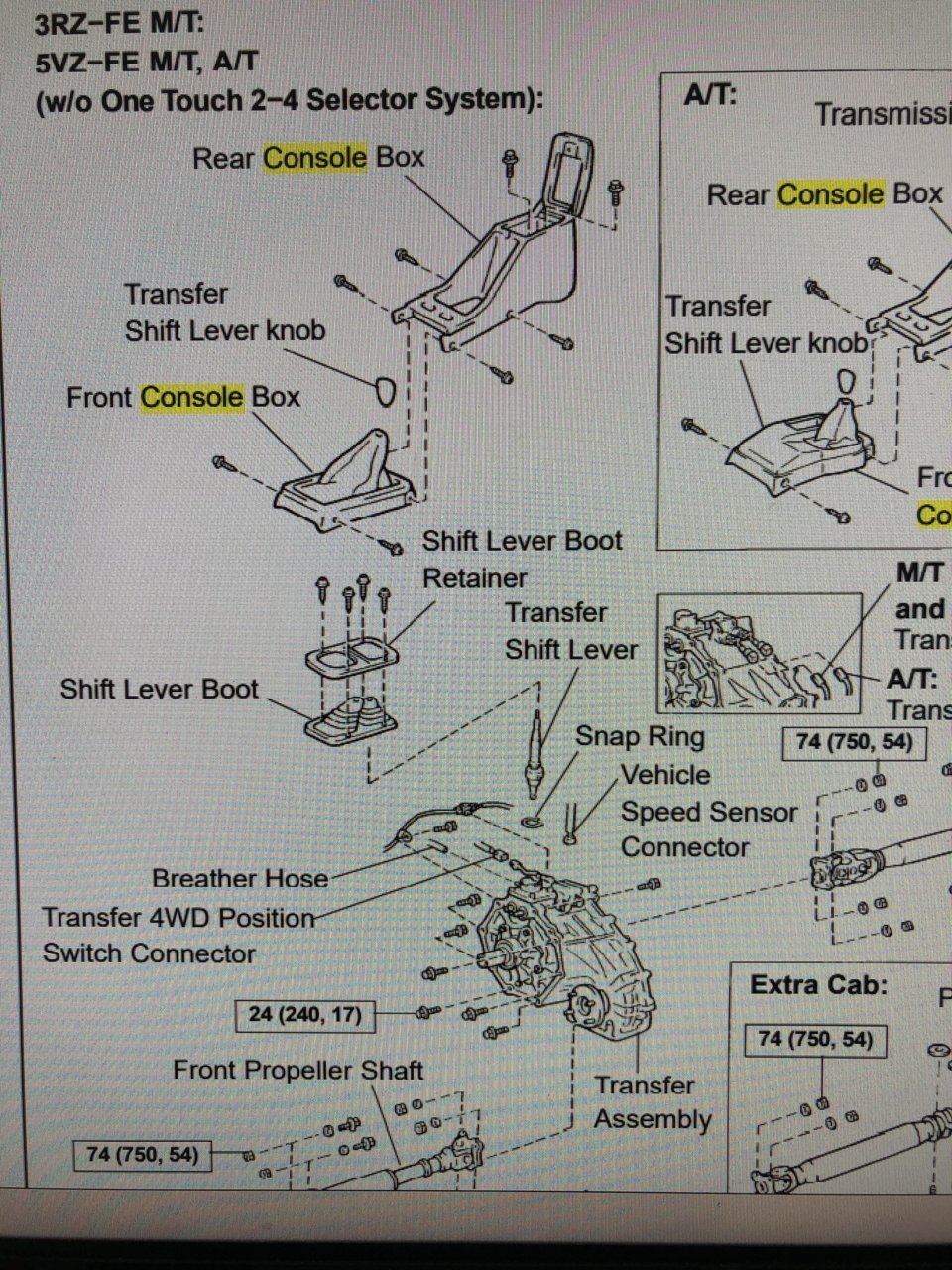

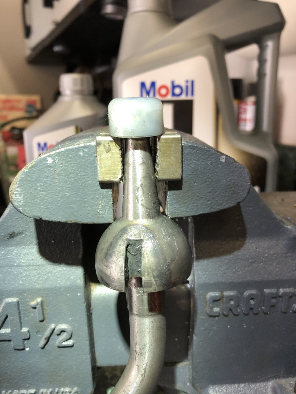

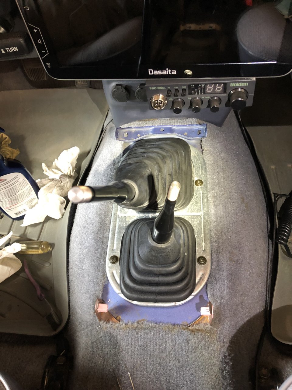

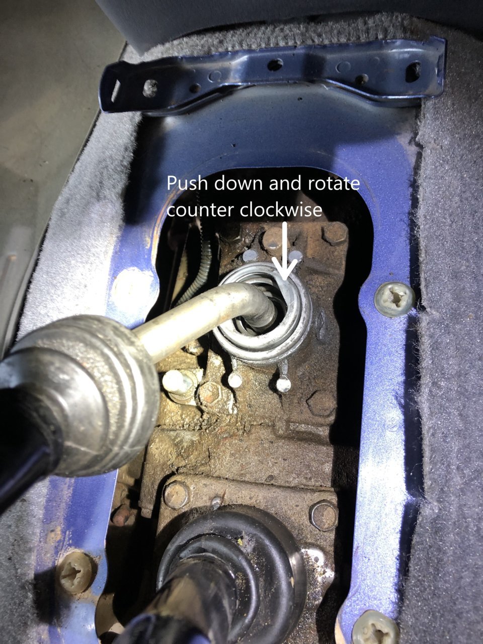

    Issue: My daughter in North Carolina has a 260,000+ mile, 2002 Tacoma with a manual transmission shift lever that pops out of 1st gear.
    Solution: Replace the shift lever bushing and seat.
    At 161,000 miles, mine works fine but I am going to replace my 22 year old plastic bushing and seat as preventative maintenance and so she can see how to fix it. Hopefully the 2002 and 1999 are the same.
    Purchase the bushing and seat:
    Remove Front Console box. I also removed the Rear Console box for easier front console box removal and so I could clean it easier. As you lift the Front Console box, it will naturally want to rotate 90 degrees clockwise to make it easier to clear both the transmission and transfer case shift levers.
    Remove the shift lever boot retainer (4 screws)
    Remove retaining cap by pushing down and rotating counter clockwise. I had already pushed down and rotated when I took the picture.
    The plastic bushing was hard for me to remove by hand or with vise grips so I set it in a vise and hammered down on the shift lever.
    Be careful not to scratch the shift lever. This picture has the new bushing installed already. I forgot to get a picture with the old yellowed bushing.
    Remove the old seat and install the new seat. Picture shows new seat installed and the old seat sitting on the floorboard tunnel. The seat has two pieces. IMG_3872.jpg
    Assemble in reverse order as disassembly. Takes ~ 30 minutes to an hour to complete.
    Note to self: oil and filter changed.
    Deathbysnusnu and 5280 like this.

    I bought a short shift kit from Marlin Crawler and it comes with their version of those bushings...hopefully get to it in the near future! Did it make a difference for you?
    Winkle99[QUOTED][OP] likes this.

    My shifter was fine so I didn’t notice a difference. I created the instructions for my daughter who is 1800 miles away. Her Tacoma shifter pops out of gear. She texted me that she plans to work on her Tacoma after the next paycheck. Hopefully, I ‘ll get a followup text in the near future saying the problem is solved.

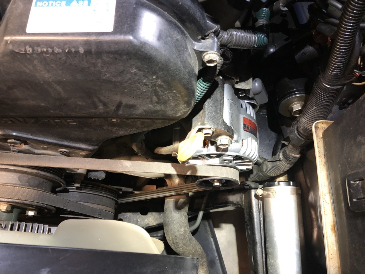

    Issue: Alternator bearing squeaks probably from being submerged in too many water crossings last season. Still creates 14 volts but it is 11 years old. I decided to replace it with a Toyota remanufactured alternator.
    Winkle is stealthy quite again.

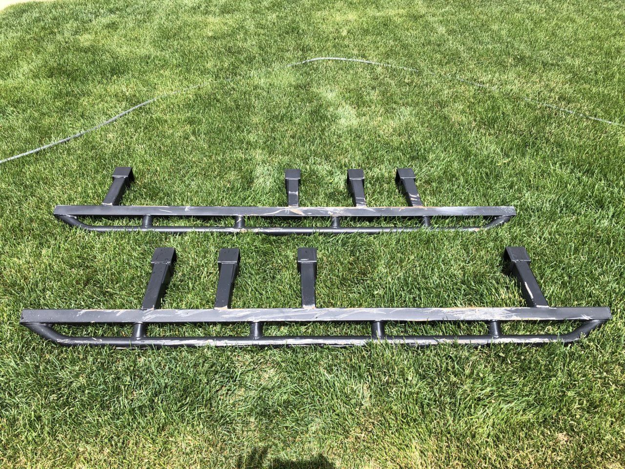

    Performed some preseason maintenance. Painted over last season's scratches in the rock sliders, skid plates, and bumpers with Rustoleum zinc primer followed by flat black.
    Pressure washed the underside, checked for soot inside the frame (it was cleaner than I expected) and cleaned the leaf springs.
    Greased the plastic disc interleaf liners between the leaf springs, greased the drive train and fluid filmed the frame. Cleaned out the engine bay. Cleaning causes me to inspect parts more closely. Winkle is ready to go!
