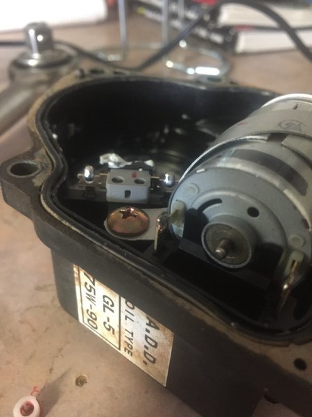

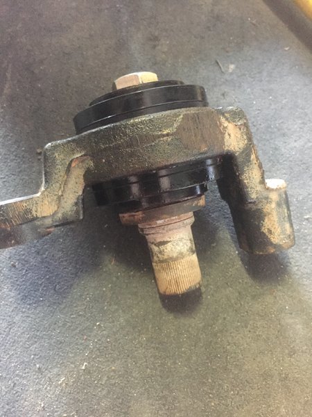

    While I had the front diff out, completed a few other upgrades. The first was the last Energy Suspension bushing from the kit, I installed all the others last year as they were easy access, this one you need to pull the diff to get to.
    Second was soldering up the ADD motor connections which are a known weak point causing the ADD to not work, I had not had any of the issues yet. All of my connections looked good with no arcing, but an easy piece of mind mod.

    With the diff out, it is a 10 minute job, figured I might as well. To note, it looked immaculate inside.

    Man fuck that mount. I hate dealing with that mount.

    Indeed, every write up says to pull the bolts from the diff, but the one on the top is all but inaccessible while on the truck, so you have to clear the bolt out and then back in the frame hole, which sucks.
