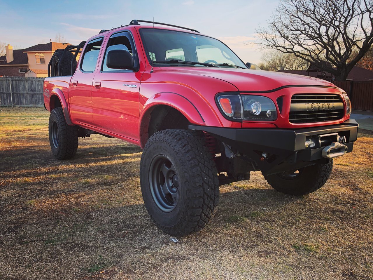

    Man the rest of the background makes the red look so damn good...

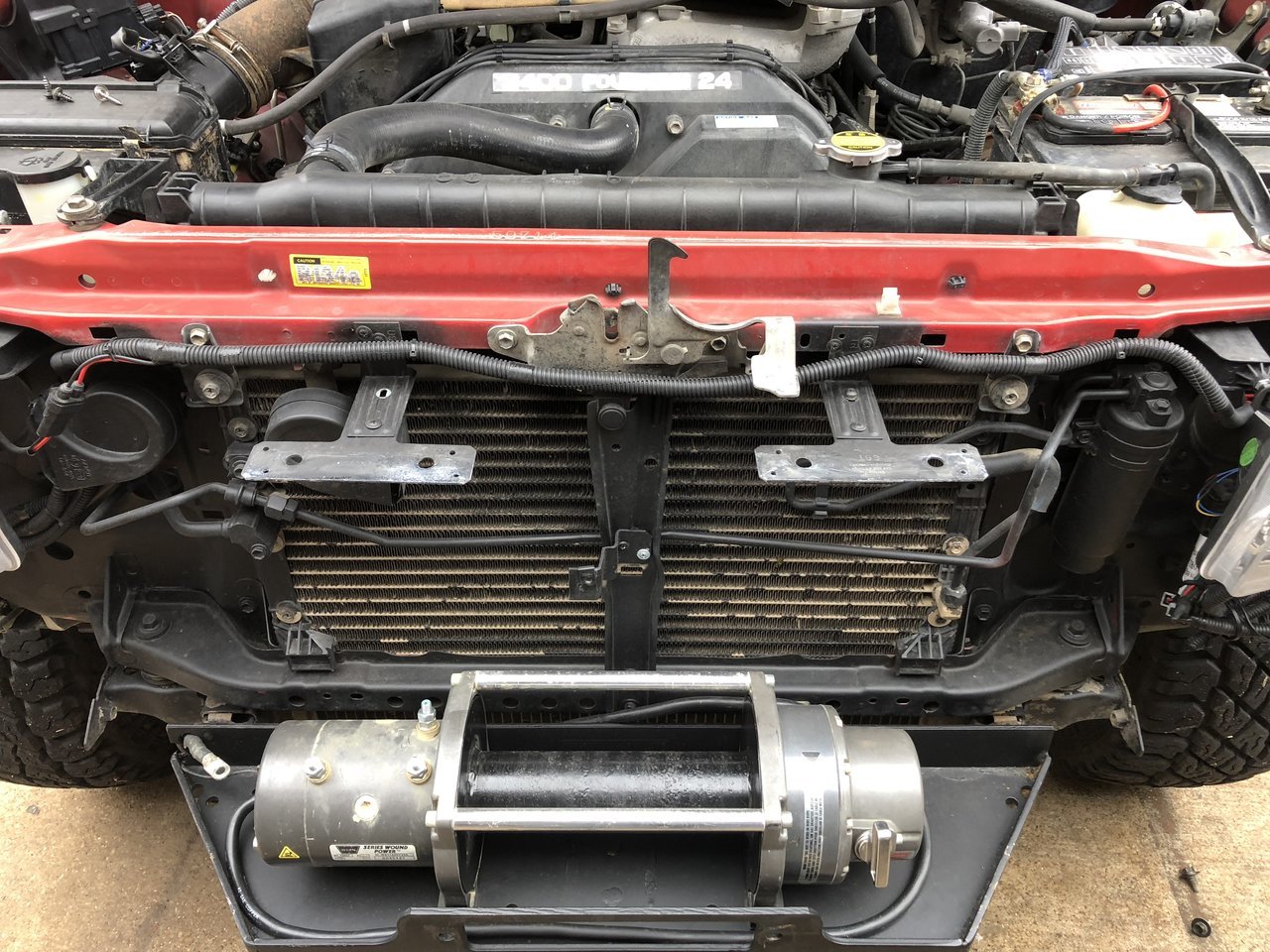

    Btw Nick, I love your synthetic line on the winch..invisible.

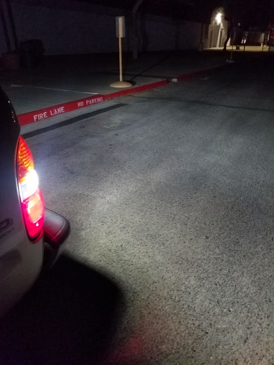

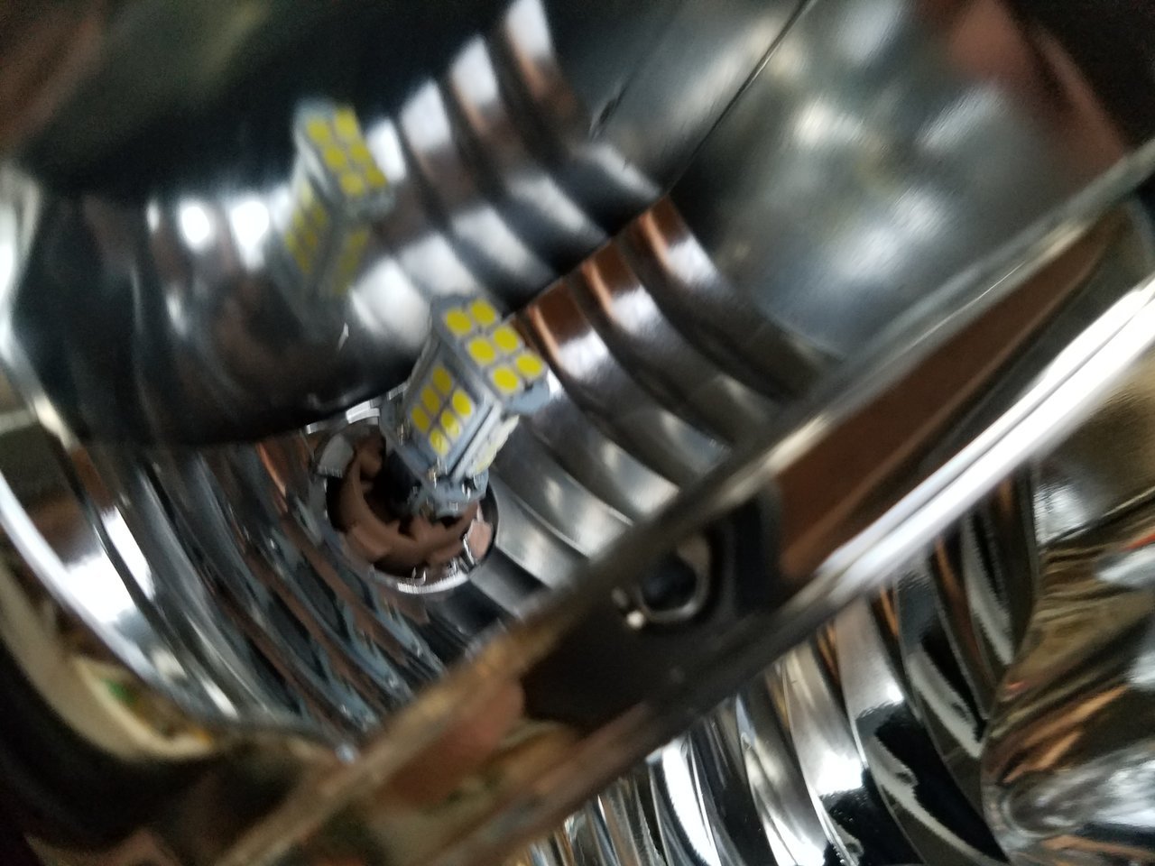

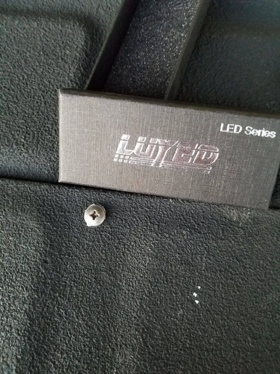

    Thanks for the tip on the backup LED lights. Damn, what a difference!!

    Like daylight now right?

    Yeah man! Now you just need to invent the "back up light on when not backing up" mod so I can hook up my boat! LOL!
    No pressure my man!!

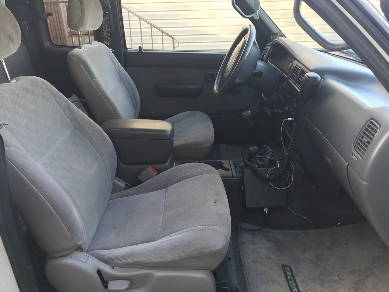

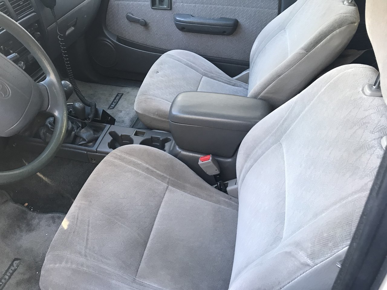

    did this a week or so ago, but I swapped out my 97s 60/40 hard as a rock bench seat setup for a 2002 bucket seat setup, even scored a center console with real cupholders!
    Before:
    After:

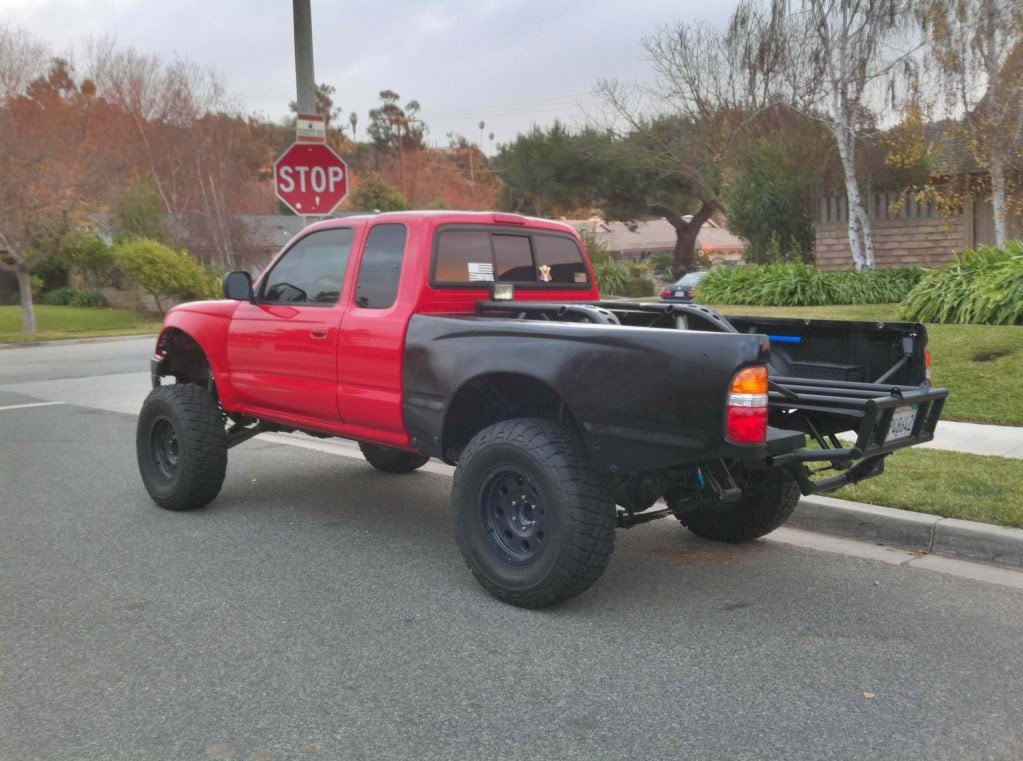

    thats one hell of a tacoma , im sure youve been asked hundreds of times but what are your tire, wheel and lift specs?

    Thanks!
    Wheels are FN Wheels Five Star 16x8 -25 and General Grabber AT2 285/75-16
    Front is Eibach Toyotech lift spring + Bilstein 5100, rear leaf pack I've built from cutting up Chevy HD2500 leafs + 5100s. ~3.5-4" lift
