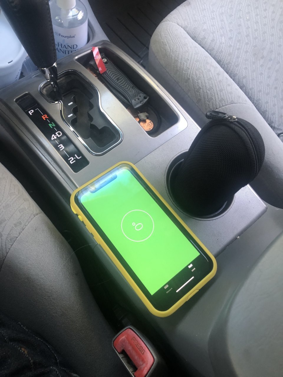

    Been working on a little gizmo to make leveling my truck easier. I'm not a fan of the inclinometers that mount on the outside of the truck because they are... well... outside of the truck! And, the inside inclinometers are all more aimed at not rolling your vehicle (it seems) and are big and clunky. I noticed my iphone's level is pretty sweet so I'm cooking up a design for a leveler that uses the iphone level so you can level while ooching around a camp spot:
    V1 works pretty well! you stick it on your center console, then get the camper dead level (I used a carpenter's level) and then you dial the screws around till your phone is also reading dead level. One thing i learned is your body is really sensitive to level-ness. Turns out there is a little hysteresis in the phone's level so we were sleeping ever so slightly with our feet higher than our heads. (<1°!?!) So, I need to bias the calibration so the phone is somewhere between dead level or with the foot of the bed up to 1° pointing down hill. Other things I will improve - the PLA is not hot-car compatible, and my 3d printed bumpers are not soft enough... so, on to V2.
    If anyone is interested i might make a couple and ask for your feedback!

    How do you access the iPhone leveler? Settings or an app? Thanks.
  20. Oct 11, 2021 at 9:59 PM
    #200
    Zebinator
    Zebinator [OP] Well-Known Member
    Nov 30, 2014
    #143381
    931
    Norcal
    06 Tacoma TRD Offroad
    search for the 'measure' app. it's standard on ios... there's a button in the app to switch to level. it's pretty good! I used it to align my front end! (better than the $50 digital level from home depot!)
