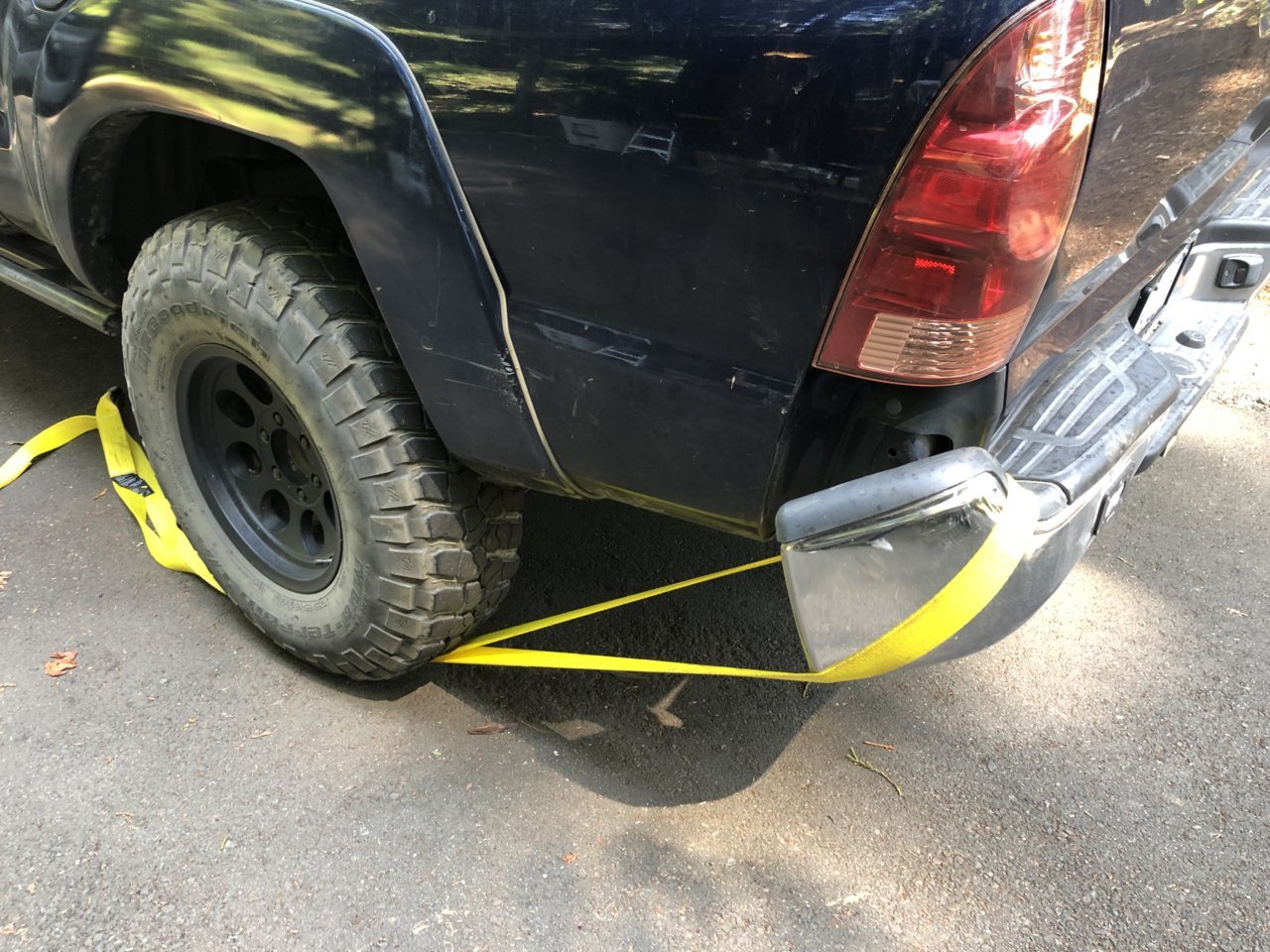

    Found a stump with the rear bumper... (TOOK LONG ENOUGH!)
    Did a little temporary fix to keep the gate from hitting it. Should be good until I can get a plate bumper on there!
    Now - to cut the quarter panel off or not....

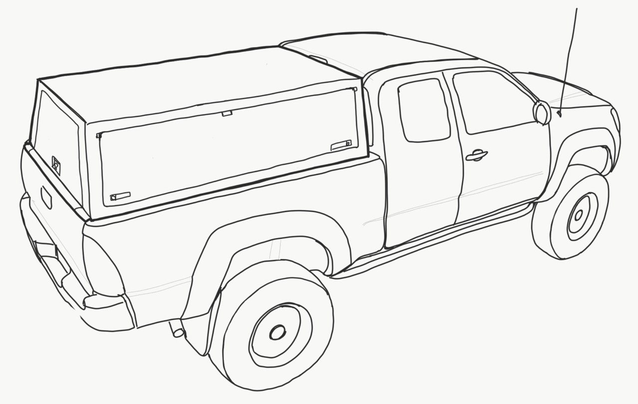

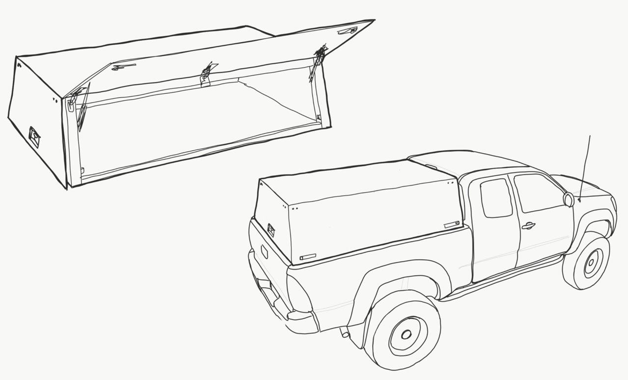

    And, also contemplating a DIY'd camper shell. Try and dissuade me! Ha ha.
    Same thread idea here:
    https://www.tacomaworld.com/threads/building-a-bed-topper-camper-shell.631476/#post-21660145
    I'm worried i'm going to hate the sharp edges and wind noise of the shell idea... Might mock something up and drive it around to test...

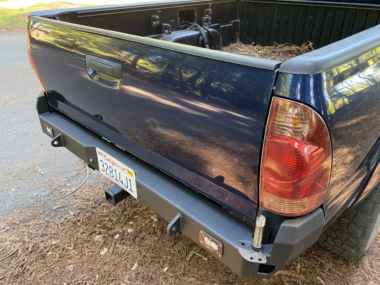

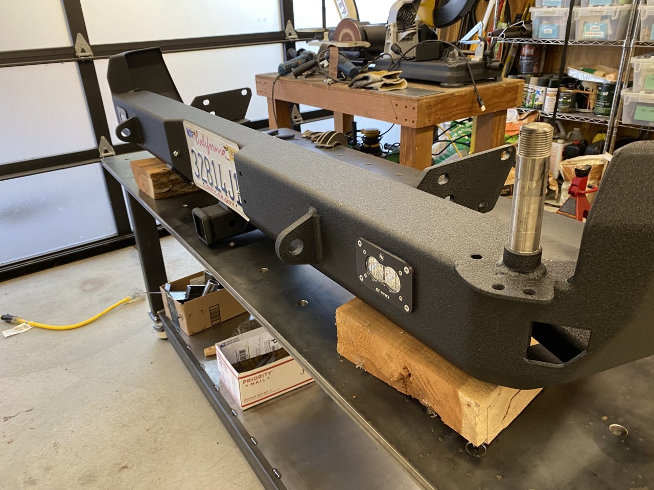

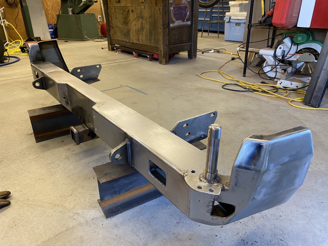

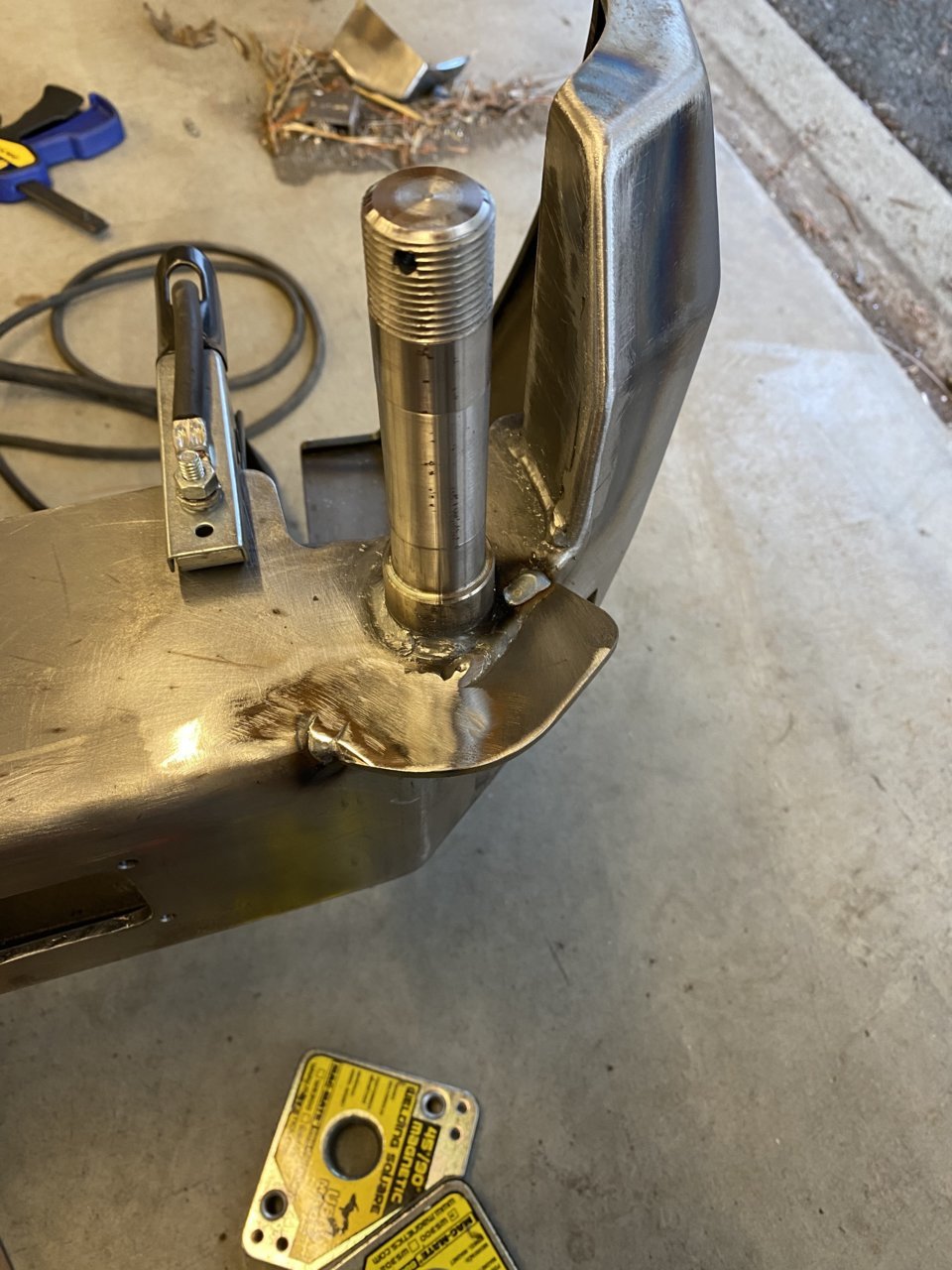

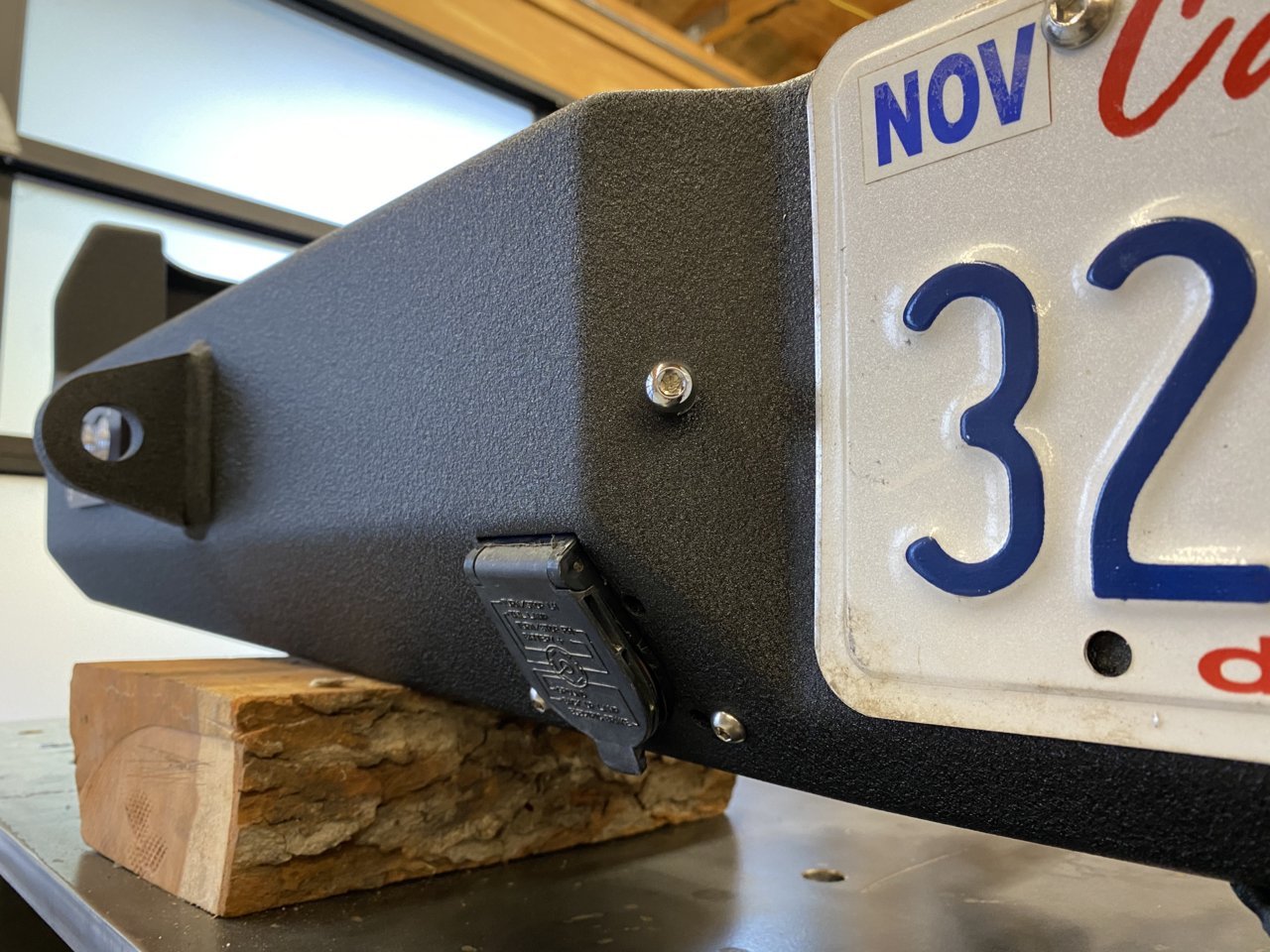

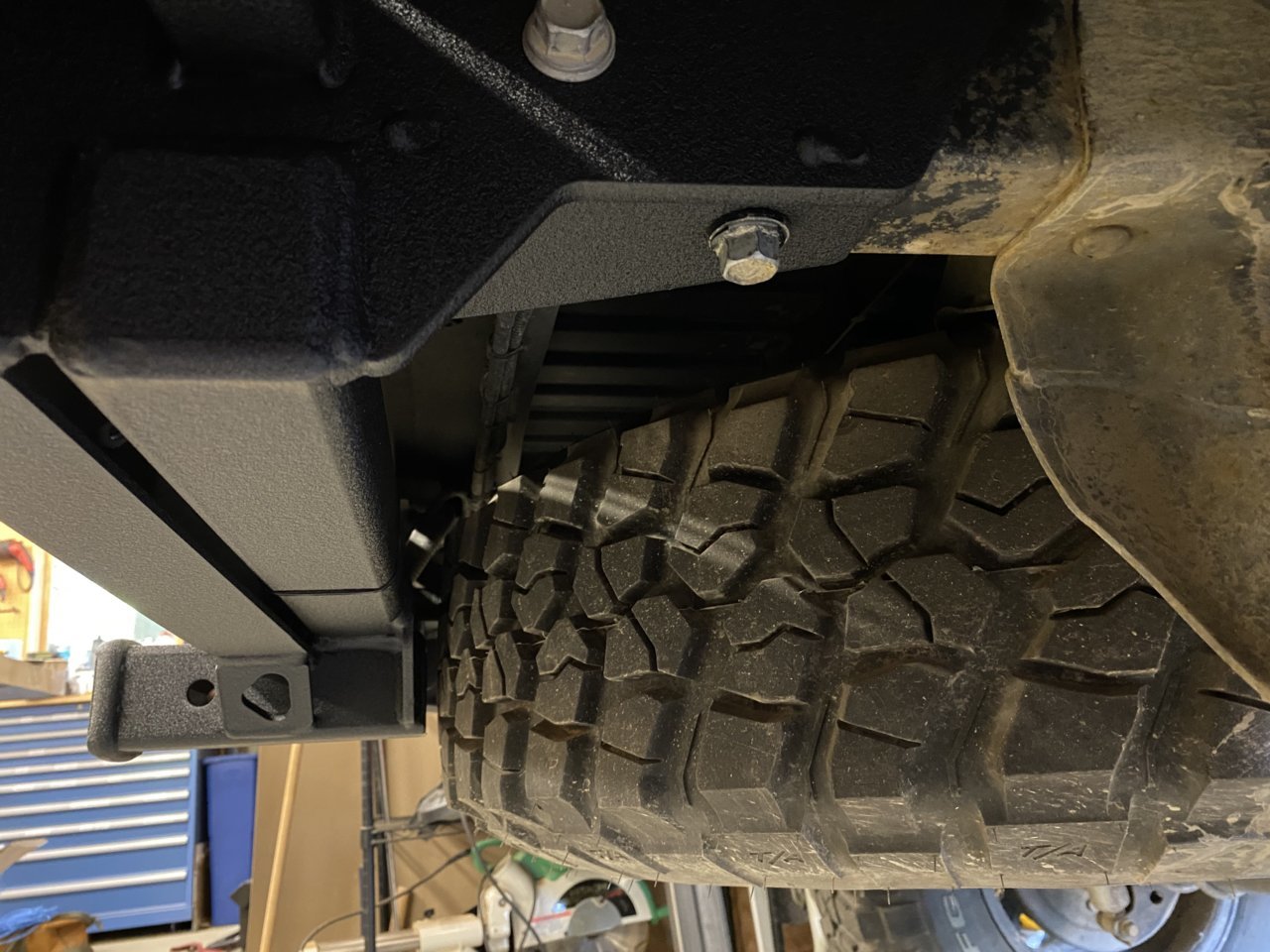

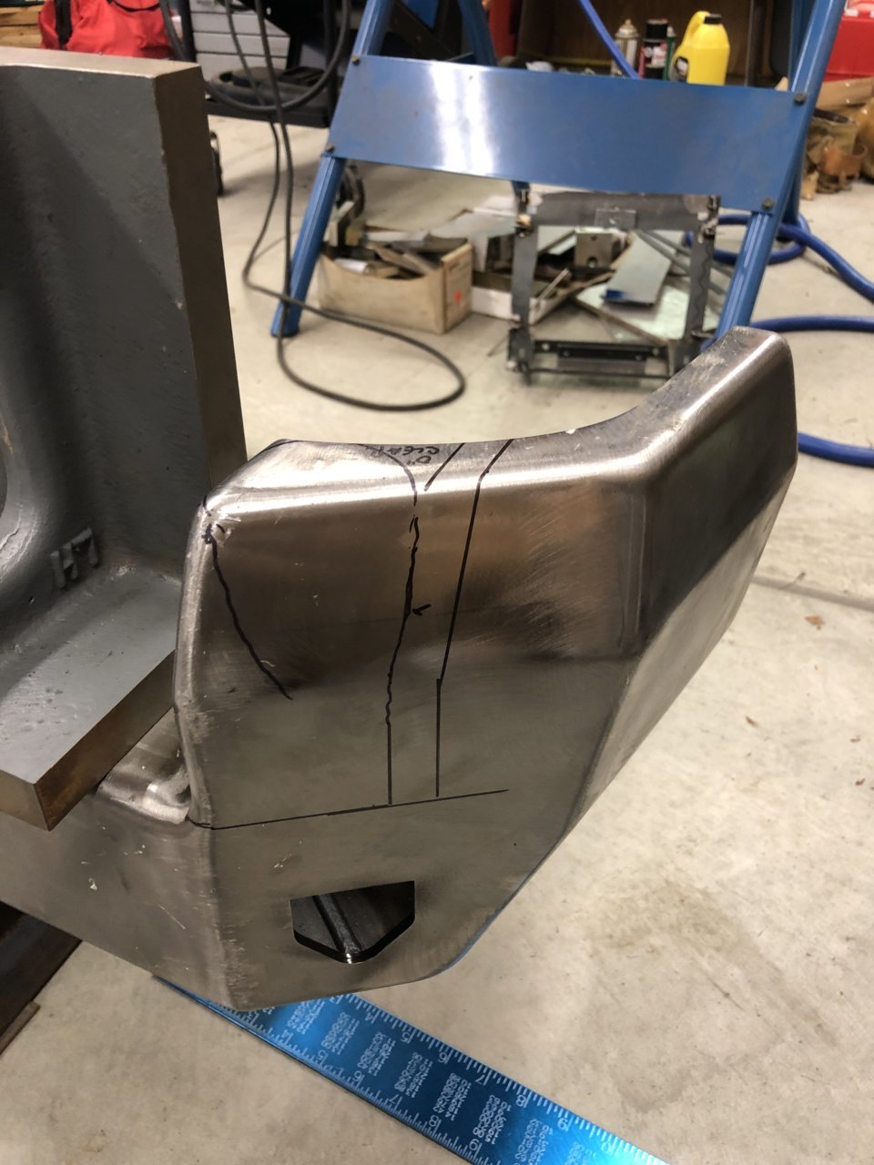

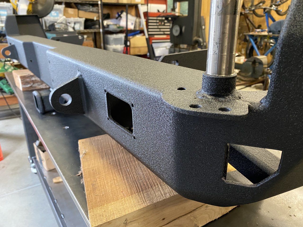

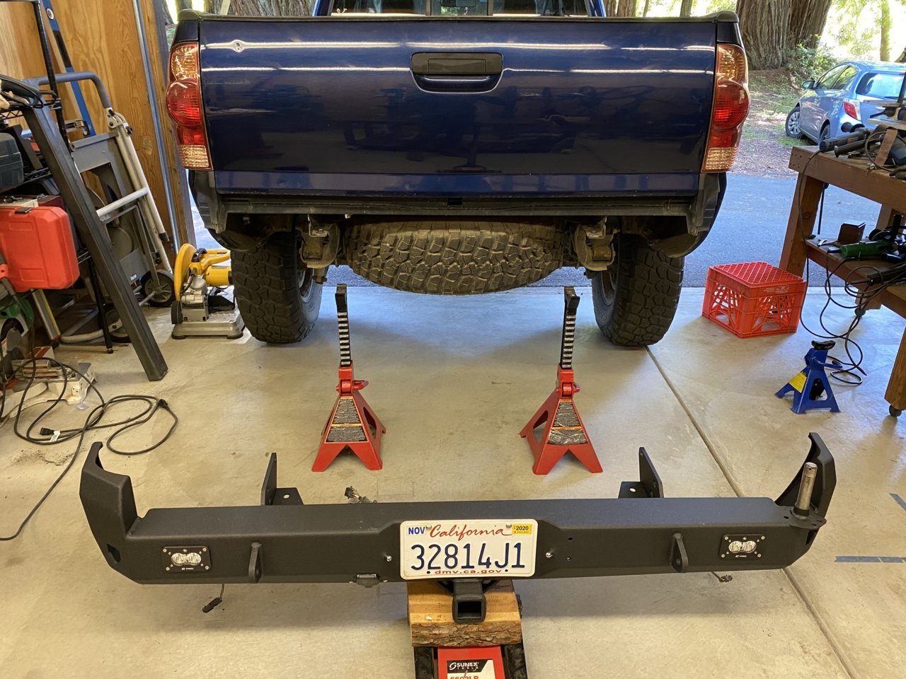

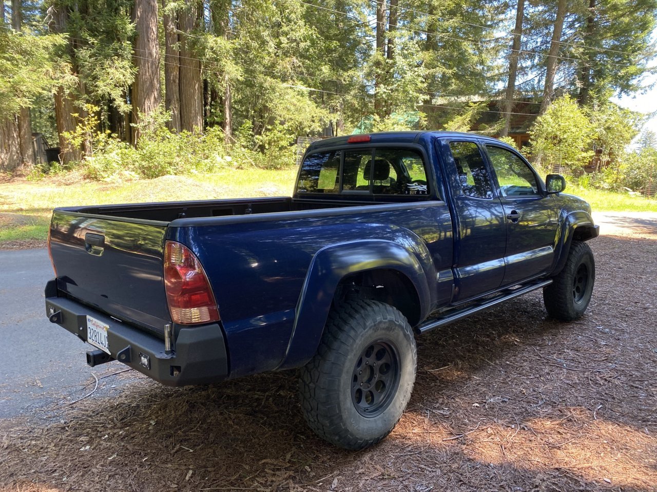

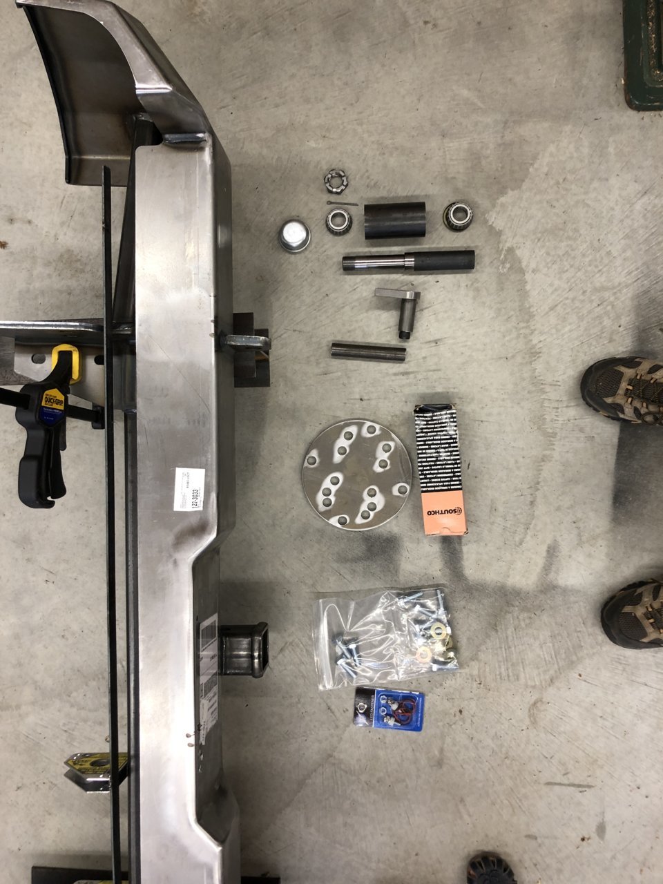

    Rear Bumper/Tire Carrier Build - Part 1 - The Bumper.
    Ok, a little write up of the bumper build, thus far...

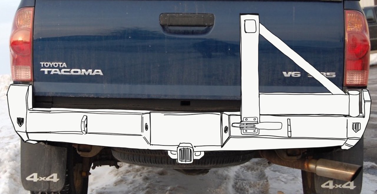

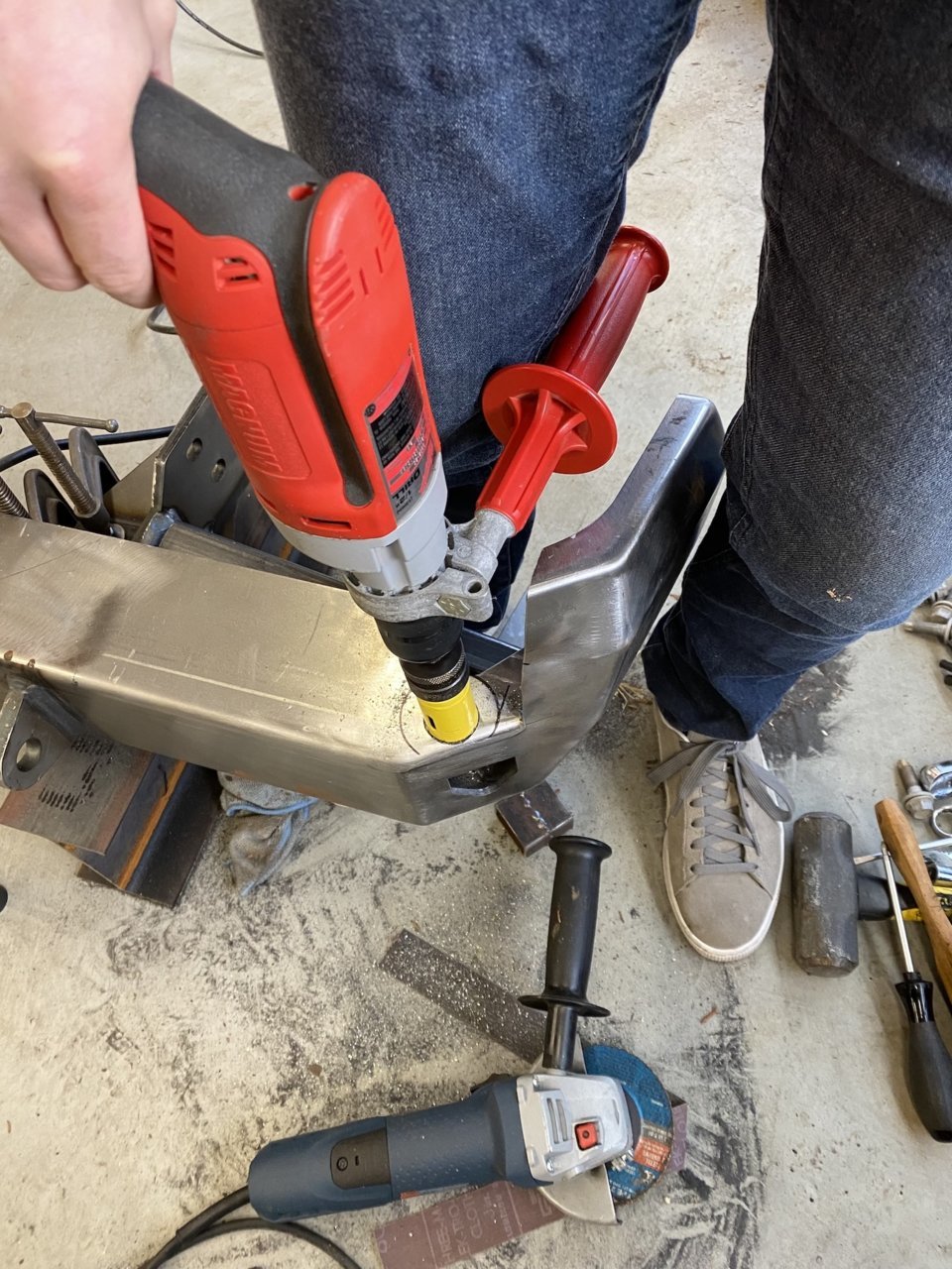

    My goal for this was to balance the following in a plate rear bumper: high clearance, rating towing, stock fitment/look (no fender cutting) swing-out tire carrier compatible, and, with hi-lift points. I still use my truck as a truck and so having a carrier permanently on the back was not appealing. Plus, I've got my pizza cutter neatly tucked under so, why mess with that.
    A lot of pre-build details and process shots are in this thread, but I thought it might be useful to collect the important bits in to one post. Here goes.

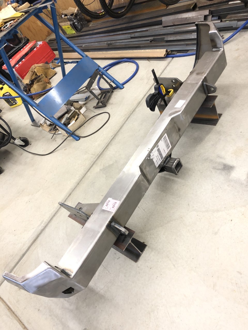

    I decided to base the design on a 4X Innovations bumper.
    Priced right and unpainted. In fact, they just ship it with a label stuck on it!
    Southco latch, AtoZ Fabrication swing out kit, (sadly unavailable do to a tragedy - sorry to hear AtoZ!) and we're off to the races:

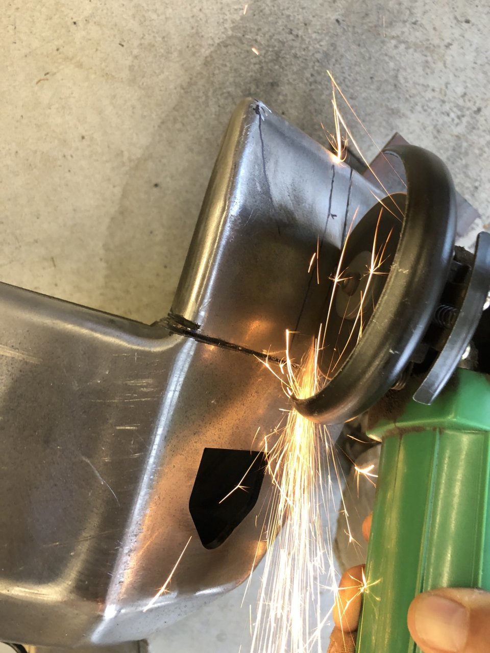

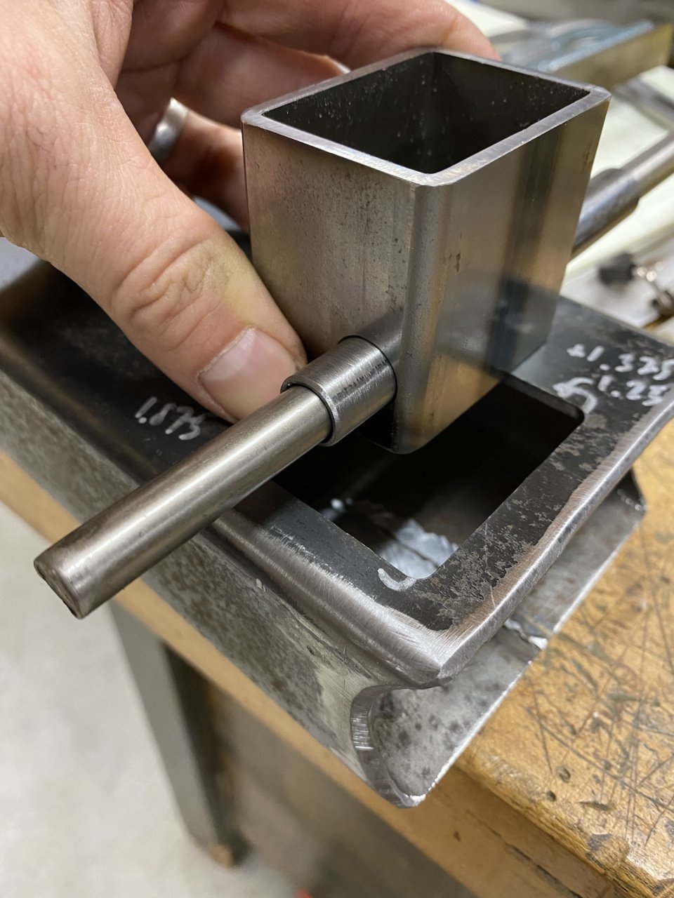

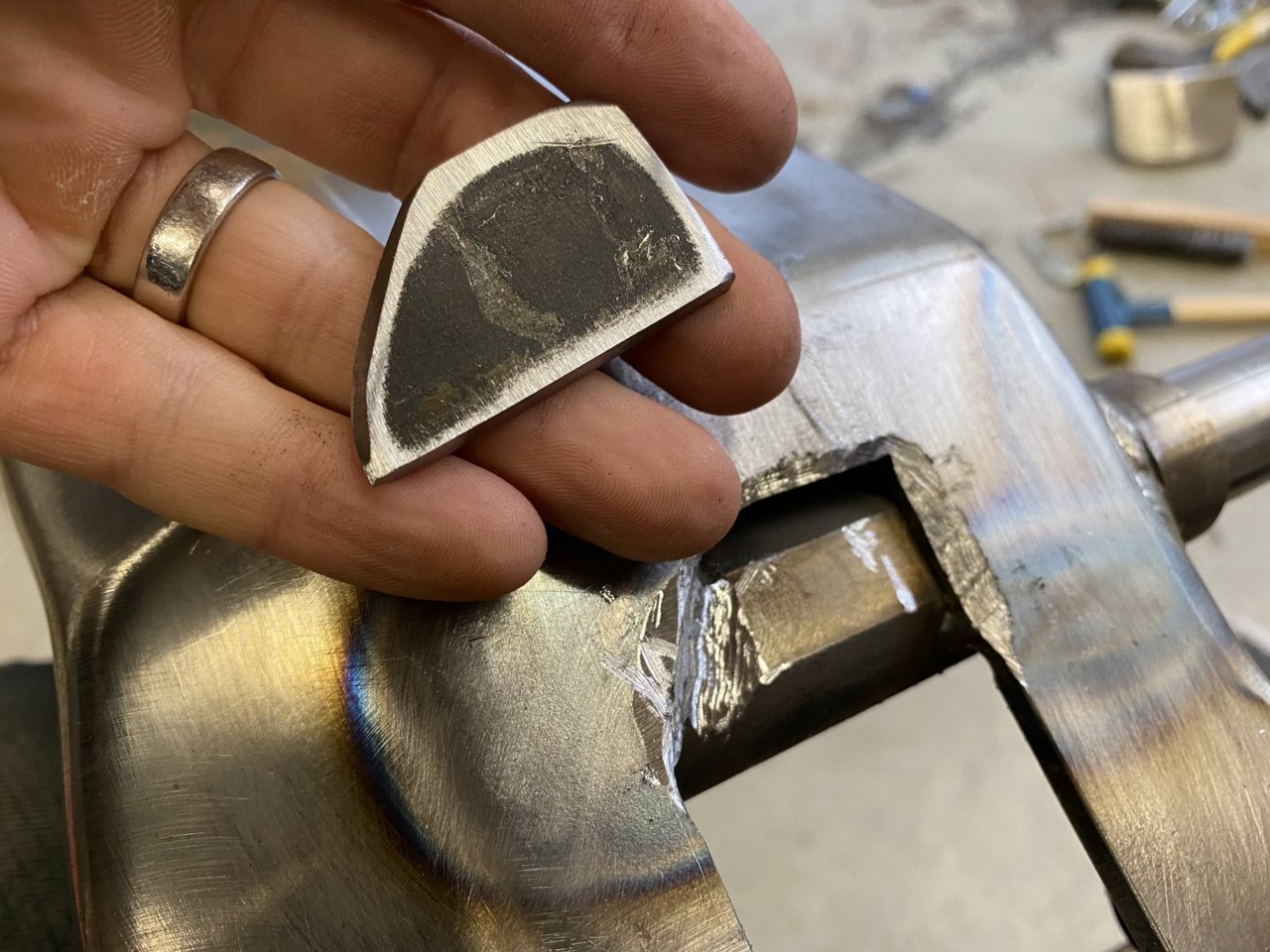

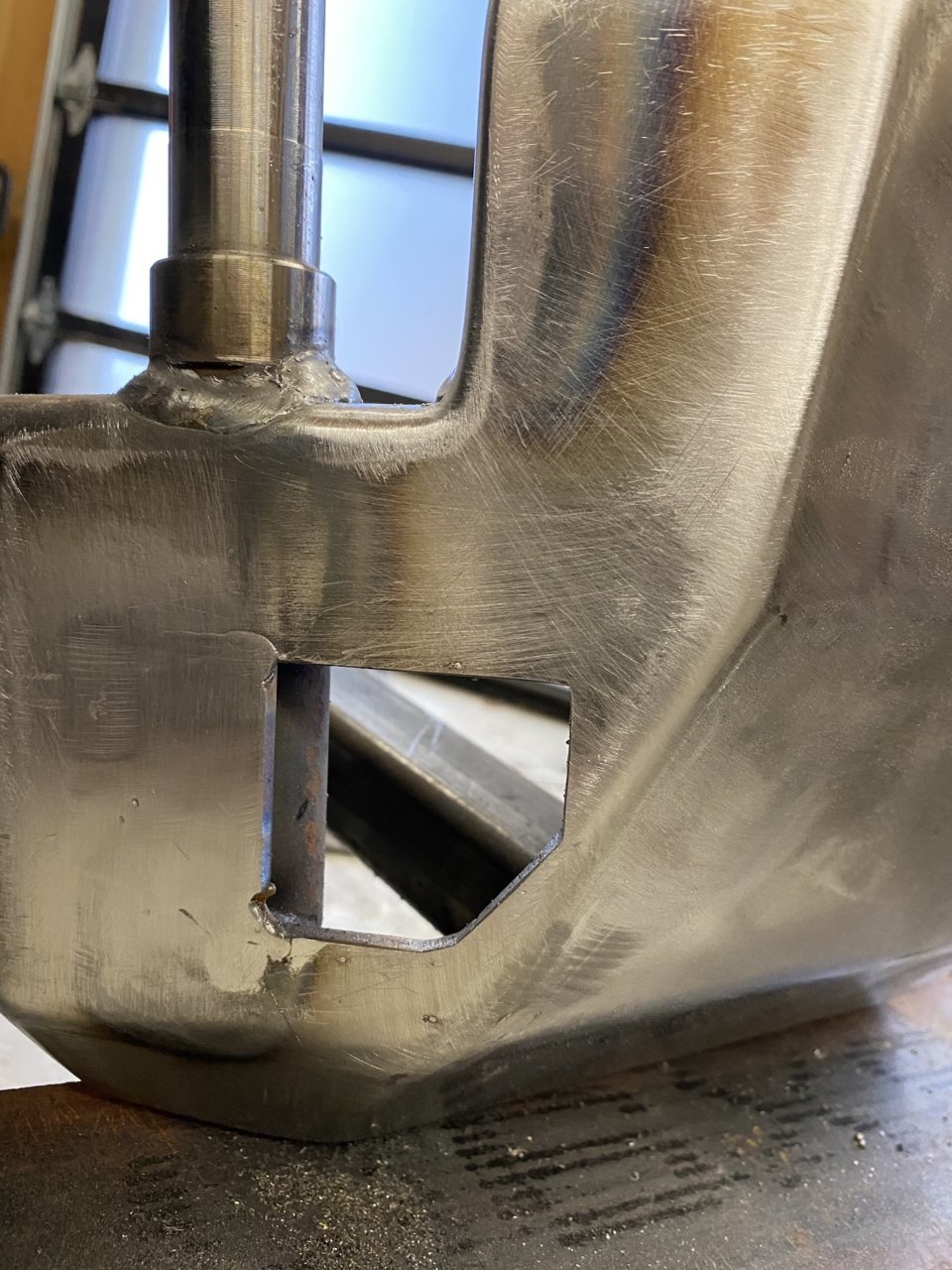

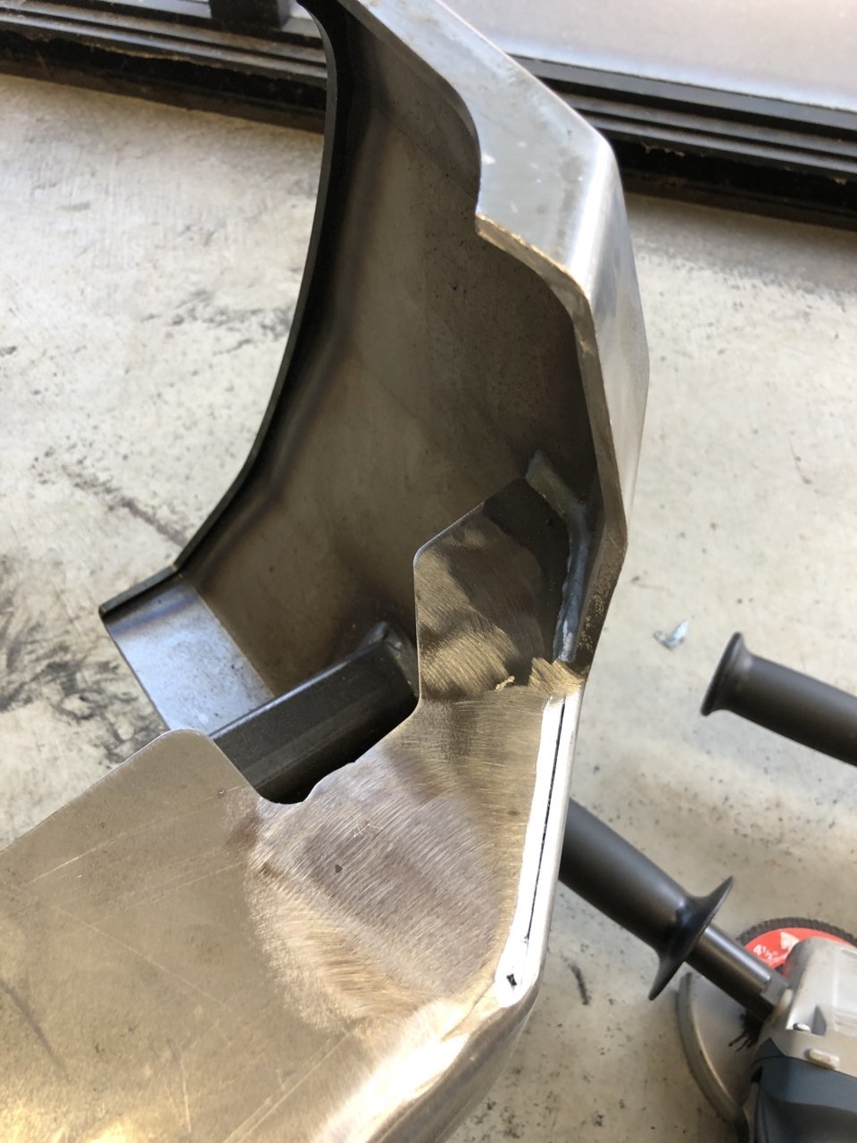

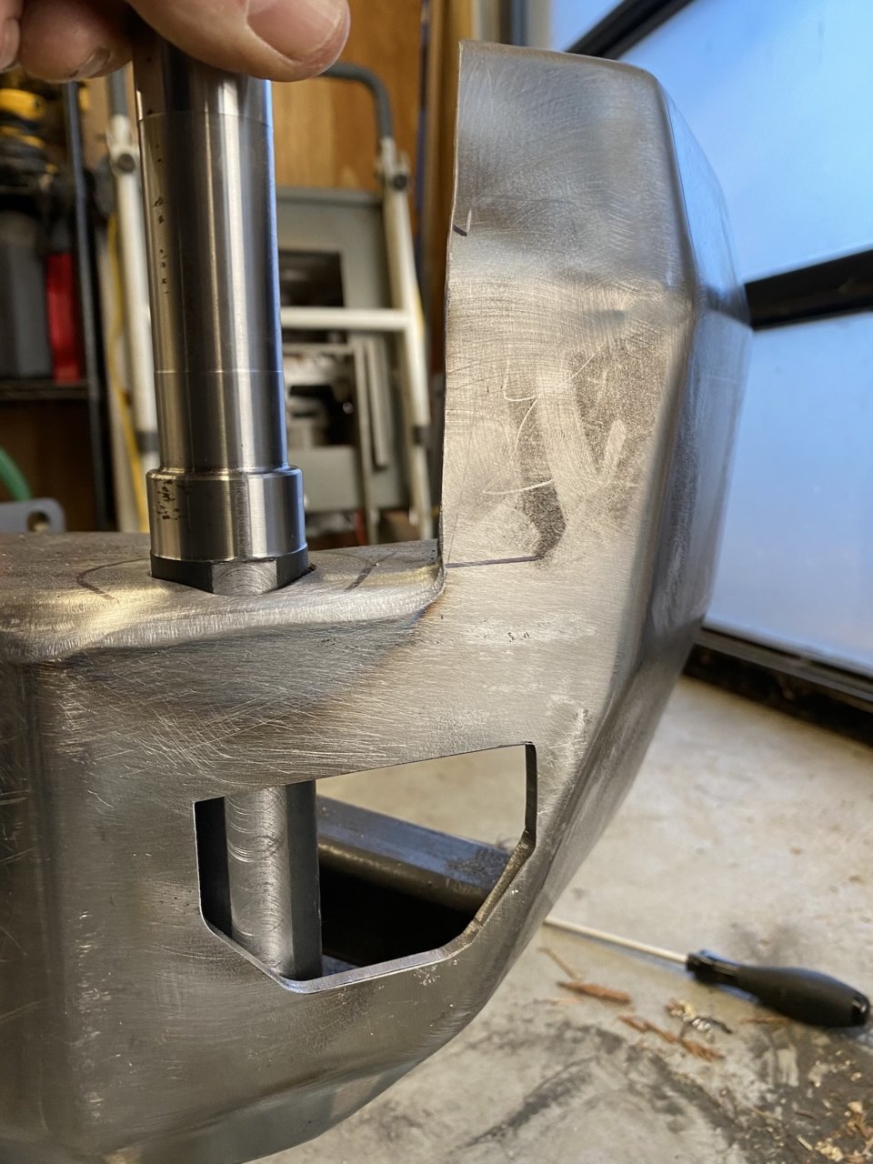

    First step is to hack in to the bumper to make room for the pivot, drill for the pivot, relocate the jack point, weld the pivot in place, and plug over the old jack point location:
    Next there was much head scratching as I tried to figure out a design for the swing out so i could accurately place holes for the swing out retainer and latch. I'll cover all that in a later post about the swing out. But, end result was a little fin for the swing-out retaining pin to drop in, and two holes for the swing out latch receiver.

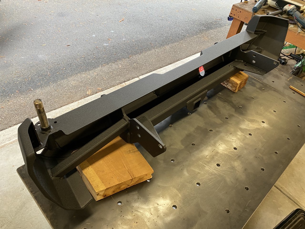

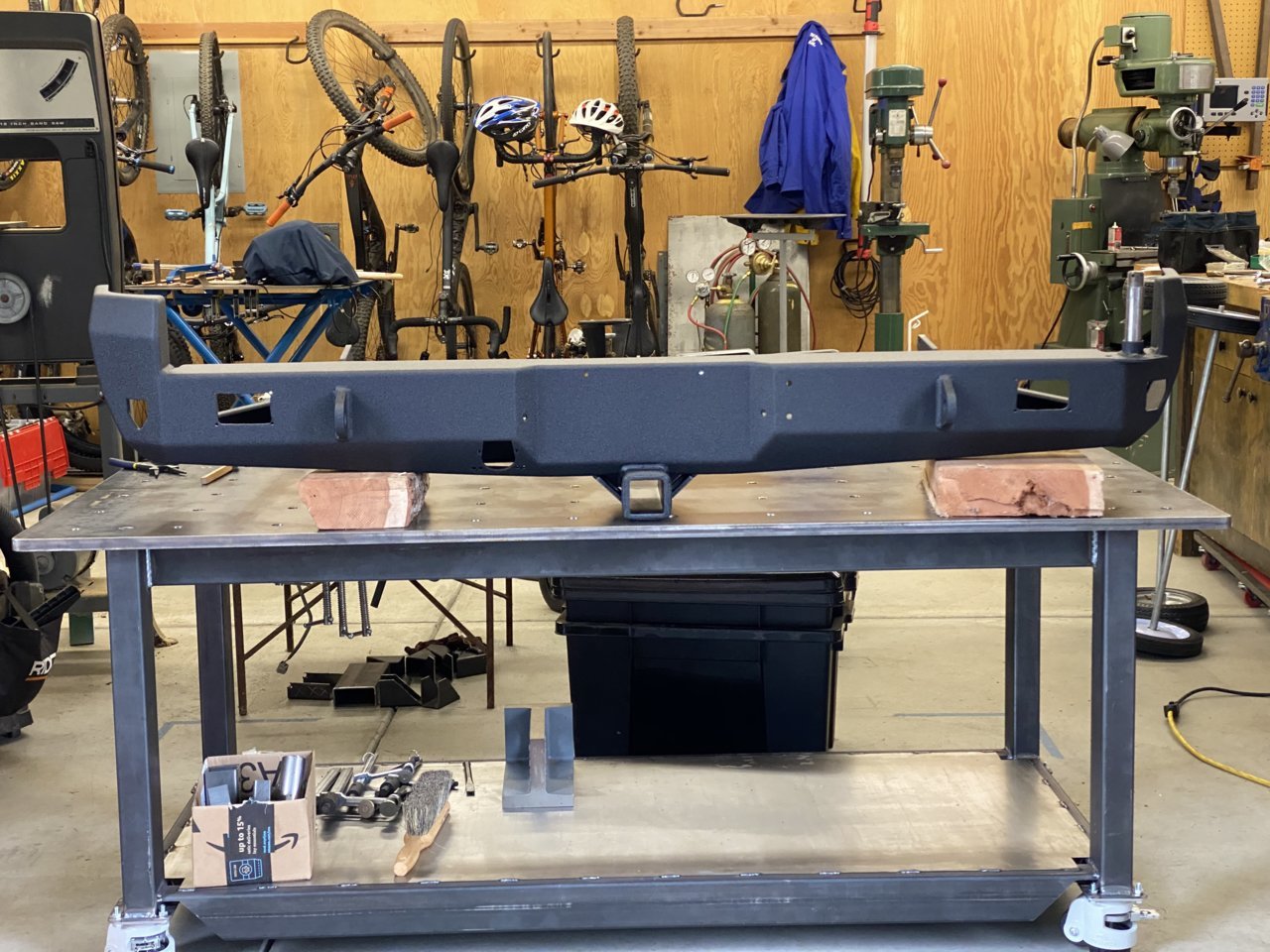

    Holes and cutouts for the reverse lights, license plate lights, and it's powder coat time!

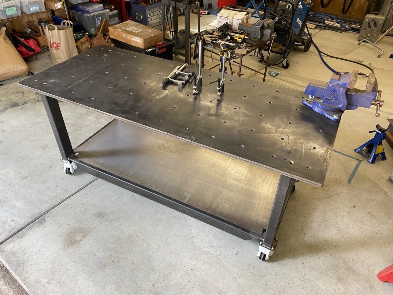

    While that was happening I made a welding table.
    Back from powder coating. Thanks Miller Manufacturing in Rohnert Park!!!

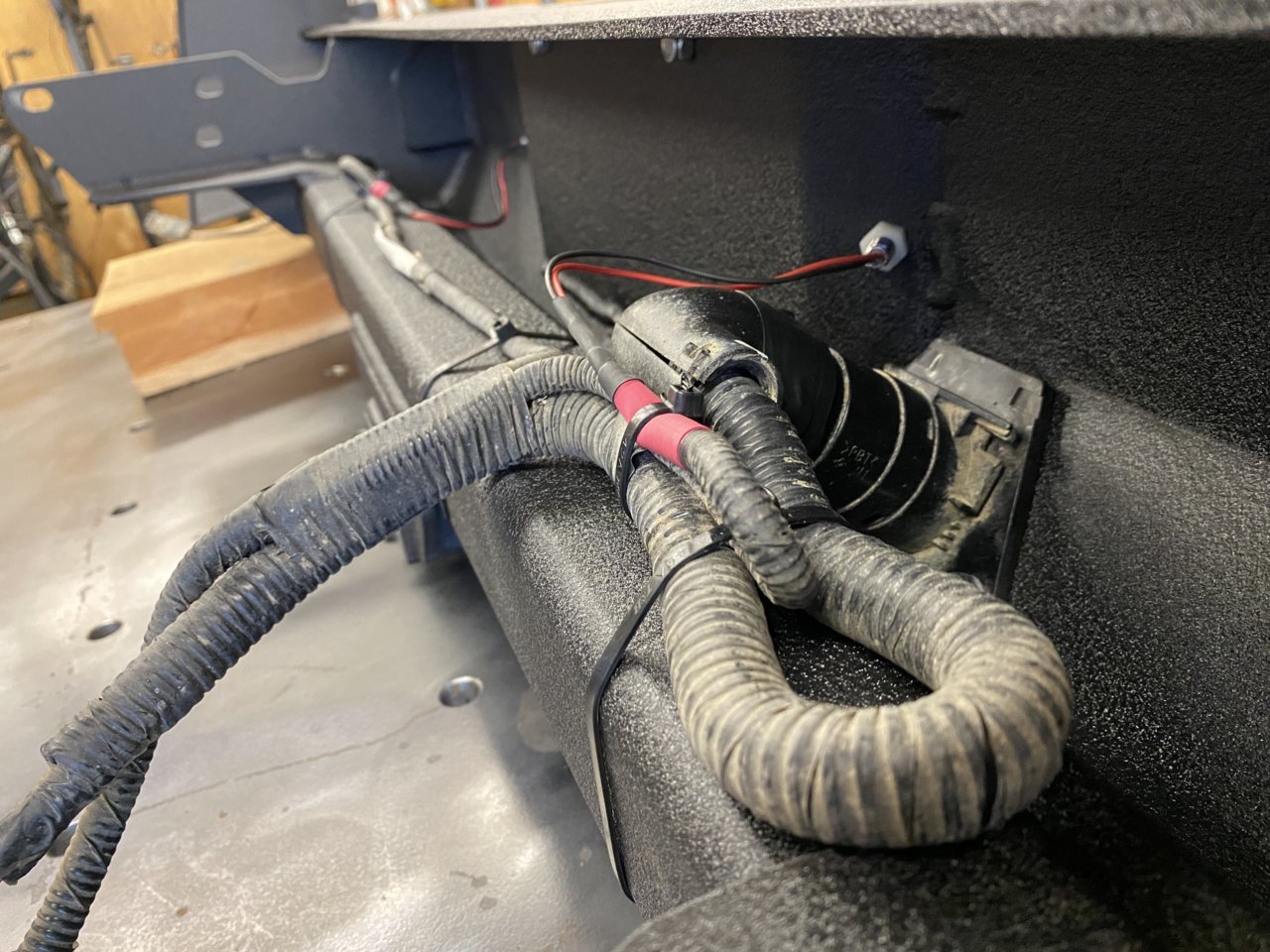

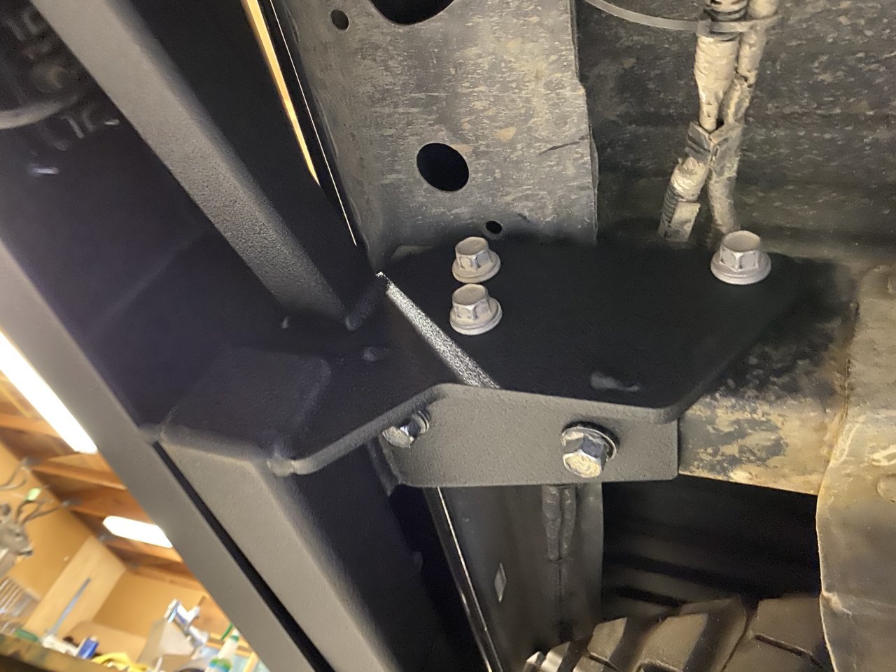

    My only complaint in this whole thing is the cutout for the tow connector was a little tight (and i stupidly didn't check it before powder coating!) so, i had to grind off a bit of the connector housing to get it in, but in it went. I do like the flush mount.

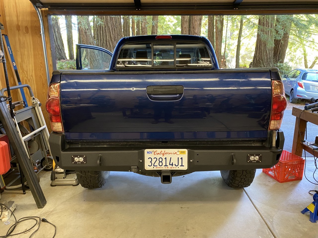

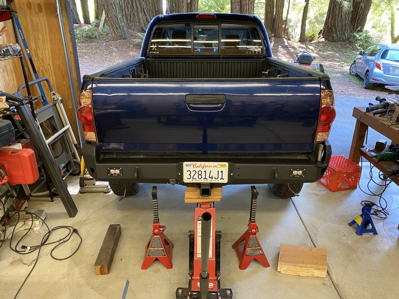

    And.... It's going on...
    So glad to have my truck whole again!
    Yes - I will be making a little cover for the bare post when the carrier isn't mounted. ;)

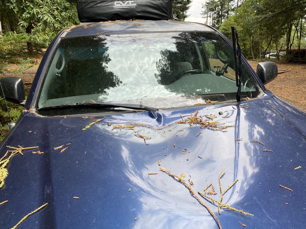

    So, this happened:
    No, not a DIY hood scoop. More like a 20' redwood tree branch playing jarts with my truck! USAA covered it though, and, since paint was being sprayed, i asked my local guy to hit the roof too. And he buffed the whole thing! It's never looked so good!
