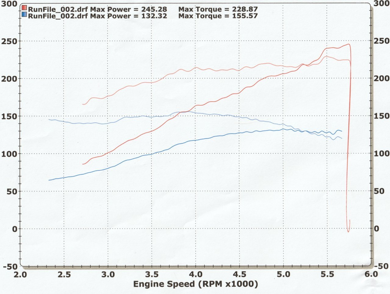

    Well they dyno'd it before for a baseline 130HP with larger than stock tires (265/75/16s vs stock 4Banger size 245/75/16s)
    After adding
    URD Mk3 Supercharger kit for 05-15 Tacoma 2.7L 2TR-FE 4 Cylinder
    URD 2TR-FE Stage 1 to Stage 2 Supercharger Upgrade
    LCE Header (a long-tube header in a short-tube package)
    Short throw shifter
    Upgraded clutch
    Magnaflow cat back
    I now have almost double the horses with 245HP. :burnrubber:

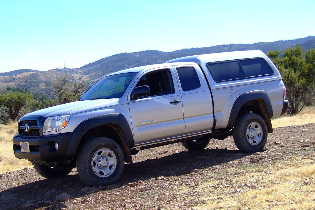

    The Truck 2011 Toyota Tacoma 4x4 Access Cab Silver State Edition
    Engine 2TRE-FE 2.7L
    Transmission 5 Speed Manual
    Wheels & Tires
    Commuters
    16" Stock styled steel with 245/75/16 Dungflop AT20s
    Wheelers
    16" 1st Gen TRD Alloys (the equivalent of 3/4" wheel spacers) with 255/85/16 BF Goodrich Mud Terrain T/A KM2

    Day one bought my Taco. You all know what a naked Taco looks like so no picture. Week two bought my shell.
    At less than 1K I got my OEM fogs (thanks Howard{hstringe})
    I wired them my way
    with no switch by wiring the switch leg of the relay to the running lights. I use them as daytime running lights. And we all know what OEM fogs look like.
    My Auto OEM Fog Light Mod
    After first trail run I trimmed the mud flaps. 4" off front and 1" off rear. They scrape a lot less now.

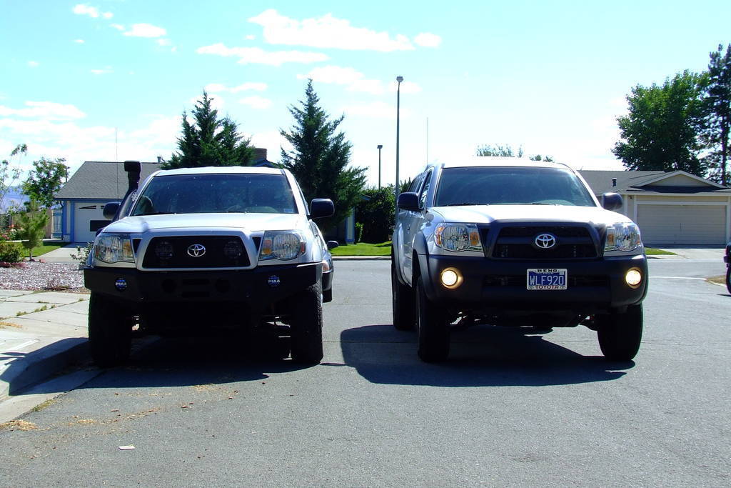

    At less than 2.5K I got my lift on. (thanks Josh {sierrahsky}) A full 3" front and rear.
    Josh and I with some help from my wife did two suspension jobs in under 4 hours. Took the suspension off his Taco and put it on mine and returned his to TRD stock. Thanks again Josh for the help and the great deal. No spacers and no Taco lean!
    Pre lift
    Post lift
    Great ride much better than stock. Feels fine at 85mph with stock UCAs (professional driver on closed course)
    Donor and recipient Tacos post surgery, both are doing fine.

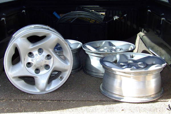

    Picked up a set of TRD Alloys for wheeling for $100 still need tires for them.
    I'll use my stock Steelies & Dungflops for commuting.

    I should get them this week or next.
  20. Jan 11, 2012 at 5:20 PM
    #20
    Yota1
    Yota1 Well-Known Member
    May 29, 2009
    #17777
    291
    Really want to see those wheels mounted. I see them on CL all the time, but not sure on bs, and look.
