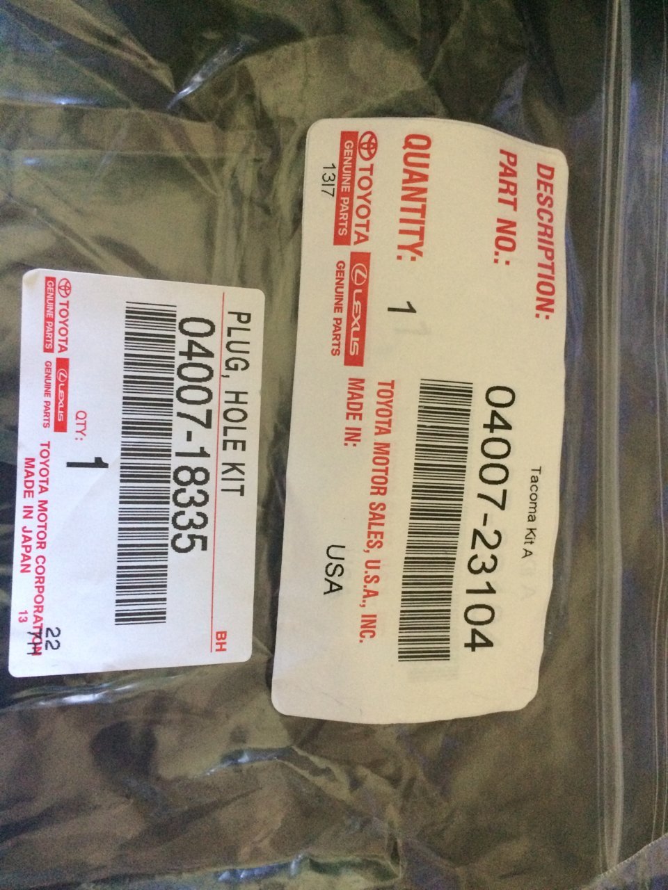

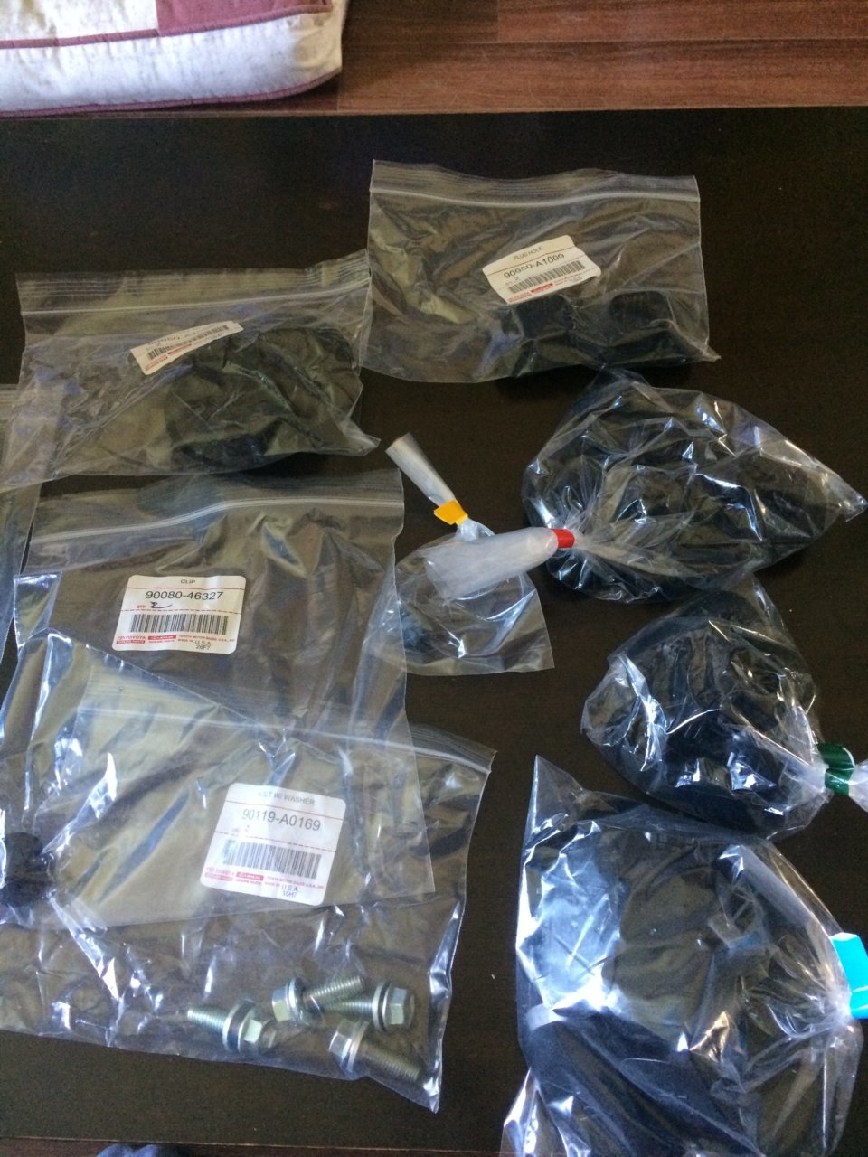

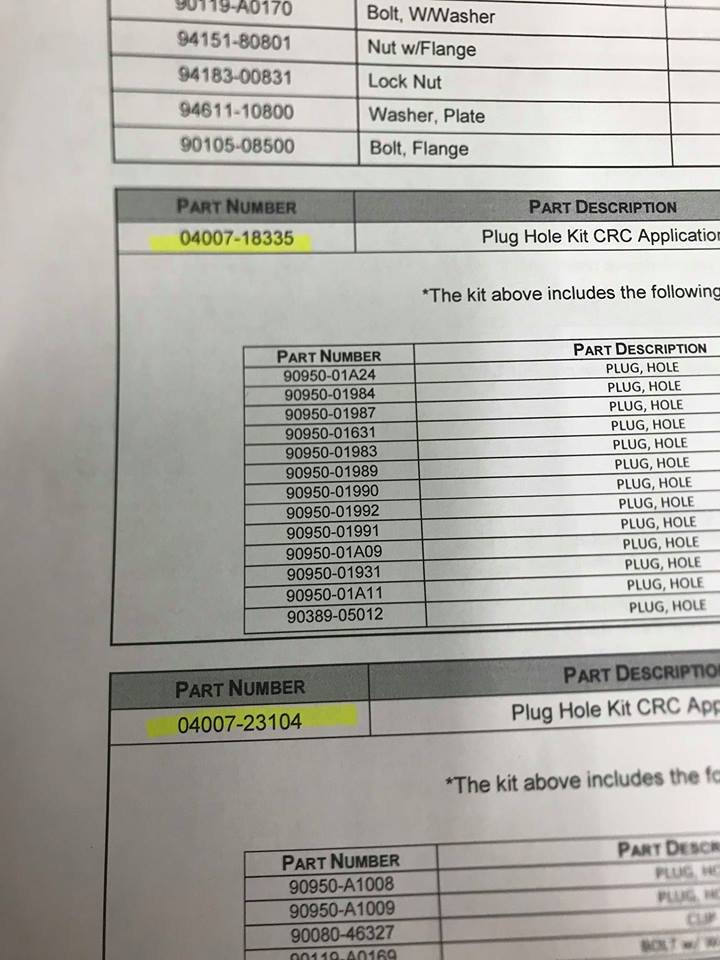

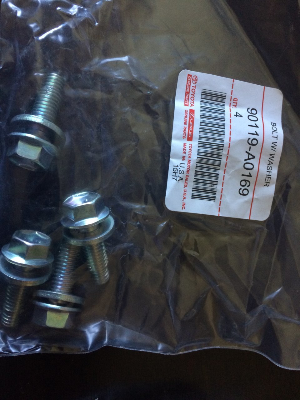

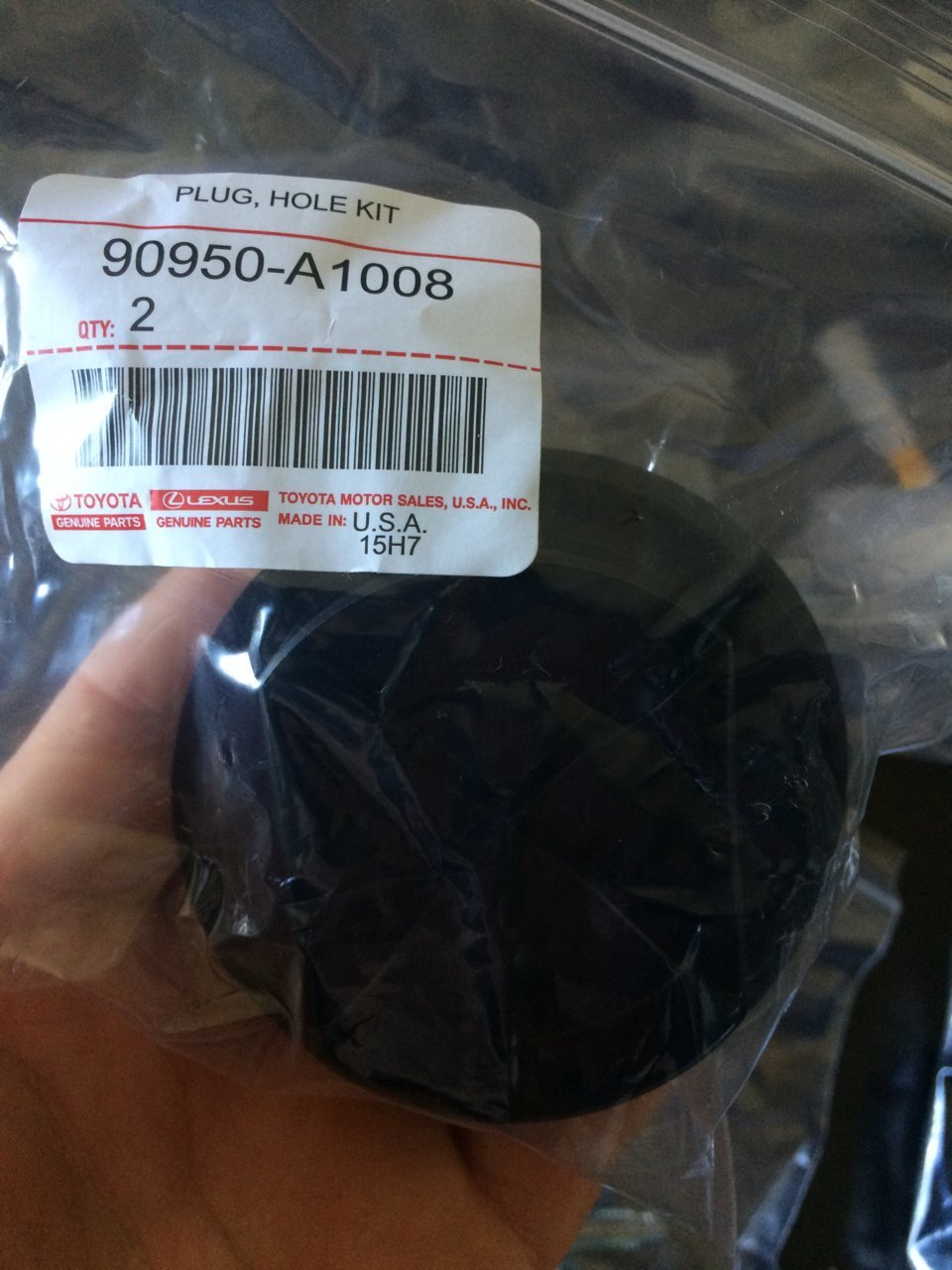

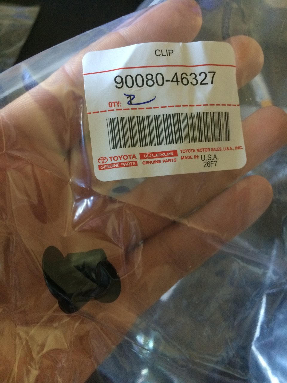

    Time to getting plugging:)
    880152B2-7AF0-4478-B41D-D9030AFE018B.jpg 354642D1-585A-4D92-AEE8-DA384B211407.jpg B4026F3F-F3D7-442E-A2E6-34AF94F6AC55.jpg 7D4BBFFD-542E-41A5-908A-8613BF5A5DF4.jpg 825A0F2A-3B4B-4853-ADD1-A4D231E2503A.jpg
    Bocsy44 and I married my tacoma like this.

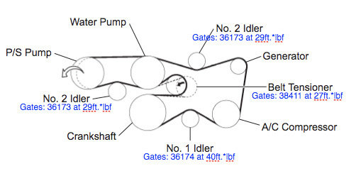

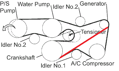

    THIS IS THE BELT I USED K070795 24MM X 2033MM
    ALMOST 3000KM LATER AND NO ISSUES
    knock on wood :)
    5917F7A8-D0DD-4395-AB68-0234871D0A7C.jpg FD6AA281-B523-486E-9BDF-0B8824C44CEC.jpg 73A3AC4B-87B7-4329-8E63-40A973C93F2E.gif
    Used shorter belt removed AC compressor and lower idler
    I am told I will have to do some wiring to make the defrost work

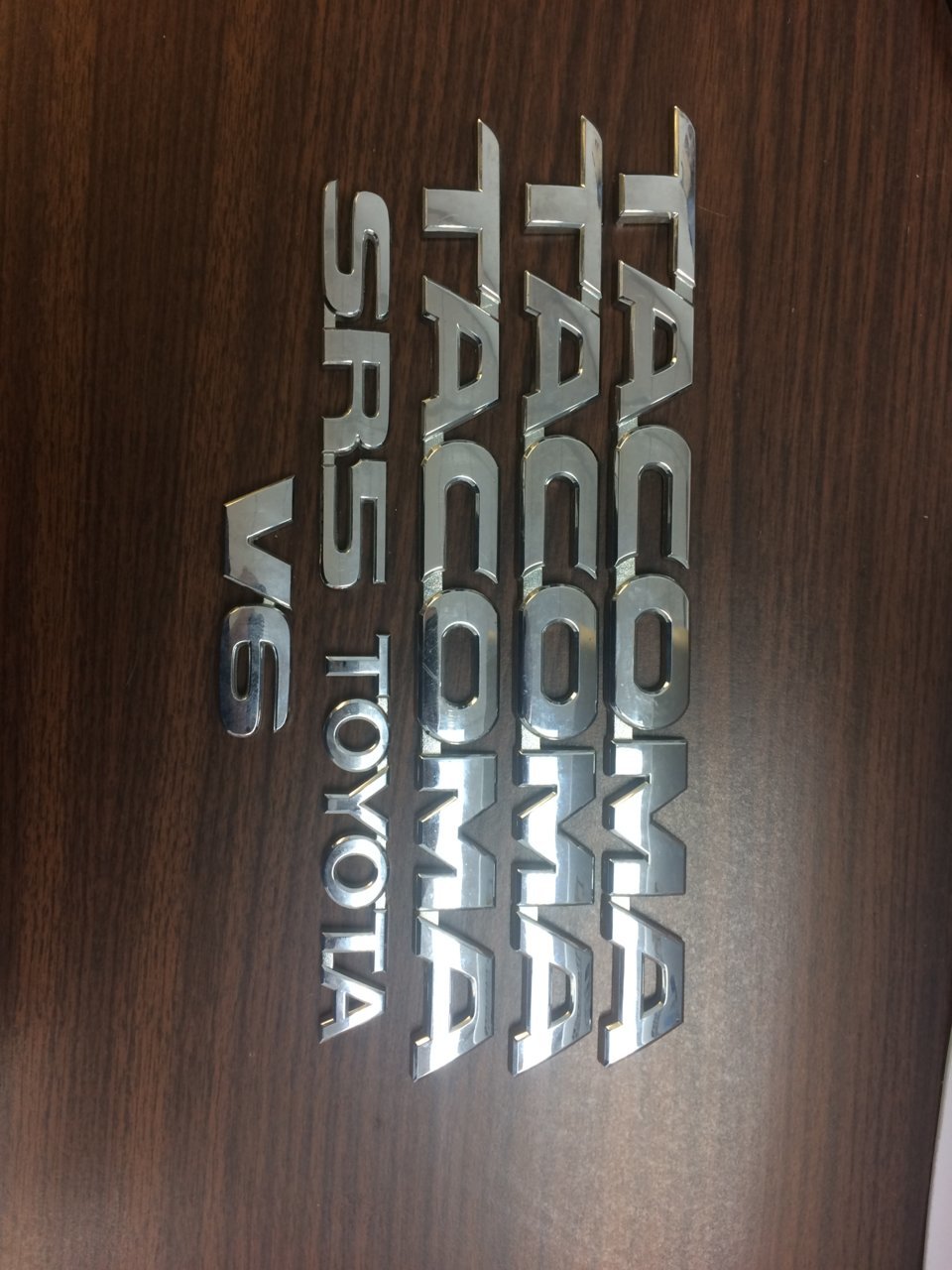

    Original owner called me today to tell me he found these :) FE6C9B40-B87B-4DA4-A9A7-6A0DE093B54C.jpg
