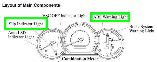

    I haven't seen those lights on either when my shit acts up but it only started after my lift so im assuming that's what the problem is. its only on this certain road on the way to my trailer, there are two sharp bends in the road and when im going faster then like 50 around the corner, but front D side abs turns on but no lights pop up haha im not too worried about it since it is only on those corners, but im going to recalibrate to see if it helps. im not to sure how to determine if it has it or not but I know I have it. there is a thread on here somewhere that outlines all the different systems

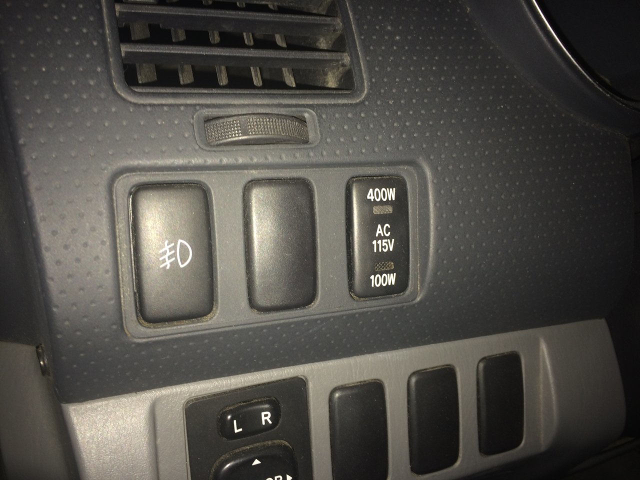

    No one can control my traction

    :rofl: well I would say no to VSC hahaha ur lucky. its a love/hate relationship between me and VSC lol I will be adding a ABS kill switch

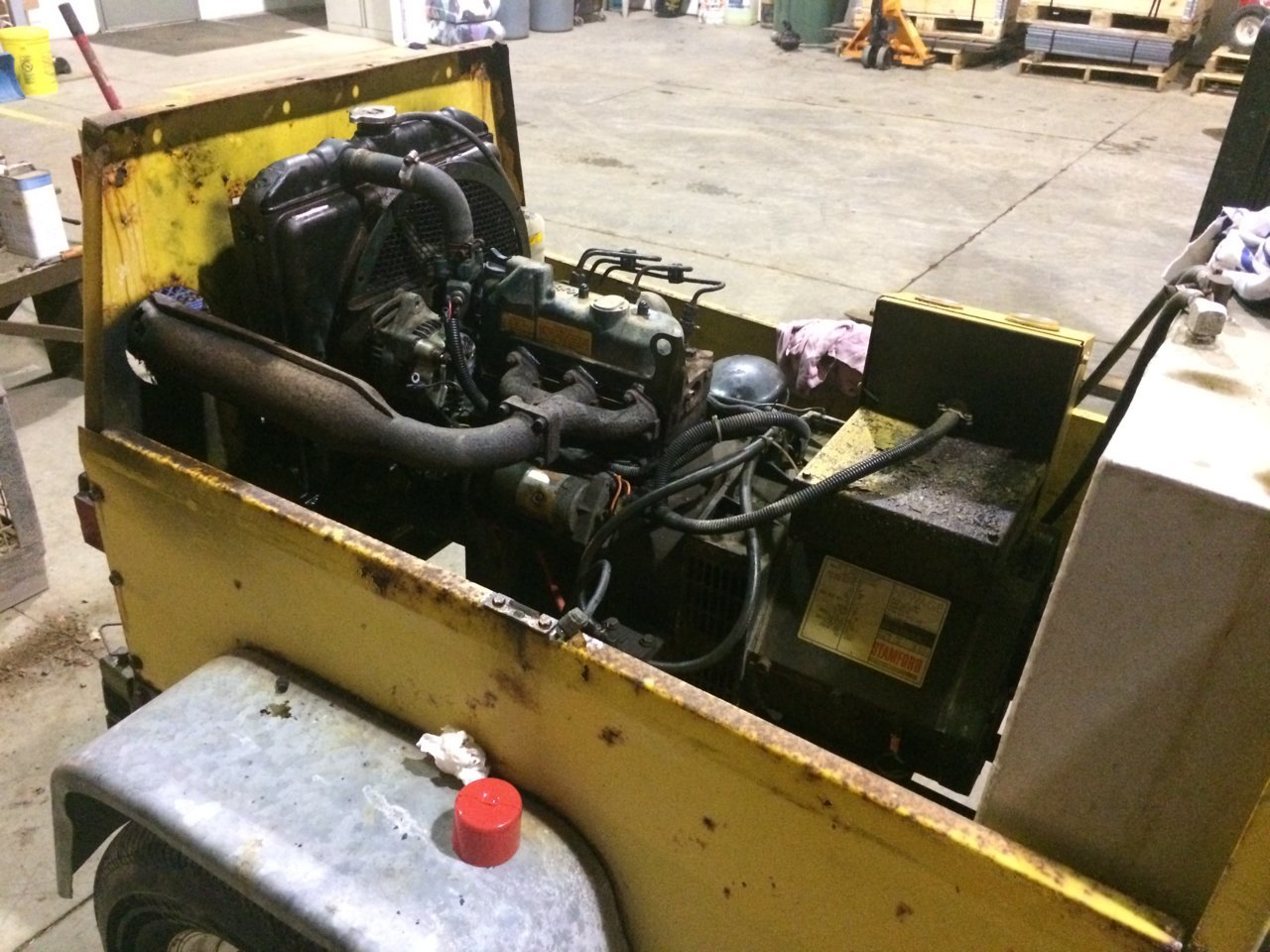

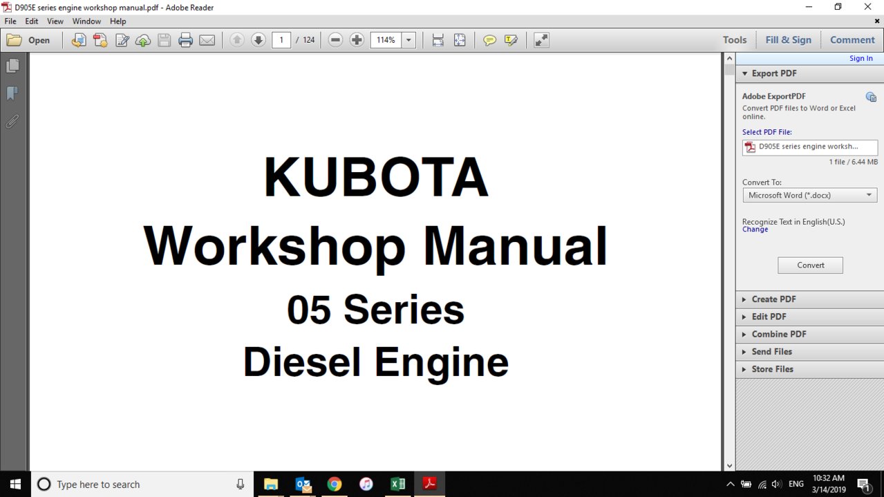

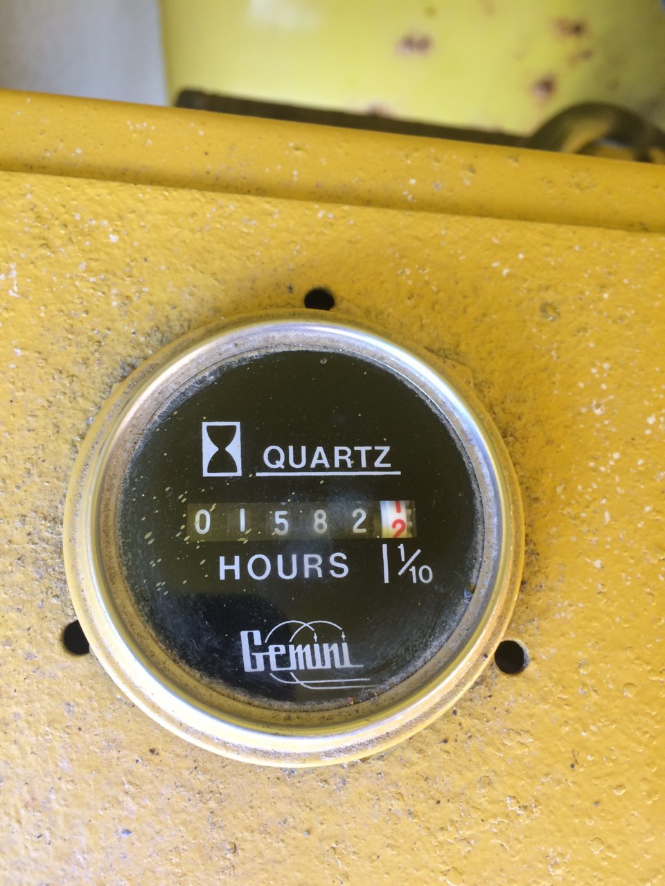

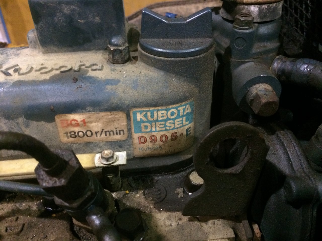

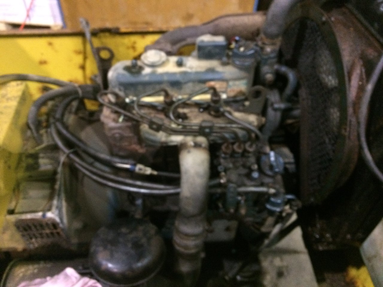

    Ok OK the suspense is killing me i need to share it with the two people who read this foolishness
    CC95D087-89B8-4647-84D4-82582E1D624C.jpg 6897CC80-7E68-44B1-B775-755F662A3D40.jpg 510AE1CA-87CB-4172-BFA7-3D019155CCBB.jpg 08EB4868-E80C-4404-AB84-614A3544396D.jpg 5CBA4CC0-E9EB-41E3-8278-E20DC4220BFD.jpg

    It was a Diesel lighting plant, that was turned into a generator that probably ran for 100H and started to smoke real bad. The guys onsite turned it off and said there was no oil in it. It was shipped back to the shop and it did have oil in it not the correct amount, it "looks" like the PCV vent came off the top pan and might of been putting oil out on the exhaust. Turned it over and it has low compression, the head came off and one of the cylinders has a few scuffs in it. So work said write it off :) I get to keep everything except the trailer ..... If i can get it working what a backup generator for the house or the cabin.

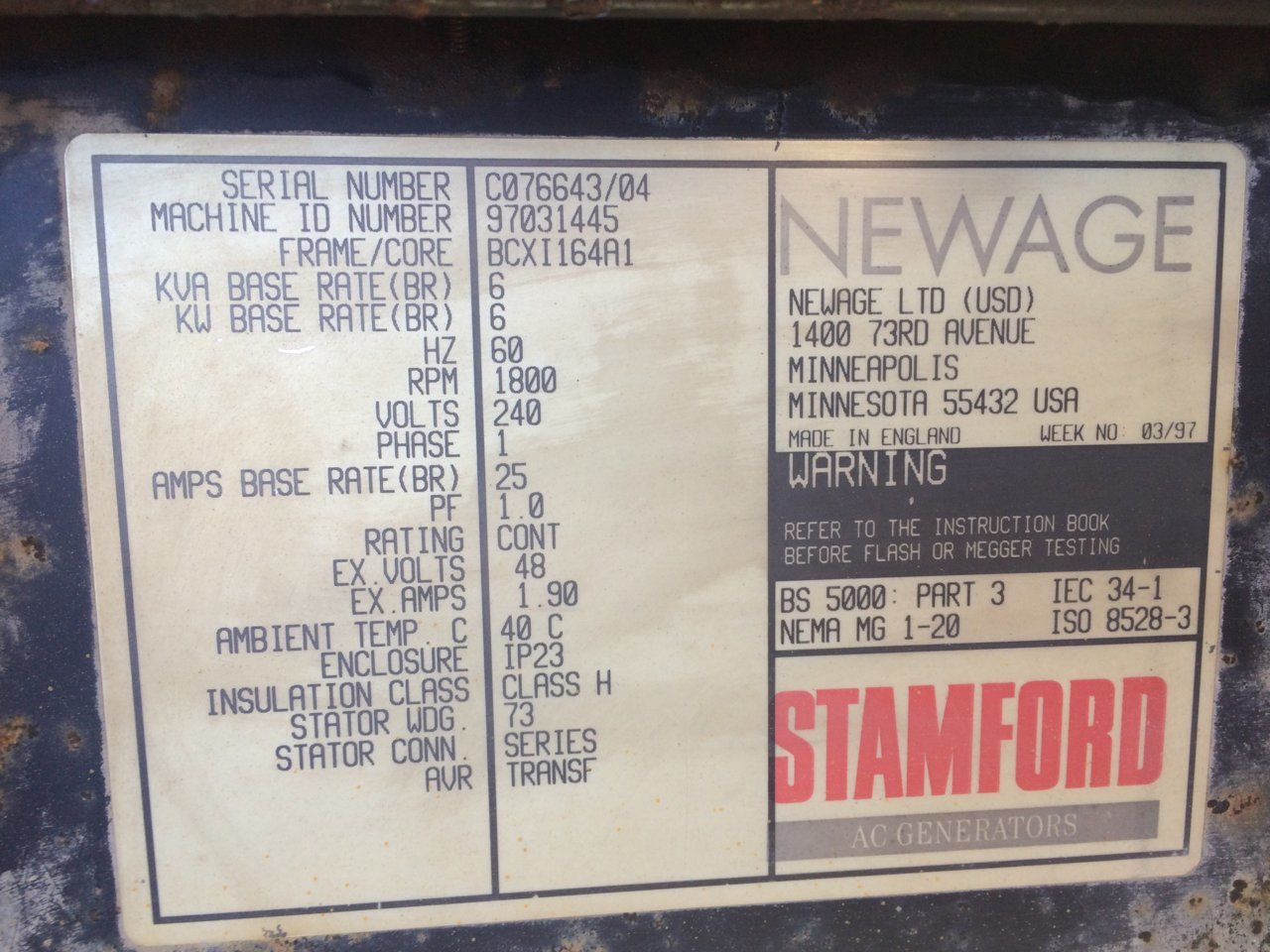

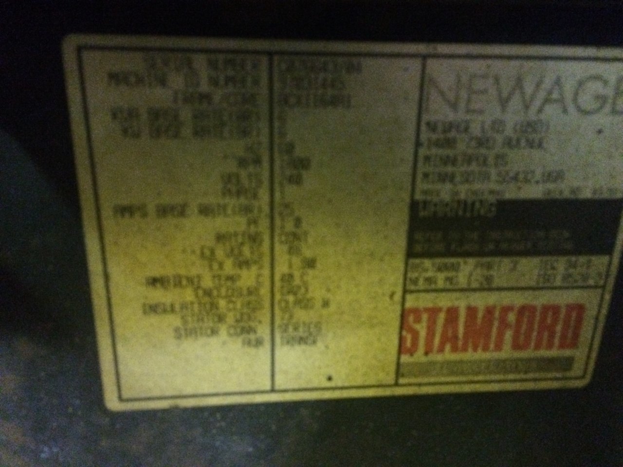

    What’s the output of that thing?
