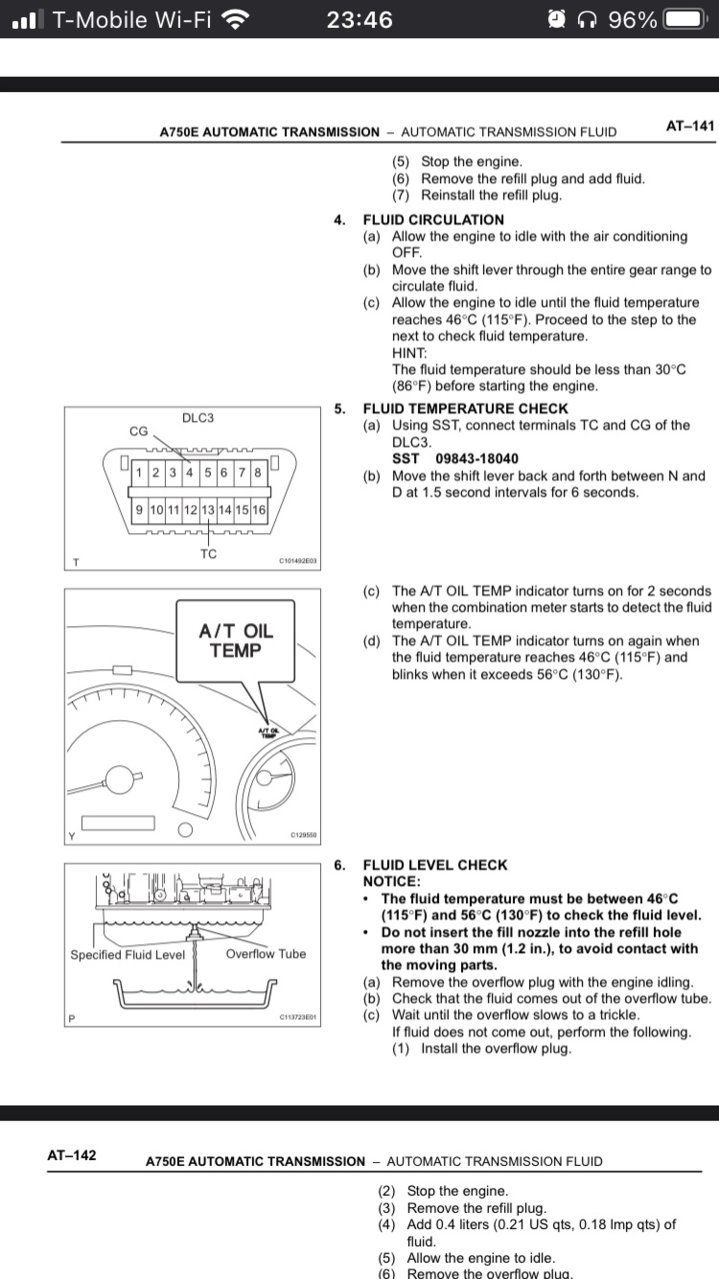

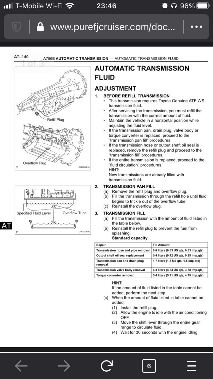

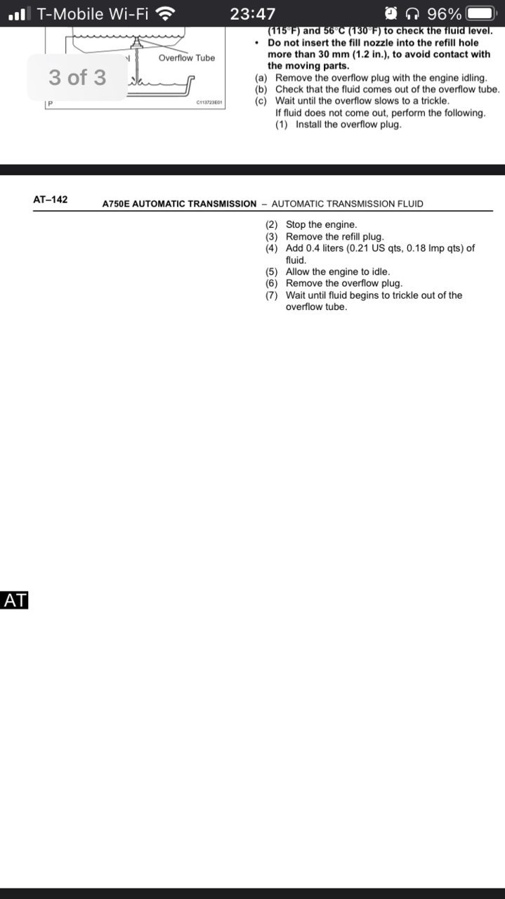

    ACCE880C-5B88-4AF7-A21F-2433F8623887.jpg C2AB1033-A621-45F2-9F8C-66D5151CDC53.jpg 1A5ACB9B-8544-4FD7-9A52-54633A8F3363.jpg In case this is needed.

    Dm93 and Ricardo13x like this.

    Ricardo13x

    I can't help you there as I've never used the pin-wire procedure. I used to use an IR gun and I know have an UltraGauge to monitor AT temps. But the IR gun is accurate enough. I've compared both and my IR gun is within 3 degrees of my UltraGauge readings. A member here had originally posted his IR gun temp readings to his TechStream software and had similar results.
