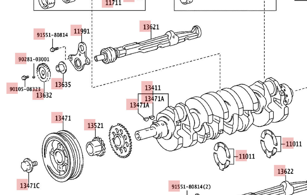

    38C97C67-B64E-42F0-BDCE-14129613D8E5.jpg Here is a parts diagram

    Maybe @Torspd can let us know if the pulley is aligned off the crank gear or the crank key?
    I haven’t done one myself. If it aligns of the gear, I don’t think you’d be able to even start it on unless you have it aligned incorrectly?

    The pulley is aligned off of the key.
