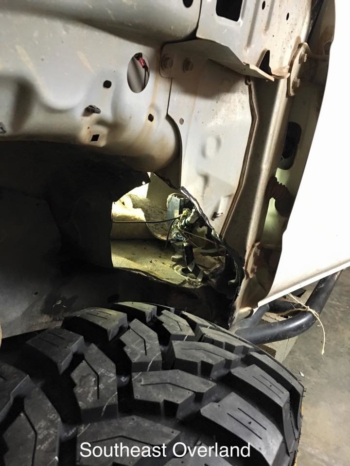

    Only pic I have of this truck during the process
    • 35/12.50R16 Maxxis Trepadors
    • Used 18 Ga. steel to patch hole
    • 4 Inch BS Wheels
    • 1.25" Spacer
    • Took 1.5 inches off of the front fender all the way around.
    Thanks
    Jeff
    rngr[OP] likes this.

    You clear the frame completely? My current wheels are 4.0BS. I want as little of a spacer as possible. Hoping a 1.25 will do it.

    I cycled it with no coilover in at full bump and went lock to lock and it never touched the frame, I did have to lose a bunch of metal on both the body mounts though.
