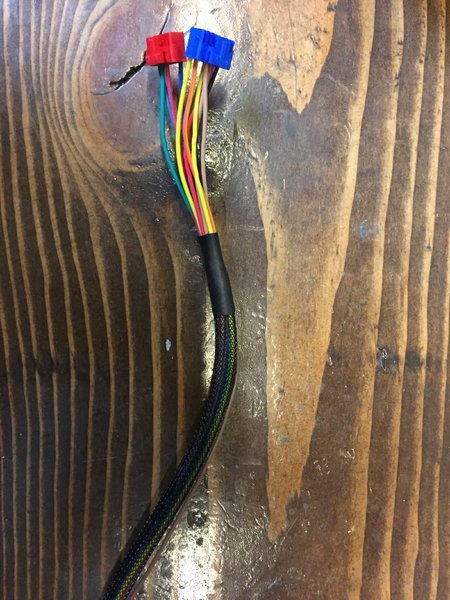

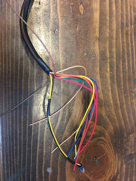

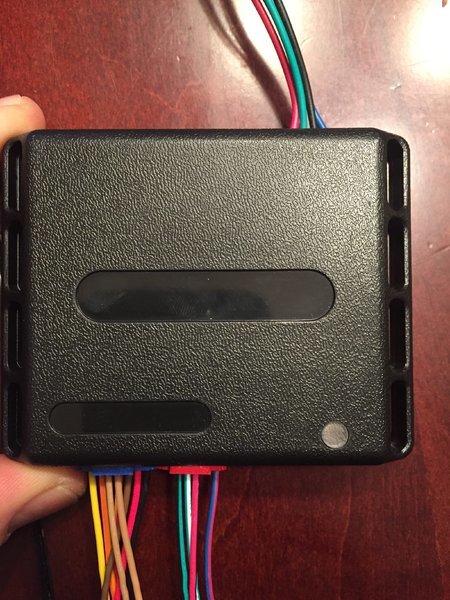

    As some of you know recently I developed a DIY style remote start kit for our 3rd generation tacomas that are equipped with the push to start feature.myself and a vendor here KB Voodoo have teamed up to offer the best kit possible at a affordable price. In the previous thread the information on the system was scattered all over making it tough to understand and sometimes hard to follow along. For that reason I'd like to take the time to introduce myself and go over the system so it's easy to understand it's features, labor involved, and its draw backs.
    Myself:
    I have been in the automotive industry for a total of 11 years. Six of those years I worked as a Toyota tech doing maintenance work and all of that dealerships TRD work which ranged from exhaust tips to superchargers. After that I spent 5 years working at a custom shop installing anything and everything car related. This is where my knowledge and background in remote starts all came from. I am a advanced MECP installer and have other certs in electronics. I bought my truck in September and joined this forum the next day. It's helped me a lot so that's what made me do this whole thing.
    The system:
    The remote start system we are using is a DEI product. This is the leader in remote start / immobilizer bypasses. They are the dealers first choice as well as mine.
    The system requires the you to tap a total of 11 wires for the tacomas equipped with auto lights and a total of 9 for those of you (like myself) who don't. It can be installed in a hour and a half or less. The system uses the factory remote to start and stop the vehicle by continuously hitting the lock button 3 times. So no extra remotes on your key chain! The price for the kit is $129.99 and is only offered by KB Voodoo fabrications. The kit can be found here
    http://www.kbvoodoo.com/shop/remote-start-kit-for-toyota-tacoma-2016-2017-preorder
    The features:
    • 20 minute run time
    • Taps only 9 to 11 wires
    • Uses factory remote to start the vehicle
    • Uses factory remote to stop the vehicle
    • Can have a range extender added along with a 1 mile range remote
    • Can have a smart start unit added to use your phone start the vehicle anywhere
    • Runs your heat or a/c setting while running
    • Bypasses your factory locks while in use allowing your remote to remain working while running along with your door handle sensor while the vehicle is running.
    • Turns in the parking lights letting you visually know the vehicle received the start command and is running.
    What's involved:
    Interior panel removal
    The installation requires the removal of 4 interior pieces. These pieces include the door runner, kick plate, knee pad, and the bottom of the steering column cover. Once those are out of the way, it's nice and open to preform your install.
    Wiring:
    I have installed this in my vehicle as well as 5 other tacomas in the area. Hours or wire testing have gone into this to create the directions and find the easiest locations of the wires to be tapped. My directions are extremely detailed. They have all of the plug locations, wire pin locations, wire colors, and even photos to give you the confidence to get the install done.
    Reassemble !
    The whole install takes 1 to 1 1/2 hours total from start to finish.
    The draw backs:
    Due to pre-set Toyota settings the vehicle will die when any door is open. This requires you to restart the vehicle once inside. This can not be changed no matter what. It stinks but at least your truck is warm!
    What's in the box:
    • Remote start unit
    • Wire harness that is loomed to look factory
    • 3m quick connectors
    • Grounding terminal with self taping screw
    • Zip ties
    • Printed detailed instructions which include photos
    • KB Voodoo decals
    We have a operational video here
    https://m.youtube.com/watch?v=PVt3OU66fEk
    What's involved video here
    https://m.youtube.com/watch?v=8nWCX6QY1Ms
    And a couple reviews here
    https://www.tacomaworld.com/threads/detailed-review-nickjs-kbvoodoos-remote-start-kit.465105/
    https://www.tacomaworld.com/threads/kb-voodoo-remote-start-review.464480/
    I hope this new thread makes it easier for people to understand and see what the kit offers and what's involved. I hope I have helped you guys save a couple hundred dollars as well because that was my whole goal. As always if you have any questions about anything ask and I'll try to respond in a timely manner. Thanks guys!

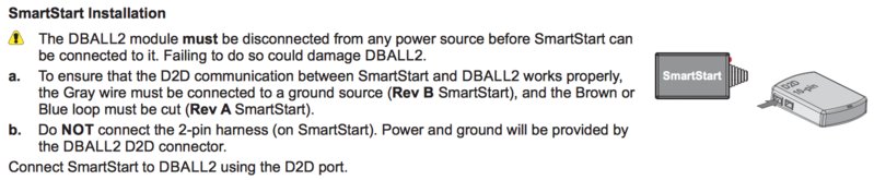

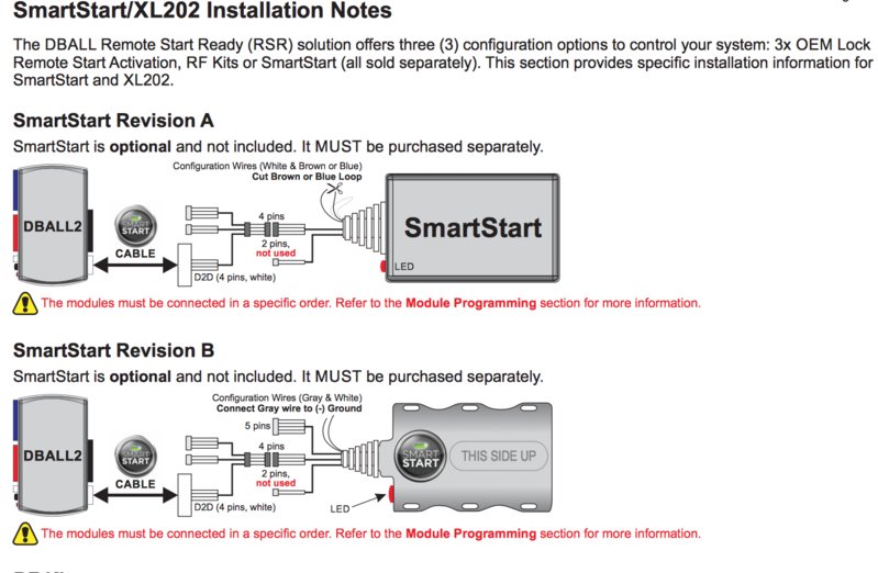

    I just ordered my kit from KB Voodoo. Do you have any instructions for hooking up the smart start? I ordered that as well and want to install at the same time.

    Oh man your gonna love the smart start.
    Here are the instructions. The Smart Start comes with directions as well on how to sync everything and get it going.
