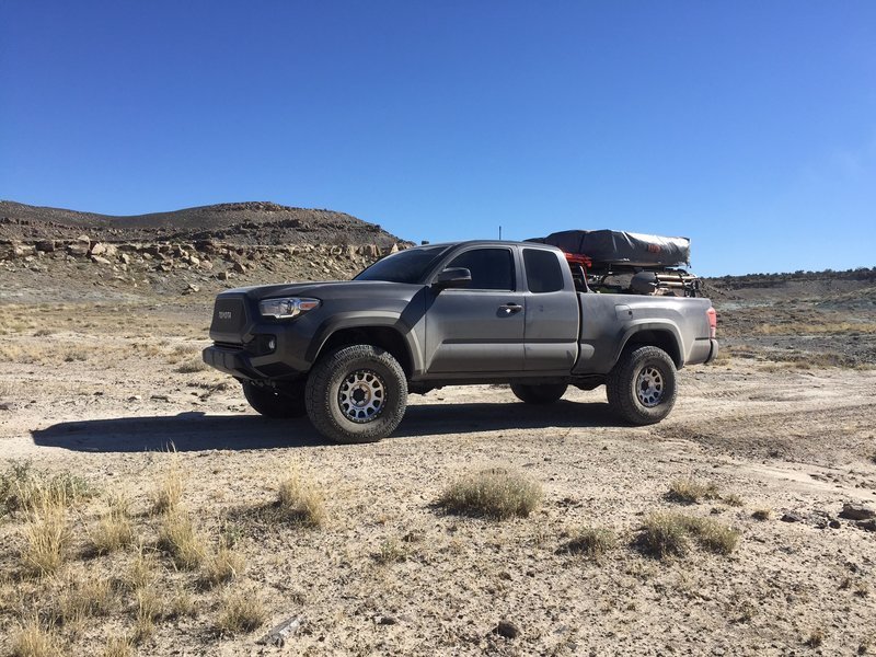

    Depends on the bumper. 90yota didn't trim his. I have 37's now and mine don't rub on the bumper.

    That was a long travel kit and 35's.
    Honestly I'd just do a king or icon 2.5" kit and 285's. That's all you really need. Looks good too.
    Outside of looks sometimes I wish I still had that setup.

    Most people here will say it's impossible to run 35's and a lift doesn't allow you to fit bigger tires.
    I can tell you from experience I was able to fit 35's with a 2.5" lift by just doing a can mount chop. Fender/flare trim. And hammering the pinch weld.
    I also had removed my wheel well liners so I can comment on those.
    Mine didn't really rub. I think once or twice they hit th top of the wheel well. But you can just adjust bumpstops for that. Oh the horror. :rofl:

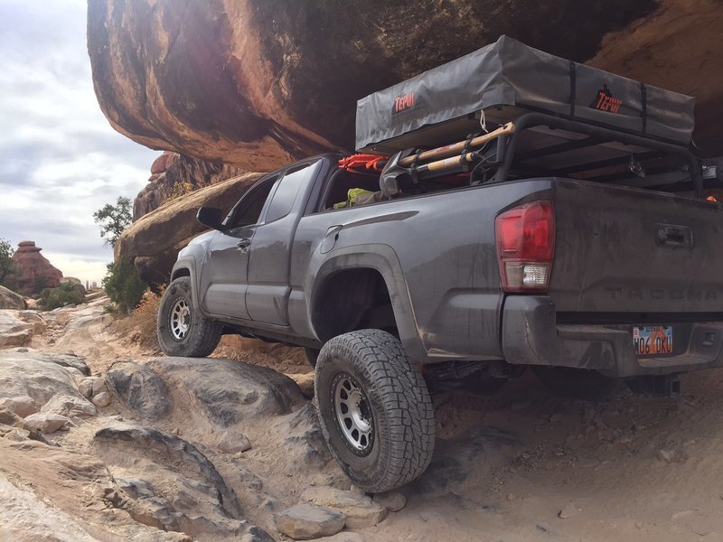

    Imposter
    Zero lift. :rofl:
    Mine is at 2.5ish of lift. To get mine to not rub on road I have my cab mount flush to bushing and soon to be flush to the bushing on the outer part. Then they'll rub on the body. I'm going to try and hammer it in. But might have to tub it. I think my caster is over 5.
    That's just for street driving.
