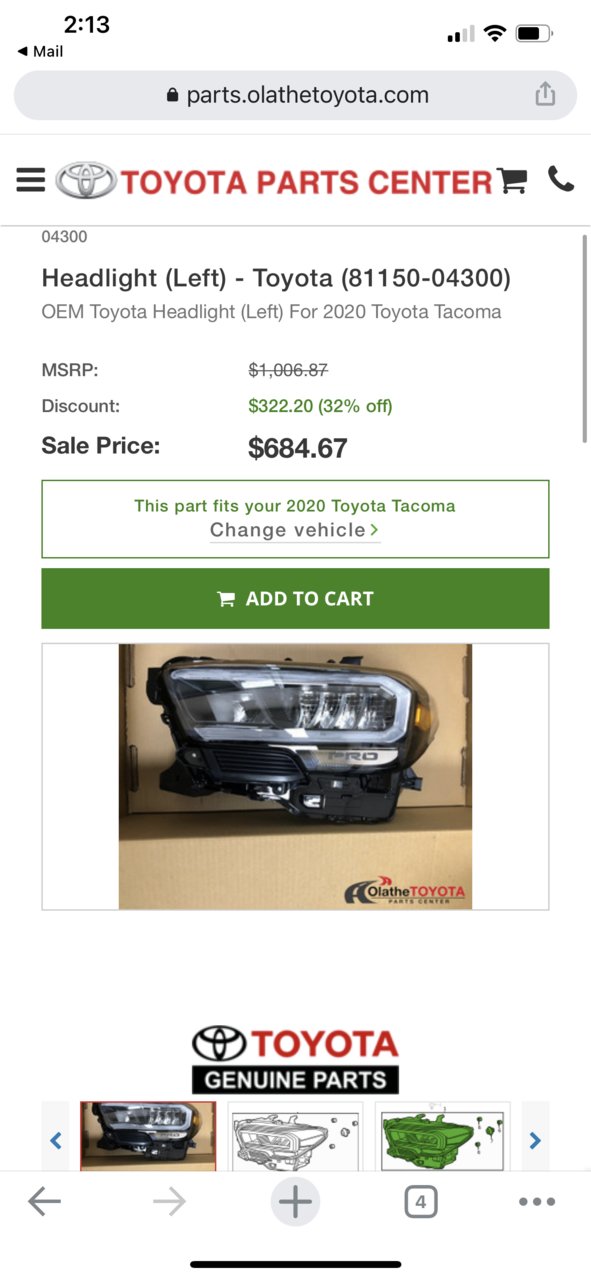

    These ones correct? The TRD pro with sequential turn signal. Will they be able to be used with my sr5 snd do i need a special wire harness? Are these the best OEM option?
    thinking about ordering
    thanks for your help

    @daveeasa sells harnesses which will be required for the OEM LED swap, but I’m not certain on SR5 compatibility. I seem to recall the SR5 had some differences.

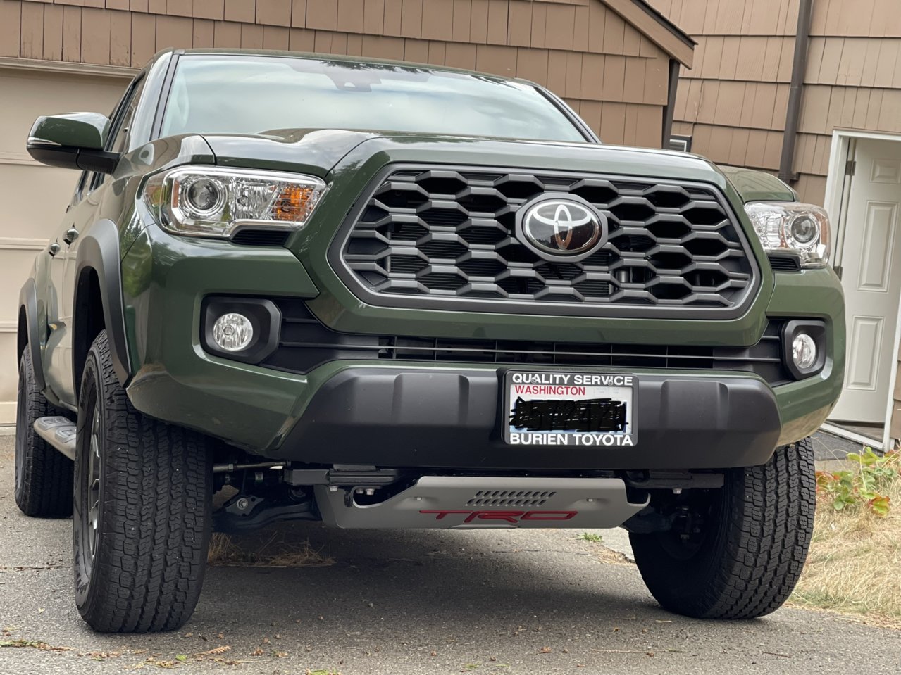

    I thought the trail edition was a TRD? Post a photo of the headlights you have right now, if they have an L shaped LED DRL then you have "TRD" headlights and my TRD conversion harness will work, or you have several alternative options listed in the DIY thread. If they are SR/SR5 headlights (perhaps you are talking about a different vehicle than the one in your profile) then you would need Johnny's secret sauce harness for the conversion (more expensive) because he de-multiplexes DRL and Turn from a single source as the ECU DRL capability is not directly accessible on SR/SR5 (at least we haven't managed to enable and capture it yet).

    Not sure i just posted a picture of my headlights they arent LEDs they are halogen but maybe you will be able to tell by looking at them. I believe the trail is on the sr5 trim but as for the headlights idk

    Yeah, that sure does look like the SR headlight to me, though I'm no expert. @Puppypunter can confirm and then his thread would have the goods you seek.

    It would appear that headlight-wise you are in the SR5 world. Good for me to learn. I just thought trail edition was so cool it'd have the TRD goodies.
