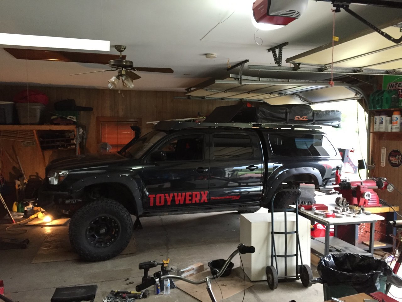

    If your rig still fits thru the door I don't mind at all. We can deflate your tires if need be and then reinflate them with your new OBAS:D.IMG_0560.jpg

    It’s actually lower with the flippac than it was in that pic. ;)

    Alrighty then, let me know when your ready.:thumbsup:
