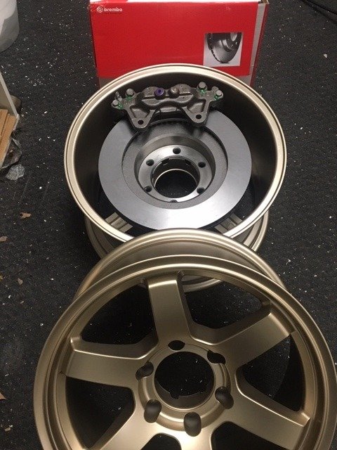

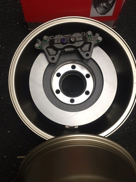

    I just picked up new MK-6 wheels 17x9s, Toyo 285x75-17 and GX470 rotors and calipers. Here's some photos !!!! Calipers fit fine....

    I notice the upgrade in braking power, plus no more warped rotors, which is the main reason I upgraded. Worth it if you plan to replace your front brakes in my opinion. I’m also lifted so any increase in braking is worth it for me lol
