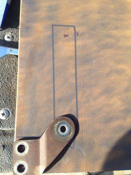

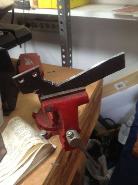

    did the BPV.
    all done, adjusted for about2 3/4 lift. and i still have room to go up.

    notice any difference?
  10. Jan 5, 2013 at 11:52 PM
    95 taco
    95 taco [OP] Battle Born
    May 3, 2012
    #78175
    17,535
    2003 4x4 TRD SR5 auto
    OME 883 front, OMD 3.5" rear, Relentless front bumper, smittybilt 9.5K winch
    yep, in the dirt if i brake hard the front will lock up now, before it didn't.

    the front?? did you get new brakes or something? proporting valve only affects the rear brakes

    i think how i adjusted it it's not giving enough braking force to the rear making the front brakes to much for the grip in dirt.
    it probably doesn't help that the last owner pulled the ABS fuse.

    with the bracket the rear brakes should work better. i think you may have gone up too high for the amount of rear lift though only looks like 1.5. and i dont think your truck had abs. mines a 98 and doesnt have it

    On the BPV, the higher up the rod is set, the braking power to the rear will be increased which is good. I cut mine off and zip tied it up as if my truck was under a full bed load.

    i still need to fiddle with that but i haven't driven my truck enough to figure out where i need to adjust it.
