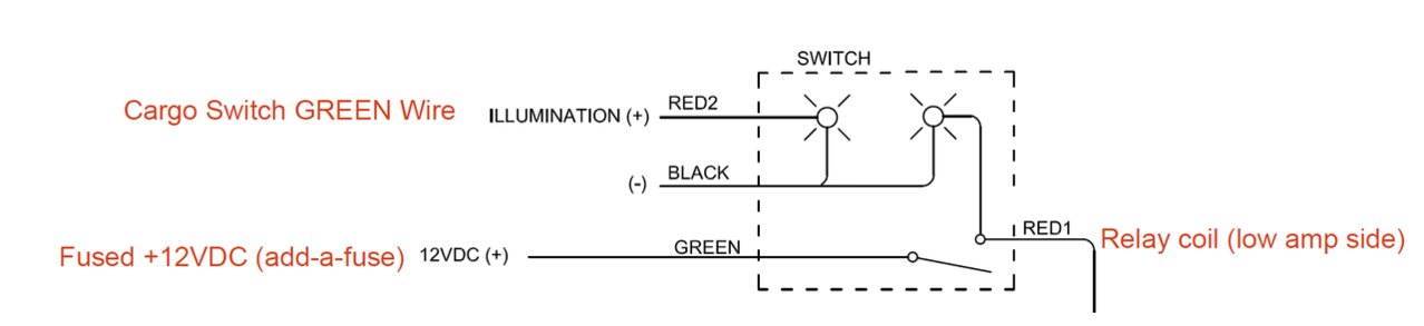

    I'm wiring up my accessories with the CH4X4 Toyota OEM small push button switches. 2020 Tacoma TRD Pro, if it matters.
    So I'm trying to follow the advice on this thread:
    https://www.tacomaworld.com/threads/help-identifying-illumination-wire-on-cargo-light-switch.458634/
    Below is the way I have interpreted that thread, and the way it's currently wired. Although the relay functions as expected (switch is pushed in, light bar goes on), the switch illumination does not (switch illuminated when lights off, not illuminated with lights on).
    Can anyone tell me what I'm doing wrong?

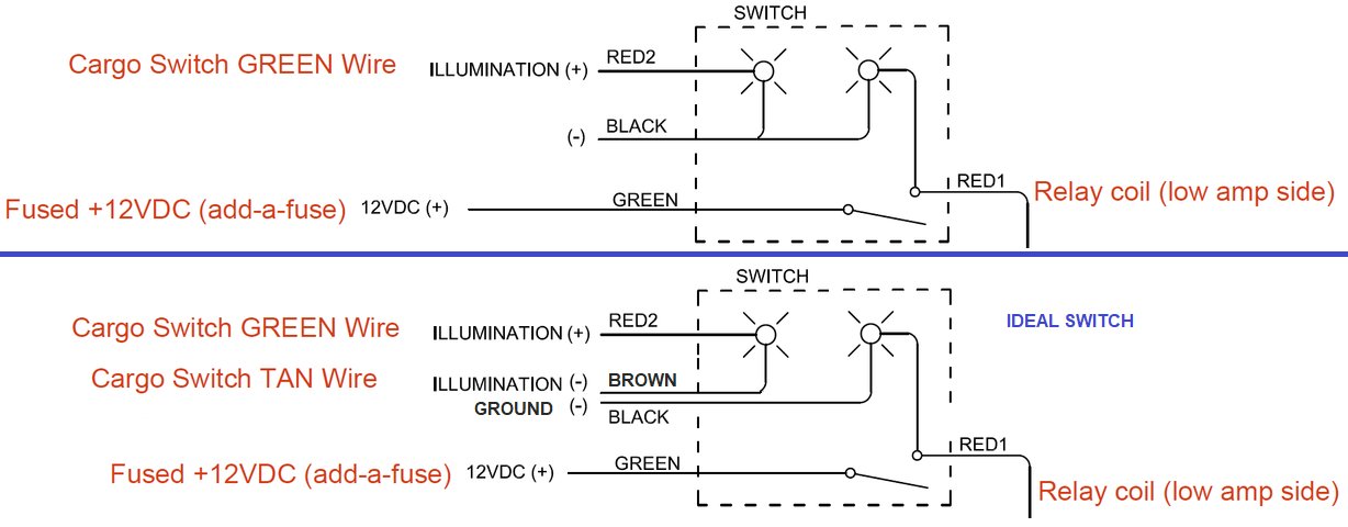

    Switch shares the ground for the internal LED's. It doesn't allow for dimming. So remove the TAN wire and go to ground directly with the Black wire from the switch...

    Caribe,
    I was *thinking* this is what I should do, but I wanted verification. I have everything all soldered-up nicely and heat-shrunk, so I didn't want to re-do it, then re-do it again. Thanks!
    Does this switch also allow for indication that it's "ON"? I.e., lights up brighter or another part when depressed? I think I know the answer but again want to confirm.

    One LED for ON...the other tied to dash illumination but no dimming

    So the way I'm showing it wired, but moving switch black to ground, will this run both LEDs correctly?

    Yes.
    Test it...

    The internals of the $1.00 switch shares the ground of both LED's. They are not independent LED's

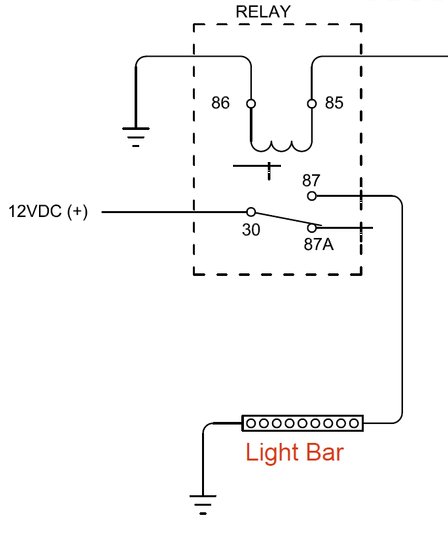

    OP, your drawing on the relay is also incorrect...but it must be wired correctly, since it works:burp:

    Caribe - Your correction to my wiring diagram makes sense. Not sure why CH4X4 doesn't put out a wiring diagram. I moved the black to ground, and right now, the switch labels (left LED in your sketch) work as expected (on when lights on, off when lights off). Switch icons (right LED in your sketch) are always on. I suspect I've go my GREEN and RED1 reversed. I'll check it again when I have more light (and energy).

    Finally, to your last post - D'oh! I went too quick when sketching, and I know better. It's actually wired as you show (87 to light bar).
