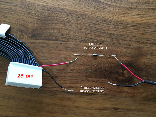

    If anyone in San Diego has installed the diodes I would appreciate some help. Thanks!

    I'm not in your area, but here's a quick picture of where I soldered a 1N4007 diode (everything was nicely heat-shrinked). Note the direction of the diode (gray band towards the 28-pin). Hope this helps you.

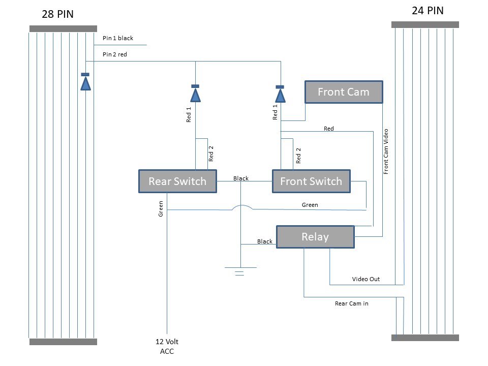

    What part of SD are you in? I might be able to help you out. I made this schematic. I think this is the one JJ sends out. Anyways there are multiple options for installing depending on how you want to do it.

    I’m in Allied Gardens by the 8 and Waring Road. I got that schematic from JJ but it’s still Greek to me.
