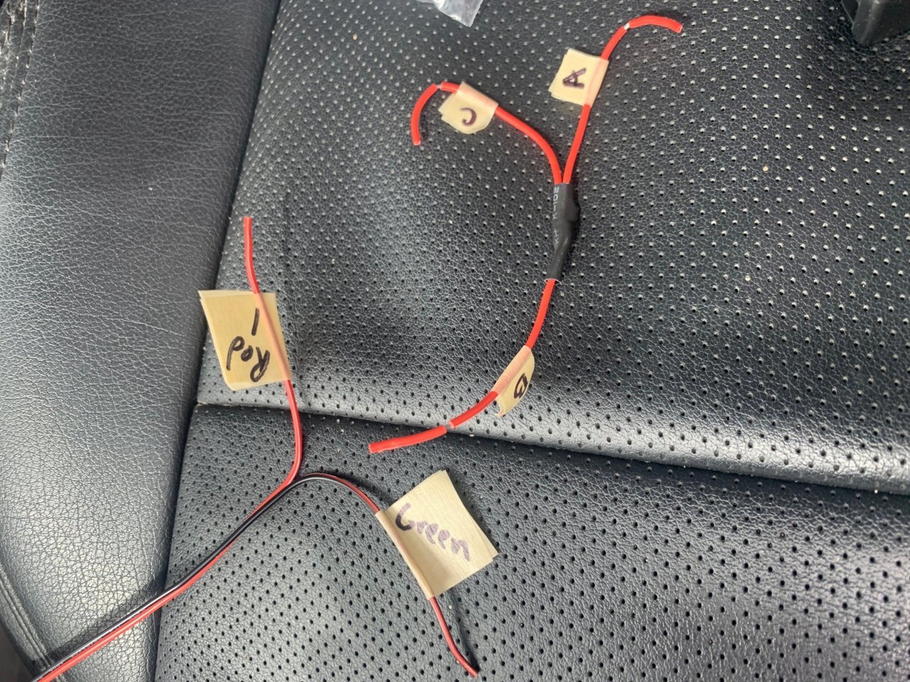

    Does anyone have the wiring diagram that includes the Y wire (Diode) and another set of wires that taps into two wires behind the head unit ?

    Does the wiring harness pic I posted above help?

    here's a picture of the wires I need to connect. I don't have a nice harness like you =)

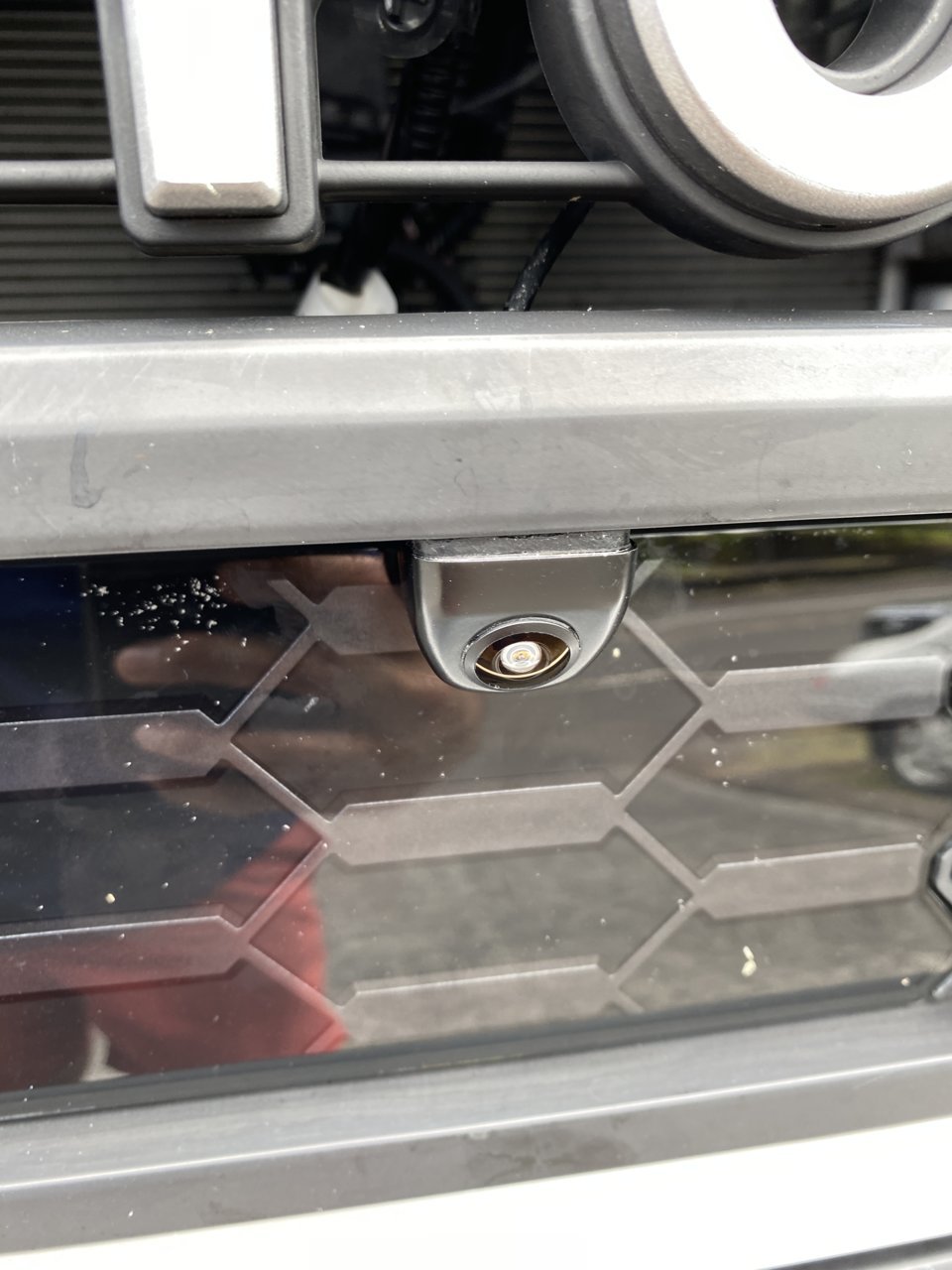

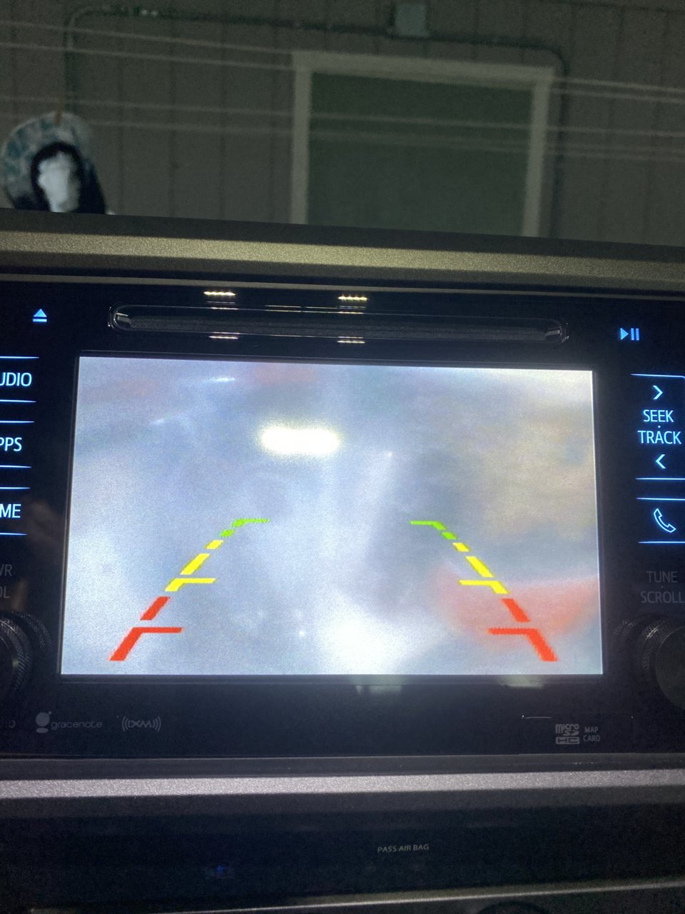

    Anyone ever experience the camera going blurry/fuzzy?
    Worked fine this past weekend and it’s great when going off-road!! came back home and before washing the truck, realized that the camera was a little loose so I tightened the nut. Shortly after, noticed that the camera was no longer as clear as it was.

    just an example...it all blurry now

    Which camera do you have? Someone else has a camera that also turned foggy/blurry in the past few days.

    Yeah... looks like moisture on the inside of the lens.

    I have the kit from runnin4tacos.
    It has the leds around the camera lens as well.
    Yeah that’s what I was thinking. I disconnected just the camera from the whole kit and I’m currently letting it sit in rice to hopefully draw out any moisture.
    On a somewhat potential good note, I found a camera replacement on Amazon for $40. It looks like the same exact connection to the current kit I have so I’ll just take the camera from that. It doesn’t have the LEDs around the camera lens but I rarely Offroad at night. On top of that, that’s what fogs and headlights are for if anything.

    I’ll take a picture of the camera tomorrow. On my way at to my 24hr shift. I’ll also check tomorrow to see if the rice helped at all.
    I was able to take apart the camera piece a little too. There were 4 small Phillip screws and underneath was the wiring and motherboard. Everything looked pretty sealed. Looked like some sort of clear epoxy that was used for the “waterproof” capability.

    How long have you had it... might get a warranty replacement out of it? Try contacting R4T... I hear they have great customer service.

    Had it for a month haha. Never thought of that. I will try to email them today. Either way, would be nice to have an extra backup. That’s if the one off of Amazon is compatible.

    C1E19129-1F3D-4F23-9245-FECB96B7BB52.jpg 44C11A5E-BF77-4C57-9929-04AC2C03F288.jpg
    Bought this Nakita camera from Amazon. Had the same exact power plug that came with my kit from runnin4tacos. There was definitely some sort of moisture in my original camera.
    The quality of this one doesn’t see as good as the original but at least I got this to work and was lucky enough that I needed to only spend $40 for a $165 kit.
    reached out to runnin4tacos support for the kit I bought to see if I could get a replacement but didn’t hear back for about a week.

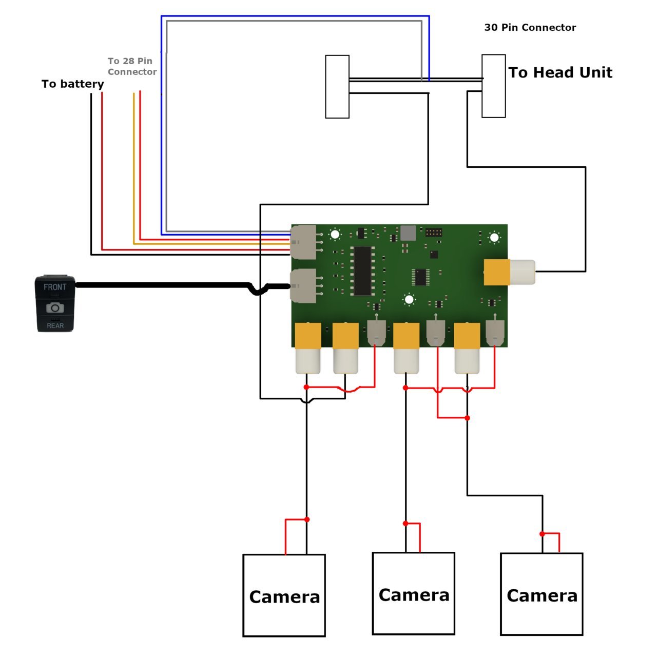

    anytimebackupcamera.com
    If you want to add more cameras you need the same wire harness but a 4 camera PCB which I can put you in touch with the designer if you like.
