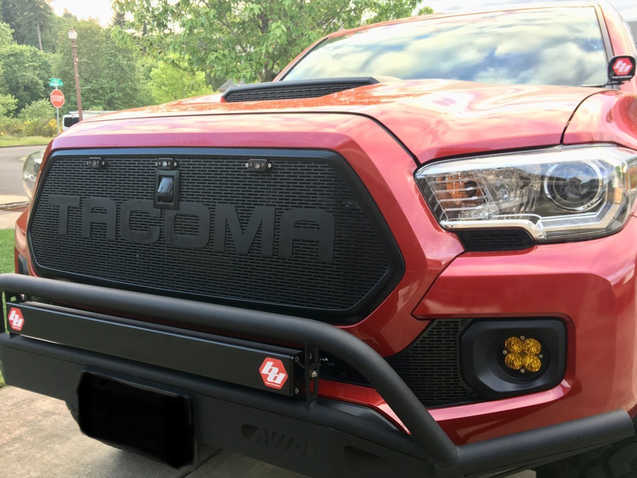

    Check out Beat Sonic. I have their mirroring system and their front/rear anytime camera
    I just actually mounted their front camera in my housing I have that I mount on the front of my grill. I chose to make my truck look OEM and match. I was given a Tailgate Rear Camera early on that someone was getting rid of and I modified it to mount the camera portion to the front of my grill. However, with it being a reverse camera, I finally decided to get a different camera for the front but I kept the housing so it would still look similar to my reverse camera housing. Here I have the camera mounted to the inner piece of my grill.
    They have the camera that is flush with the Toyota logo tho. Definitely check out what they have. The mirroring system is pretty legit. It also has the navigation by-pass mode as well

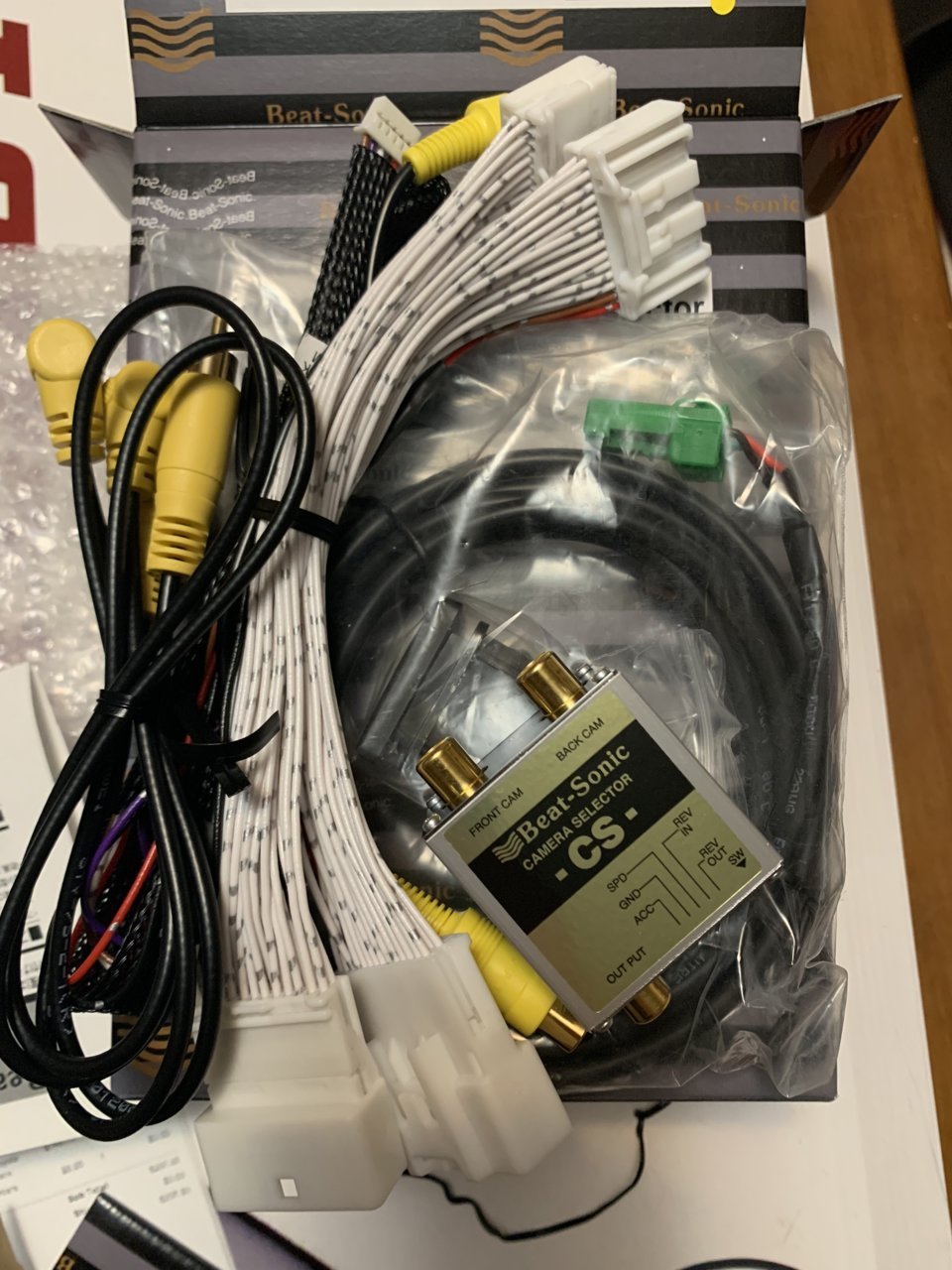

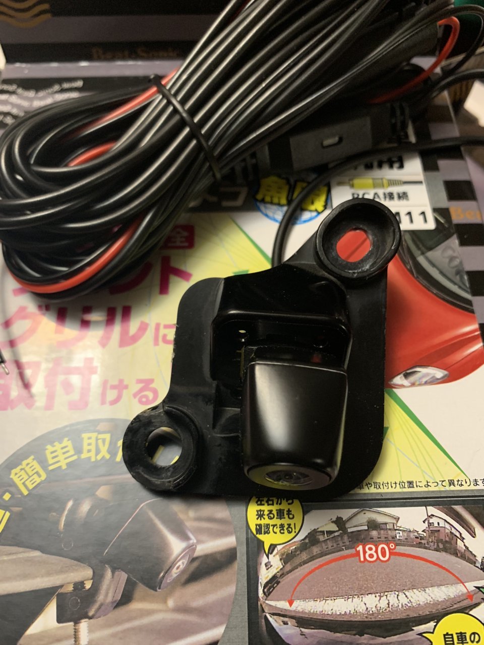

    Thanks - Now I gotta remove the Crux harness. I will go with the BeatSonic CS6EP Their docs say you can turn off the automatic low speed function.
