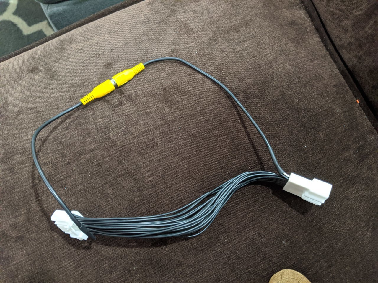

    Not sure if there is a better spot, but would appreciate if someone could point to what is wrong. I have the ABC kit and was trying to install it but after all the wiring was complete using the switch just made the screen go black for forward or rear camera. I can see the front camera coming on (thanks too the LEDs on it) so I removed the harness with the video cables on it and the switch was able to turn the rear camera on so I put the harness back in and connected the video cables like below. I was expecting the rear camera to continue working, but instead the video was black again. I'm guessing this indicates that either on of the video cable ends is faulty or the whole harness is. Anyone have any suggestions or thoughts?

    I'd test each pin for continuity with a multimeter.

    That found it... it was the positive wire on the female cable. Fortunately had another one sitting around. Working now!
