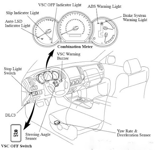

    I suppose you could alter the buzzer but I wouldn't recommend it. Why not just turn off VSC using the VSC off switch? Remember our discussion in the "TRAC by Bosch thread?" When wheeling in H4 I would wheel with open diffs in VSC off mode...
    I would suggest that to anyone that wanted to play around in their trucks and be free of any restrictions (except ABS which only turns off when locker is on, and under extreme situations VSC may reactivate even if it is off--this can happen while braking and yaw rate is large.)
    The buzzer is located to the right of the steering column if you sitting in the drivers seat. Here is the best illustration that I have.
    But back to the OP was saying, he doesn't want to take that turn less than 15mph, so... VSC is going to anticipate a vehicle skid and intervene.
    The only options are to drive slower, or disable VSC. Adding weight in the back may help him, but only if it it is the rear that is breaking loose during the turn.
