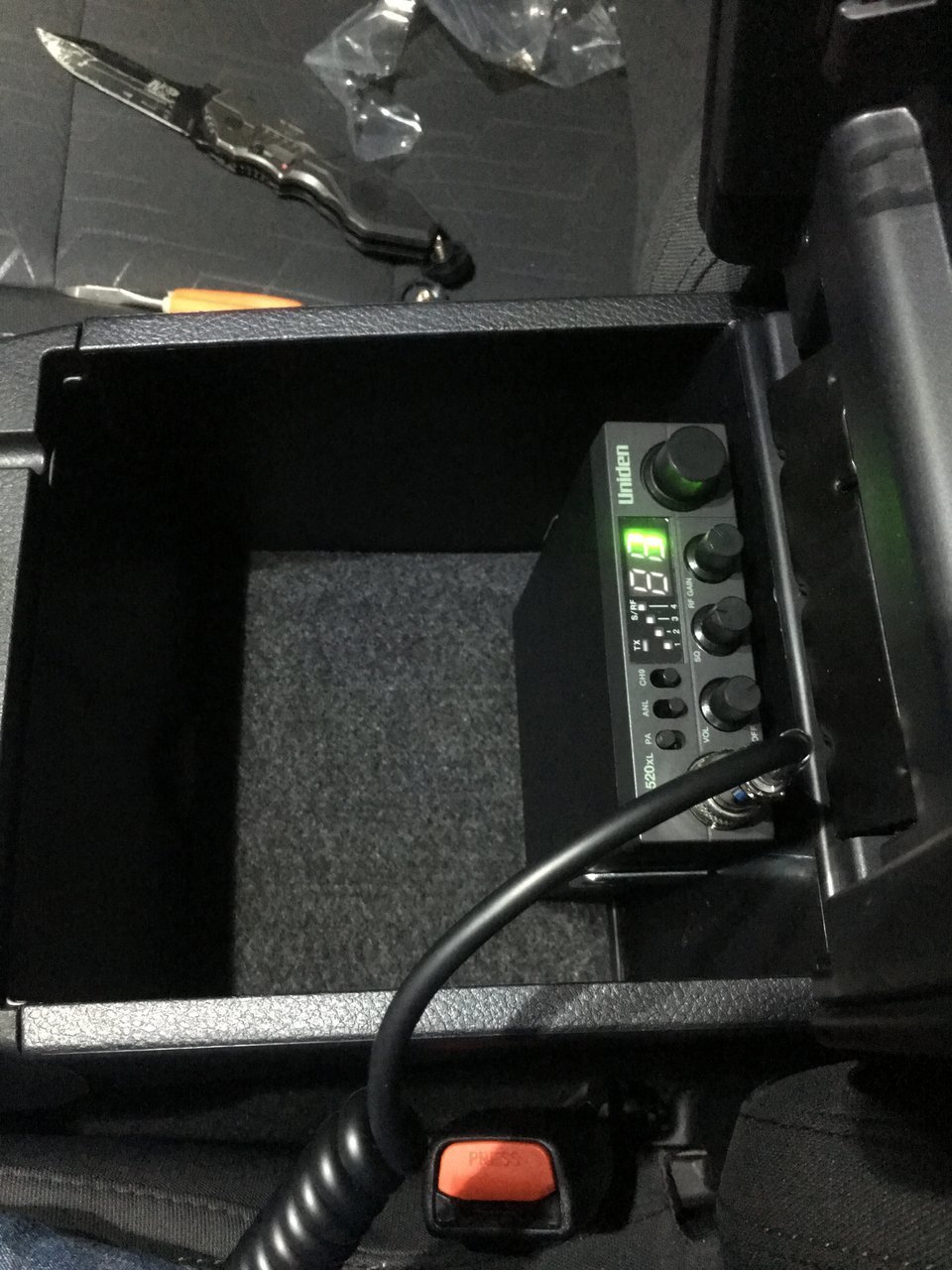

    That's the one I wanted to get, but I ended up with the Uniden Pro 520XL. Doesn't have SSB or Scan, but has PA and is only $40. I'm getting my HAM license for longer range communication now though. I'll still run my CB in the truck as a secondary comms.
    I've since put a 90 degree connector so I can close my center console and ran a longer CB mic cable under the floor to have it come out near my legs and mounts to my vent for quick access.

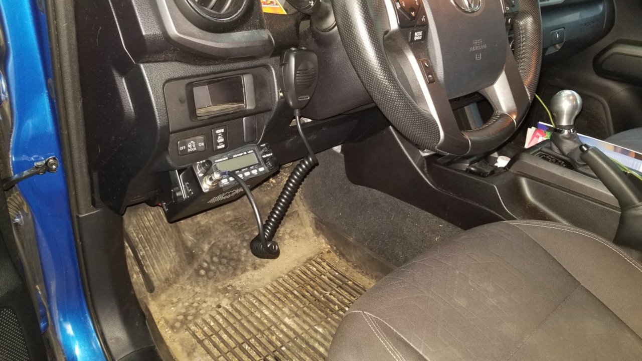

    Take a look at the President FCC Bill radio paired up with the removable President New York Antenna. Here's a video review of the setup
    https://youtu.be/wvVjt-0xO2Q

    not sure how you can stand it in that location. my knee already hits the switch area.

    That's the beauty of the FCC President Bill radio - it's almost the size of an iPhone or a pack of cigarettes. It almost fits in the pocket just above the bed light & bed power switches.

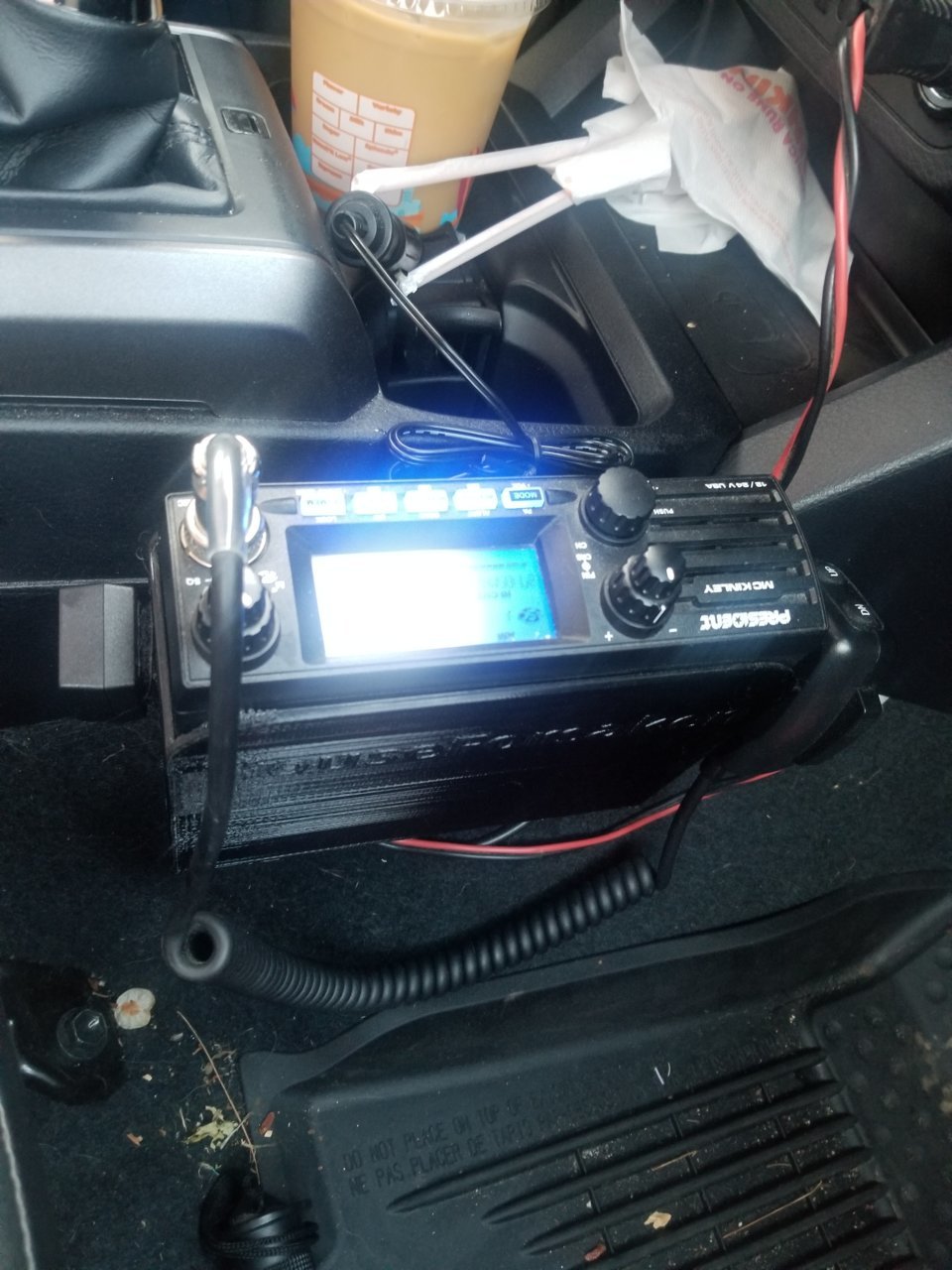

    I wanted a small SSB/CB also which is why I went with the McKinley! I'm very happy with it! A member here 3D printed a holster for me so I didn't have to worry about drilling into my new truck.

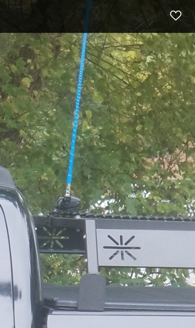

    I'm running a 3' Firestik II on a Diamond K9000 LRMO motorized mount which is attached to my bedrack. I can raise it and lower it from inside by pushing a switch. I've read mixed reviews regarding our paint and fear it tearing/flaking off with a magnet over time. But I've heard great things about the Wilson antenna!

    How did you get the dash apart to get right there

    i didnt. i used self tapping screws with the bracket and i routed the wiring through the side at the corner. I did drill a small hole to give me enough room to fit through.
