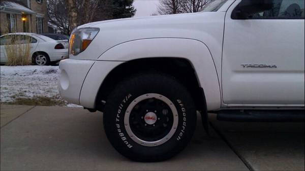

    whatever you decide on, install the front lift first, then have the dealer do the rear tsb so you get the free alignment..here's mine 5100's at 0 with eibach coils, and rear tsb.
    before
    after

    2011 TX Pro
    OEM black tube steps, weathergaurd floor mats & wind deflectors, trimmed mud gaurds
    before
    after

    OME 881 coils with OME nitrochargers shocks up front. TC UCA's OME Dakars with extra leaf in the rear. Warn 8000 winch with 80ft custom braided synth line. Custom 60ft synth extension. All pro tube bumper, Hi-lift jack, Safari Snorkel, Wilco tiregate.
    Umm.. I don't see much of a difference other than the 2nd shot is brighter and you can see the coil/shock.
    Your getting 3 inches?

    not 3 inches, i got just over an inch in the front and 1.5 inches in the rear... i know the pics suck, but whatever:anonymous:
