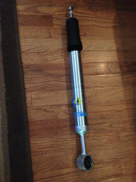

    So I am in the middle of installing a set of front 5100s on my stock springs and i just relized that my 5100's don't come with any dust boots. I don't thing the old one would even fit over the new 5100. So my question is do I need dust boots ? And if so where to get em?

    Front 5100s don't come with dust boots.

    You don't need dust boots. Some say that they actually shorten shock life.

    I just got my 5100's. They were on my front porch when I came home. Plan to install them this weekend. Rear lift isn't here yet.
    I was looking for info on them as well. Some on Google Image search have them and some don't
    Mine had these plastic covers on 'em. They're number 24-239370
