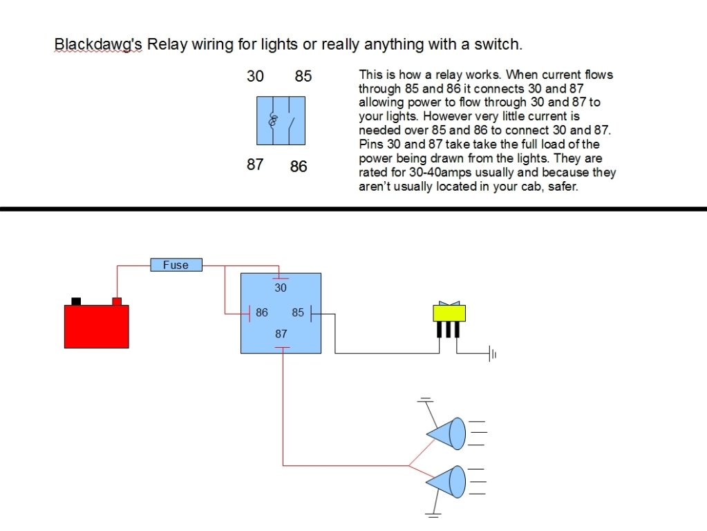

    Anyone have a write-up/DIY or diagram to wire these light bars? It'd be very helpful. I'm looking to run them to the ignition so power is off when truck is off and have its own independent switch.

    You'll probably need to run a relay to the your stock lights, with a switch.

    Yeah that's the plan. Just wondering if anyone has done a right up for this.
    Just as a reference. I've never done it before :rolleyes:

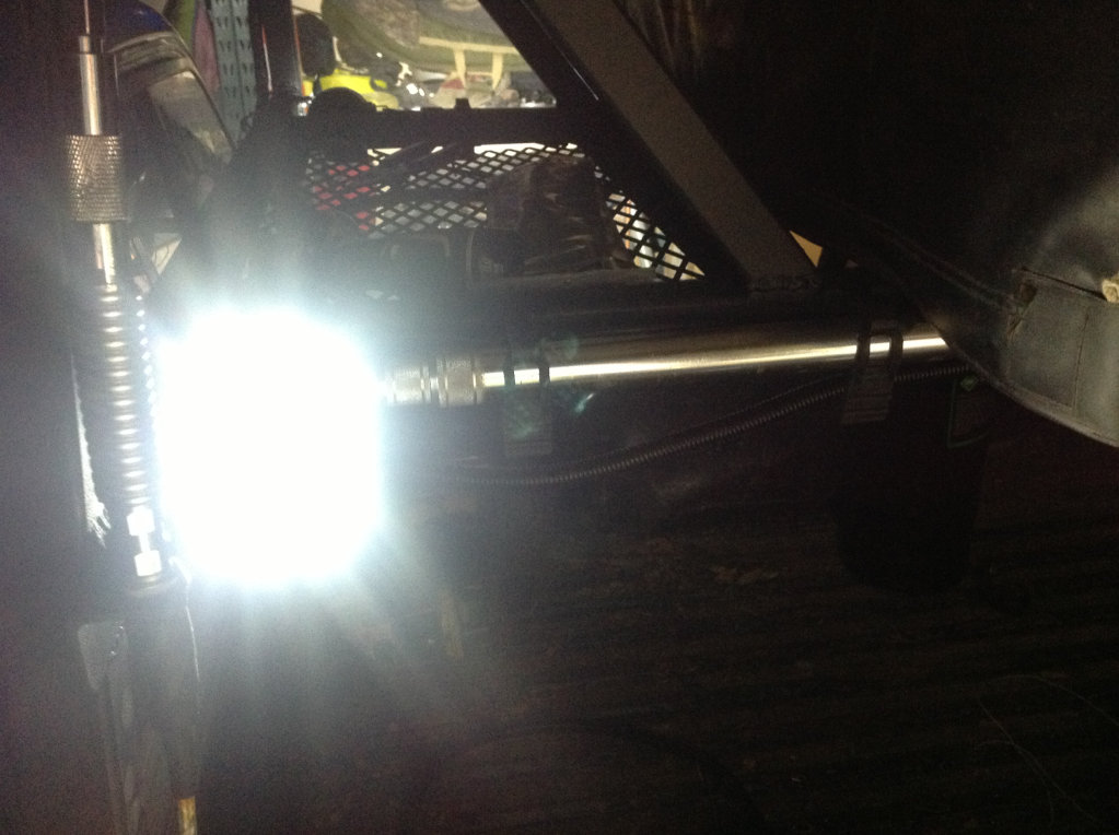

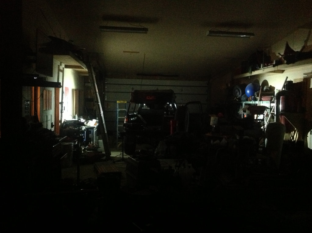

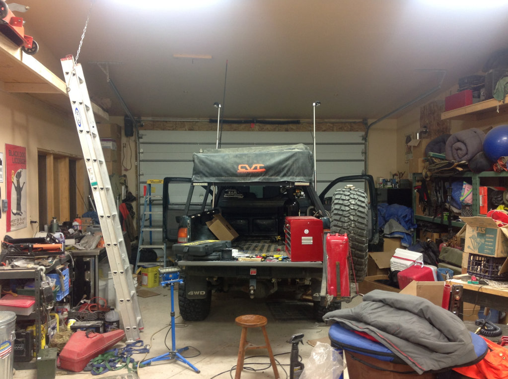

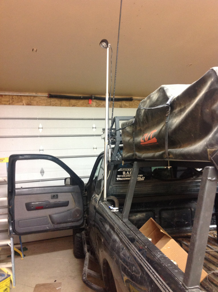

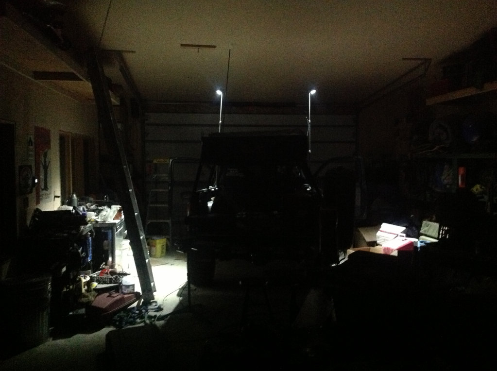

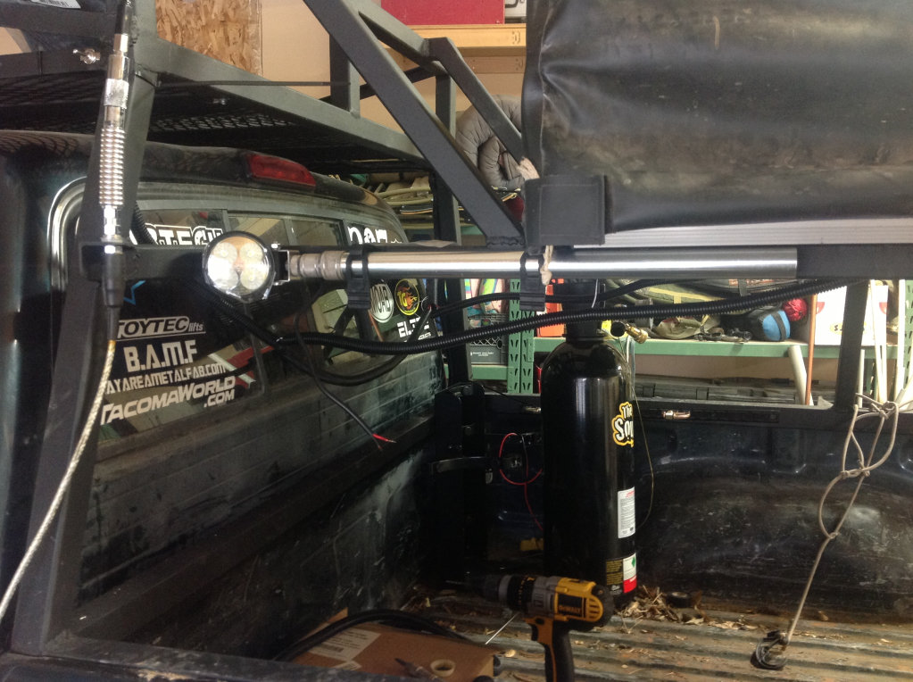

    My use for the 3lrs
    Sorry a desk is blocking the passenger side..

    But this might help.
    Sorry the drawing for the for the relay in the top is a little wrong. But the typing part on the right is what's important.
