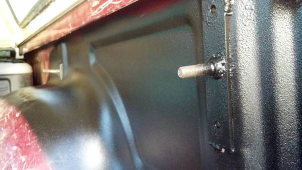

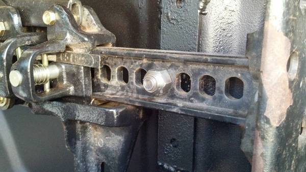

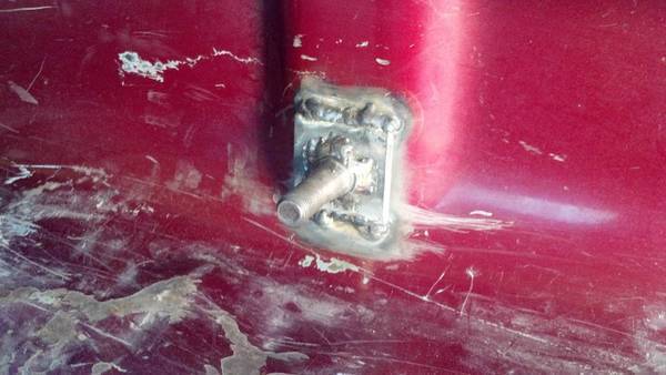

    It was a beautiful day today, hit 60, didn't feel like working, set the phone to voice mail....:rolleyes:
    So I did this little project that I have been wanting to do but it's not glamorous so I had been putting it off. My Hi-lift is in the way as it floats around in the bed of the truck and I wanted to mount it to the bedside.
    Every piece used was scrap that I had, function was more important than form on this one.

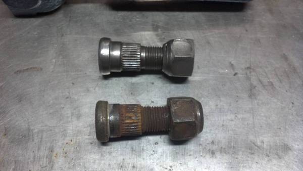

    Started with two wheel studs and lugnuts from an old International.
    Hit 'em with a wire brush and cleaned the rust off.

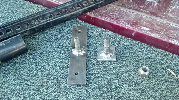

    Then I welded the studs to some scrap strap and a square piece that might have had a purpose in another life.
    These were welded to the bed side, that is some thin stuff by the way...:eek:
    Not proud of the welds, but did I mention that it's quite thin, hard to join to different thicknesses, but it's strong. The sheet metal will tear before the weld breaks and I don't see that happening anyway.
    Used some spray on bed liner to cover the welds and went a little too far.
    I plan on lining the bed eventually anyway.
    ( it looked good as it went on and I was slightly mesmerized by it :D )
    The studs are straight, it's the camera angle.
    And now it's out of the way. Tight to the bed, no rattles. I can't stand unauthorized rattles.
    Inverted lugnut to cut down on loss of skin.
    I might try some of those quick fist things on the other side for the shovel.

    Looks great. That a great solution. Even with the weight of the hilift, I'd be surprised if there is enough weight to tear that thin sheet metal.

    Thanks Adam, I was hoping for a better "look", but the jack covers it anyway.
    Once it's all bed lined I think it'll look better, my truck bed is beat to death on the inside.

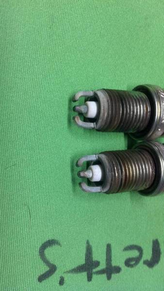

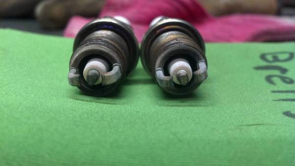

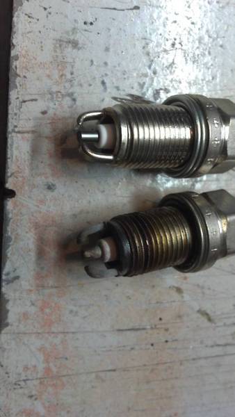

    Changed the plugs today, 18° F out and snowing,:rolleyes: wanted it done.
    No pics of the process, there was high concentration going on trying not to break cold brittle wires and intake components.
    Looks like everything is burning like it should.
    They didn't look too bad, they did need changed though, I can't remember last time I changed them, so it was time.
    After the change, it seemed to idle a little smoother.
    I left the wires alone, they looked fine, no cracks, I'll change those next time.
    Checked on a cat from the stealership, their asking $1027.00. They can keep it.

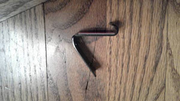

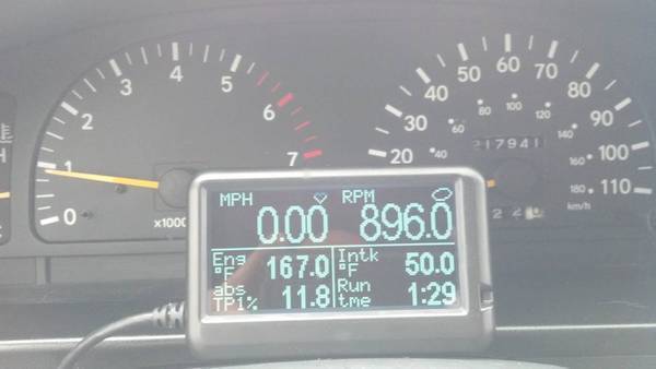

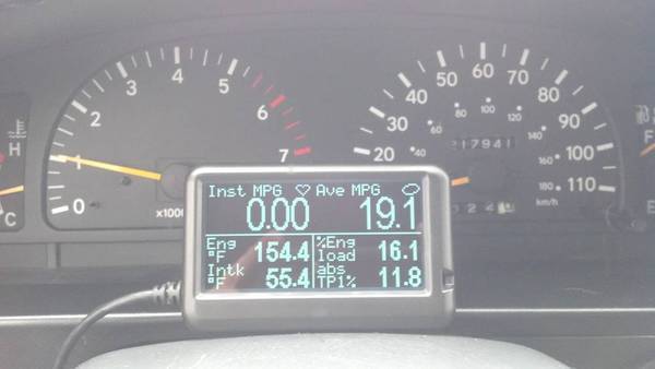

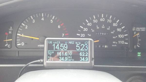

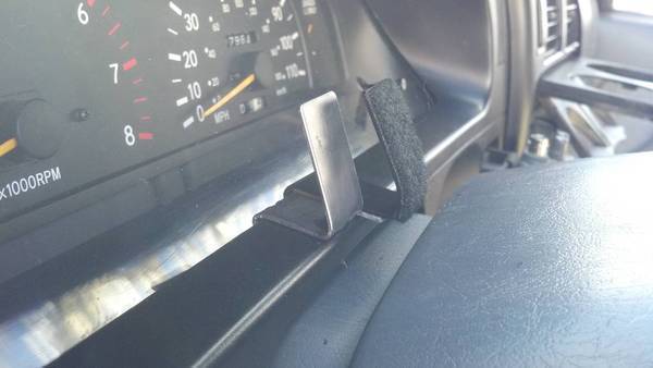

    Calibrated and installed the UG today.
    This is what I had to work with for distance test.
    If you have one, you know that it recommends 50mph or higher for a minimum of 2.5 miles. I used my GPS to calculate mileage driven so I could start and stop at a safe opportunity, I went a total of 3.89 miles.
    The discrepancy was like 1.08 whatever it measures.:eek:

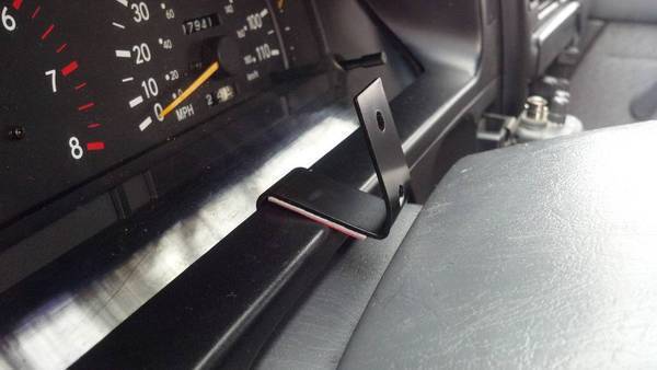

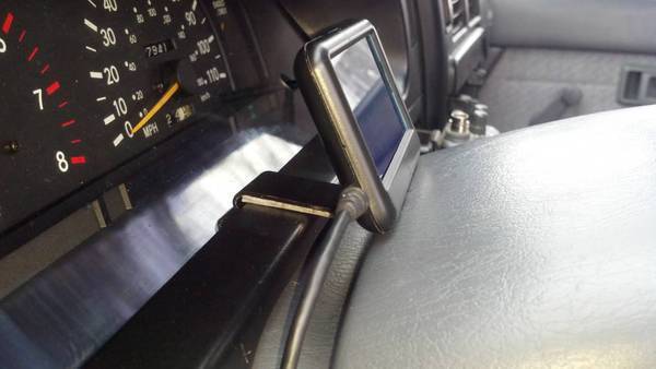

    Looking for my Velcro, I found this bracket. I added more bend to it and doubled a layer of 10lb double stick tape.
    Test fit, I ended pinching the small curl on the base a little tighter, can't be seen in this pic.
    Then I added my Velcro to that surface and the back of the UG. I might re-bend it and place it a little further back, but for now I'll see how it does.
    It sits higher than everybody else's, but the only light it blocks is the seatbelt light and I ignore that anyway. I can also access all the buttons without removing it.
    Pretty cool little toy :D
    Edit:
    I did end up making another bracket and moved it back about 1/2"
    I like this much better. It allowed me to move it down a little as well.
