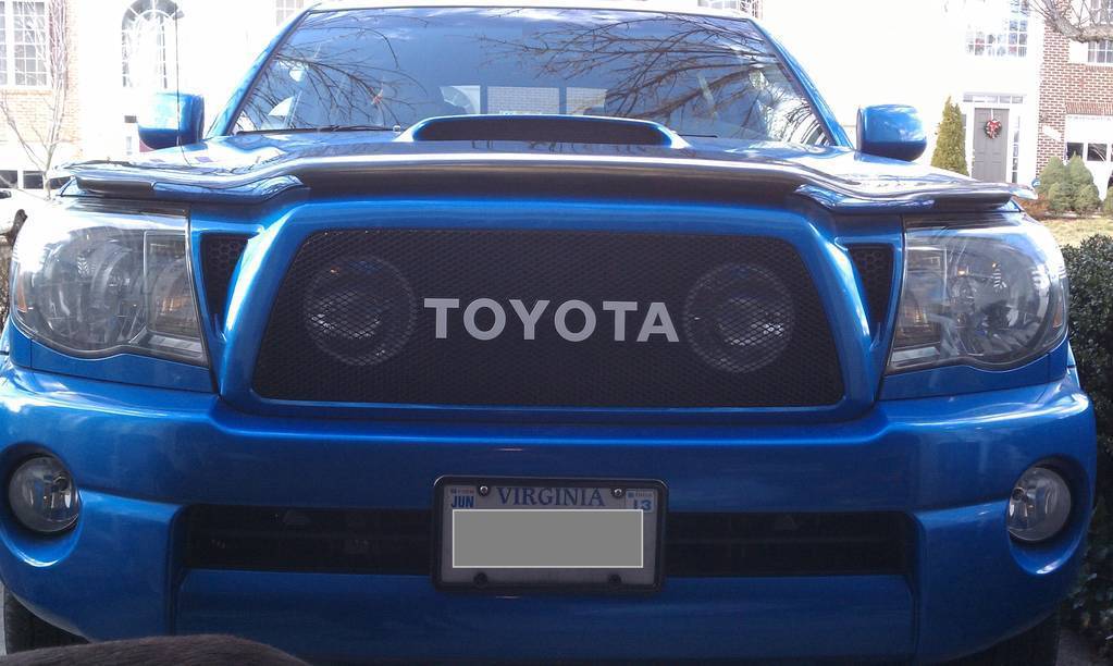

    As modified grilles go (Satoshi) innovation and persistence tend to yield great results. It's my humble opinion the efforts by Cape Codder (grille, bumper guard, and light) are a great look combo and really stand out.
    I jumped in, of course. The first effort was just a GrilleCraft grille and no lights or letters. That was OK and gave me time to do a TOYOTA Satoshi, on a purchased unpainted grille.
    I then thought TOYOTA letters, with more depth, would stand out a little more.. I did get the letters finished but got side tracked by the forum.
    As several comments regarding the less plastic used in the 2011 grilles vs. 2010 and older I kinda took that as a challenge. So......took the GrilleCraft off the 2011 grille used it as a guide to build up the back of the 2011 grille, and then reinstall the GrilleCraft grille on the back of the plastic assy and added some TACOMA letters I constructed while fiberglass and bondo were drying.
    Not sure just how thrilled I am with the results yet, but admit it's different and most likely the only one like it in Colorado.

    Dude that TACOMA looks BAD ASS! How did you do those letters?
  18. Dec 22, 2012 at 2:44 PM
    #138
    SeniorSpan
    SeniorSpan Well-Known Member
    Dec 18, 2010
    #47881
    153
    Bob
    Colorado Springs
    11 Silver 4wd TRD DC TXpro
    The positive comments are appreciated, thanks.
    As I'm one who hates it when all the info is not provided, I apologize for not including the following:
    The letters: I found, using graph paper, the letters needed to be appro 3 7/8" wide and 2 3/4" high to span a distance of 25 1/2". I had some scrap 1/4" plexiglass from another project and cut the letters from that, ensuring uniform height and width. I used a dremel, hand saw and small files to cut and sand the insides of the O and A letters. I elected to curve the ends but not necessary. The raw letters were full sanded front and back, primed and painted. Finished with a few coats of clear. I did not prime or paint the backs as I used clear RTV to mount the letters on the GrilleCraft grille. I kept the RTV at minimum in case I wanted to remove the letters at a later date. The grille has been on the truck for about 6 months; rough road, 4 wheeling, altitude (14,000 feet, Mt Antero) summer and winter temps have not dislodged the letters.
    All in all a fairly easy project. Most time spent was ensuring the letters were square and sides straight and smooth.
