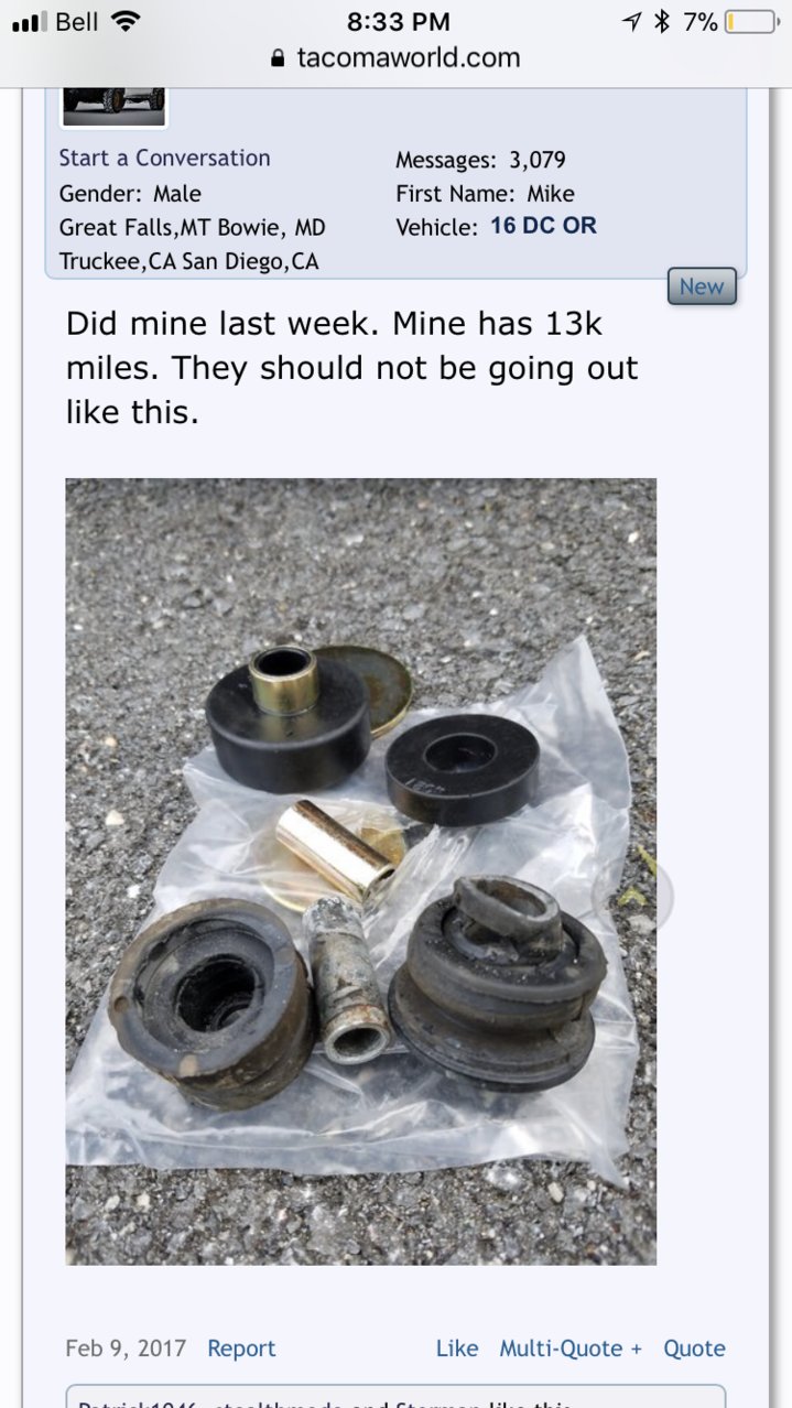

    How can you tell if your cab mount bushings are bad? It doesn't seem easy to take them out.

    Can't really tell with them in, but swapping them out was quick and easy

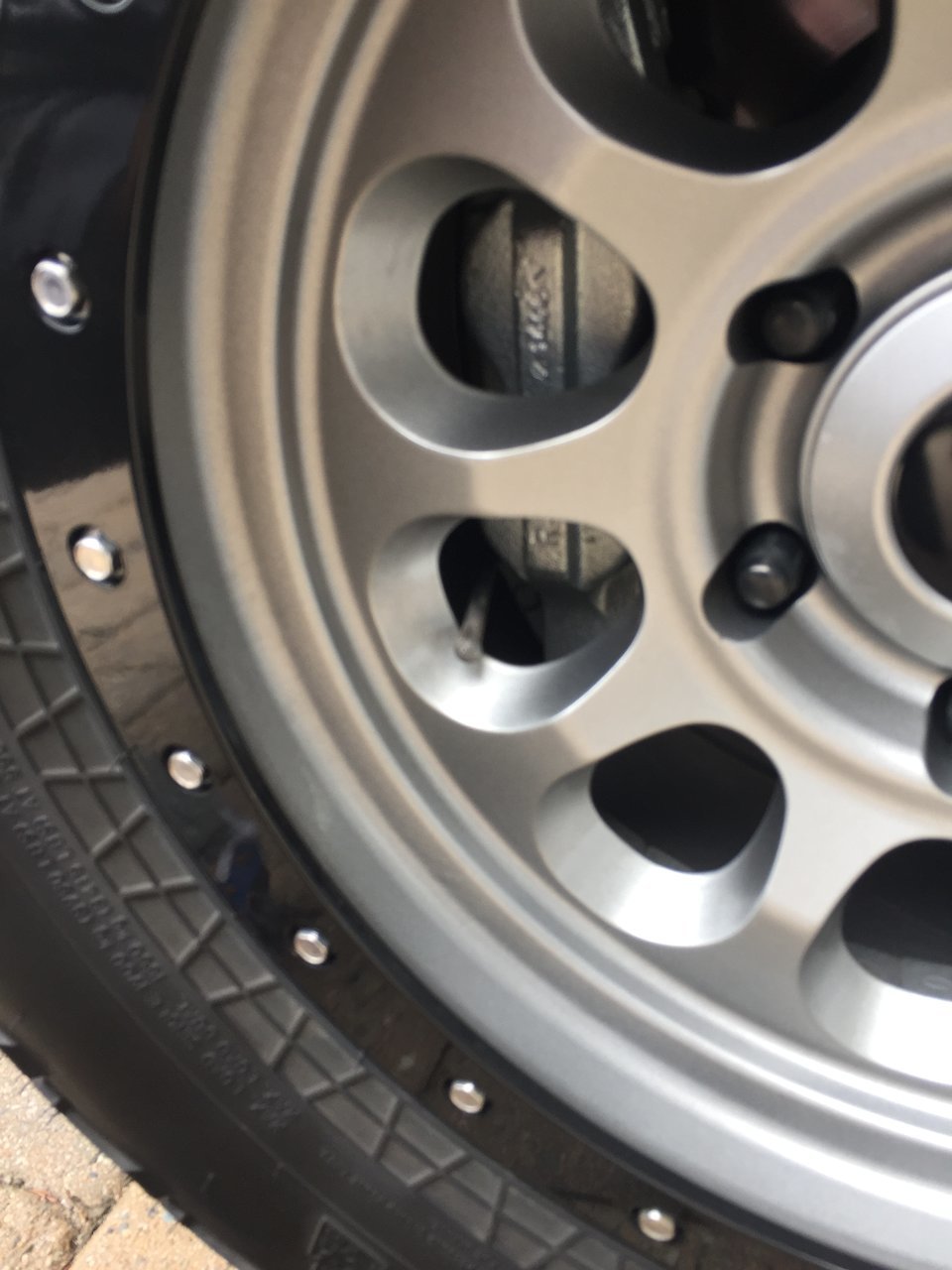

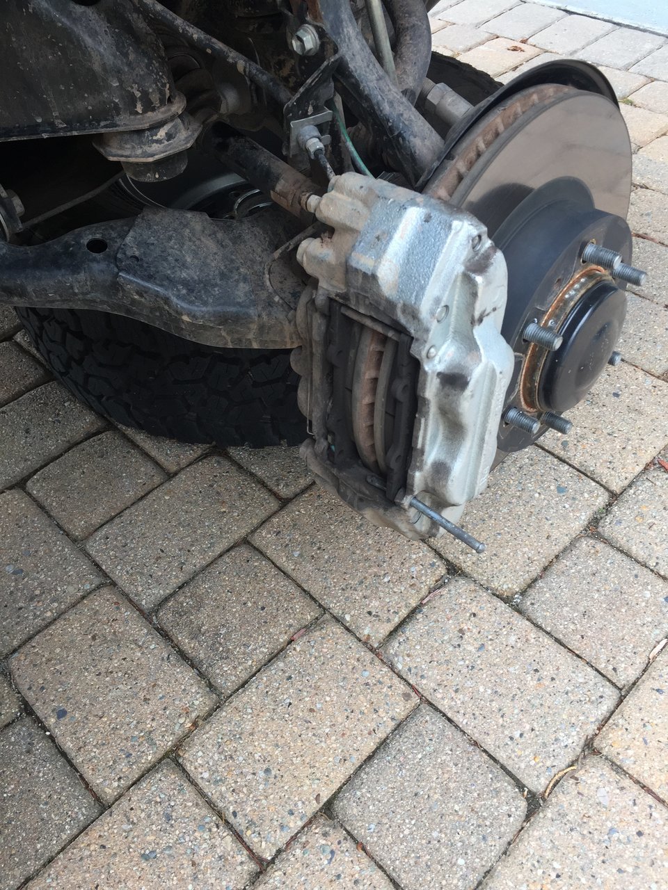

    Mine did this, the locking clip device for the lower pin had come loose and the pin had walked half way out.

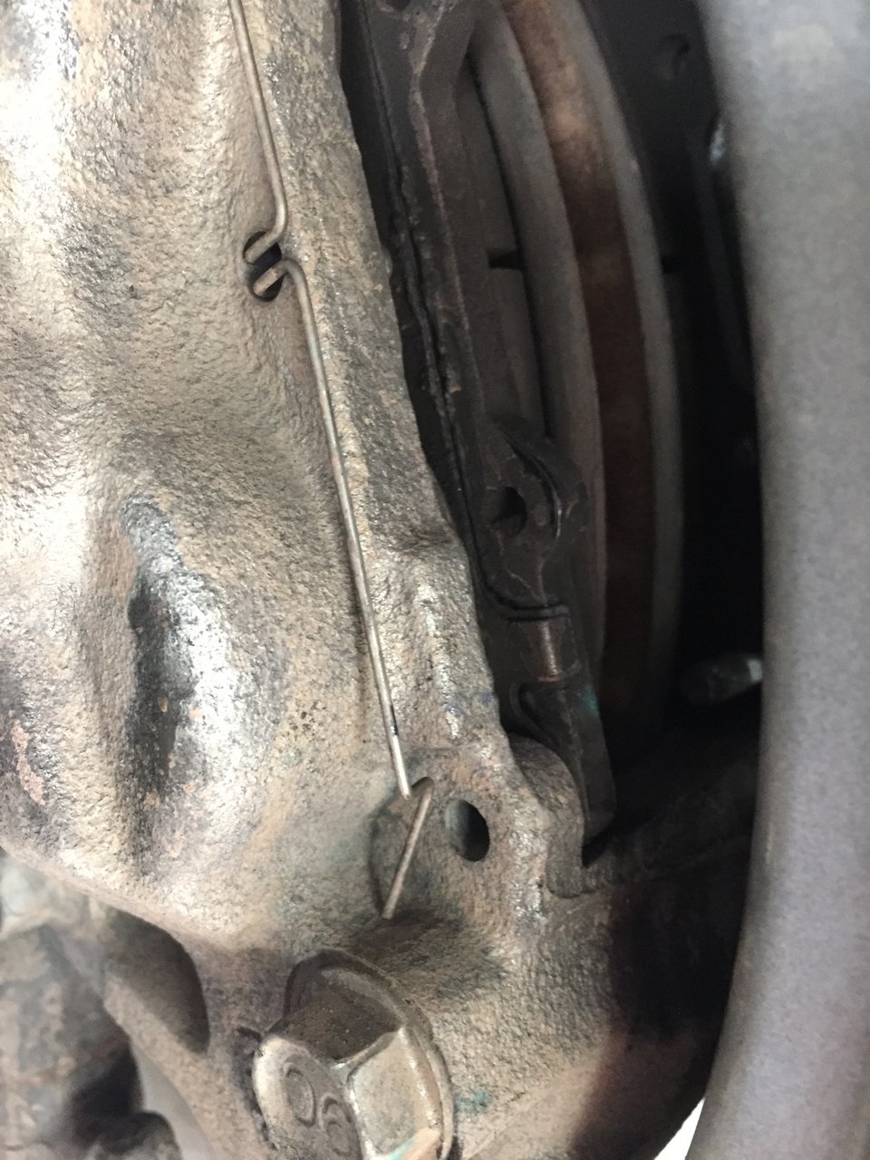

    I knew mine was the brakes since the noise disappeared with light brake pressure. This is what I found.

    sorry, but what did you find? is something loose?

    In the last picture you can see the retaining spring(that metal wire) has popped out of the hole it's suppose to be in
