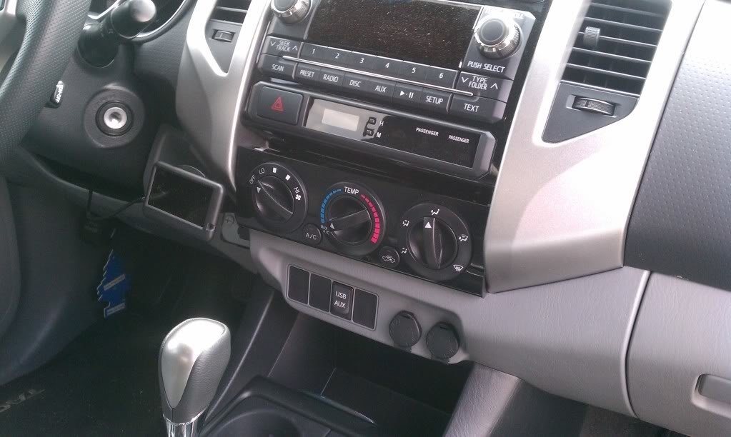

    Does anyone know how to remove the interior piece right below the climate comtrols on a 2011? Just looking for a little guidance.

    Pic or description of the part?? Are you talking about the grey piece below the climate controls in this pic, but above the storage pocket forward of the shifter?

    Yes, sorry for no pics but that is what I am talking about.

    drop (or remove) the glove box and the panel under the steering wheel, then remove the center console (the entire thing). Then you can remove that part.
    If you don't know how to do all that.... then you likely shouldn't be trying to take that panel out and should find someone that can do it for you... Also, the above link won't help you.
    Just for confirmation, you're talking about the grey plastic panel that houses the cig lighter and aux power source, and the black pop-out panels (Aux in, USB, etc...), right?

    I didnt find any info in that link I could use. Here is a pic of what I need to take out.
    I need the piece that has the switch panel on it out.

    I can handle it I just wanted to know how it is held in. Thanks

    that looks like a 2012 model, but the process will likely still be the same.... Glove box, panel under steering column, and the entire center console need to come out.
    There's likely about ten 10mm bolts and a similar number of philips head screws that hold all of it together.
    Really doesn't take but about 10 mins.
