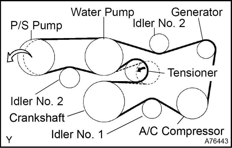

    Is there only 1 tensioner pulley on the 4.0L for the serpentine belt? I would think that one is fairly easy if you can find the belt diagram to show you how it goes back on.

    Just one.

    3&4 are standard recommendations for fluff services that take 2 mins that they will strongly recommend to anyone who comes through the door, regardless of time or mileage. Skip them, you only *might* need those if you have a driveability problem that #2 and #7, and a whole host of other things, won't fix. The service advisor gets paid a lot for selling them to you, though.
    1, 6, & 10, the alternator, water pump, and serpentine belt could be serious in that those parts failing will leave you stranded so I wouldn't ignore them, but they can probably be addressed elsewhere for less. The water pump could be leaking badly, which needs fixed ASAP, and is not uncommon at that age/mileage, or it could just be weeping a bit, in which case you have a bit of time, but keep an eye on it - don't rely on the temp gauge, by the time it reacts you are well on your way to overheating.
    If money permits, do 1, 6, 10 together as you'll need to pull the belt anyway, so you may be able to save a bit on labor versus doing the water pump or alternator separately.
