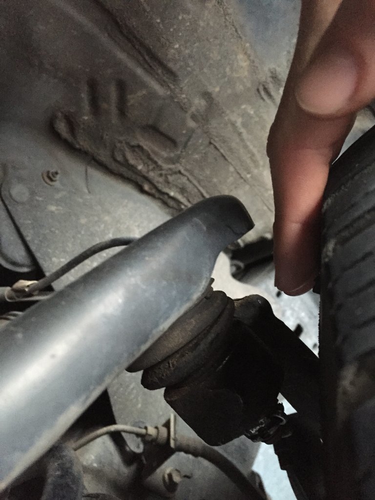

    So I had a truck that is half in alignment, with more camber than I originally started. After inspection, we find that the lower control arm bushing is bent on the passenger rear. (of course.) I had a local body shop bend the LCA mounting bracket forward. This helped the caster a bit and swapped the LCAs out with no change. Additionally, I got ahold of some stock length Total Chaos UCAs and threw them on for good measure. The alignment shop was able to get everything in spec other than the camber. (Only a few degrees negative which is livable.) Maybe if I go to 2.5 coils the extra lift will help out a little?

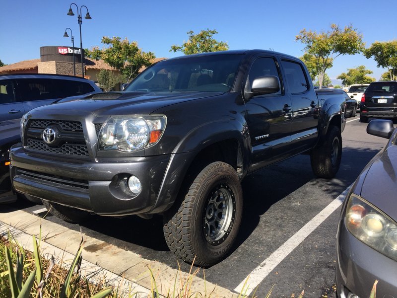

    Going to get my SCS and 275/70s mounted.

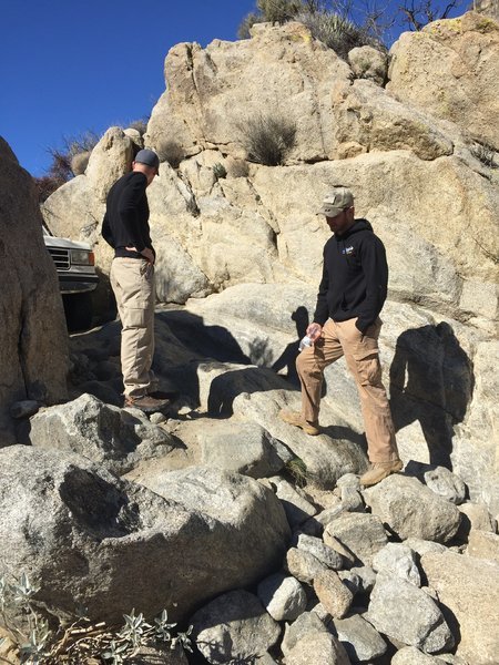

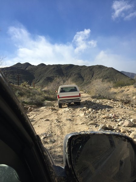

    Here is a photo dump of a trip the trip the girlfriend and I took earlier this month. Friend of mine brought out his Bronco to play.
    We originally intended to go into the truck trails of Shelter Valley. Unfortunately his fat ass truck wouldn't fit between "the squeeze" so we ended up climbing the mountain and coming out onto Banner Grade. Still a great trip!
