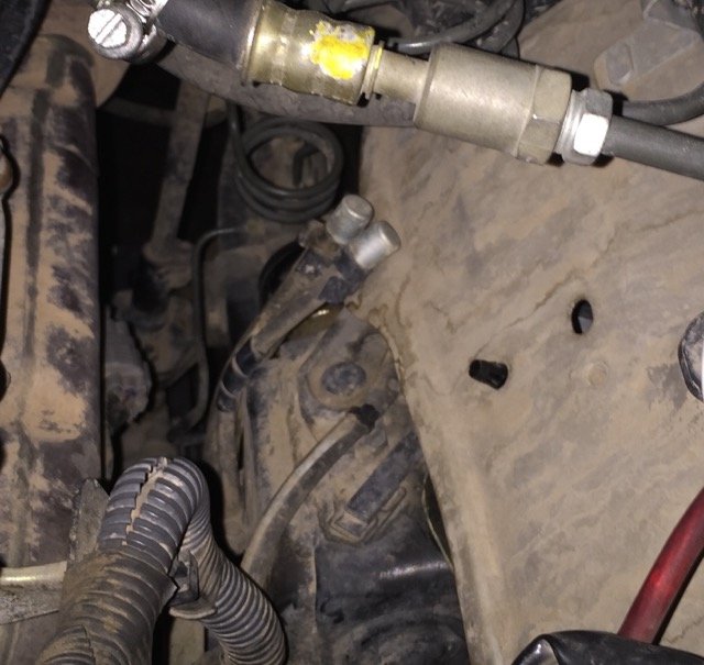

    Just relocated my rear diff breather finally. Parts just been sitting in the glove compartment for over a week. Instead of moving it to the gas cap I moved it behind the driver tail lights. No drilling required. Awesome easy mod. now just got the T-case and tranmission to go.
