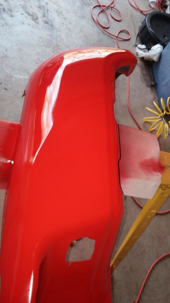

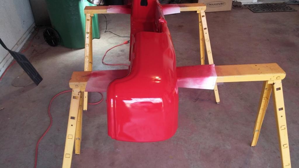

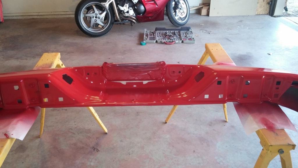

    Just finished colormatching my bumper today in the garage. A cold front came thru last night so I knew it would be 71degrees and about 35% humidity, so I gave it a go. I was inspired by this thread.
    http://www.tacomaworld.com/forum/2n...ye-bye-chrome-bumper-hello-color-matched.html

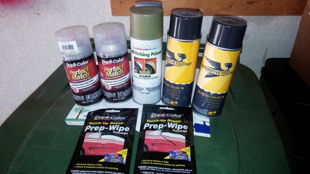

    Here is what I used:
    orbital sander
    220grit orbital sander pads
    400 grit we/dry sanding paper
    2 cans of paint I bought at http://www.automotivetouchup.com/
    2 cans of duplicolorself etching primer
    2 cans of duplicolor clear coat
    2 duplicolor pre paint surface wipes
    Lots of patience
    WARNING!! Do not mix automotivetouchup.com paint with krylon or rustoleum brand clearcoats or primers. They will not mix!!! Duplicolor is ok to mix. I called and spoke to a representative to triple check before I started. Something about one being an acrylic paint and automotivetouchup.com being a urethane. (above my knowledge of paint)
    First you remove the bumper. I used this thread
    http://www.tacomaworld.com/forum/2nd-gen-tacomas/41023-removal-installation-rear-bumper.html

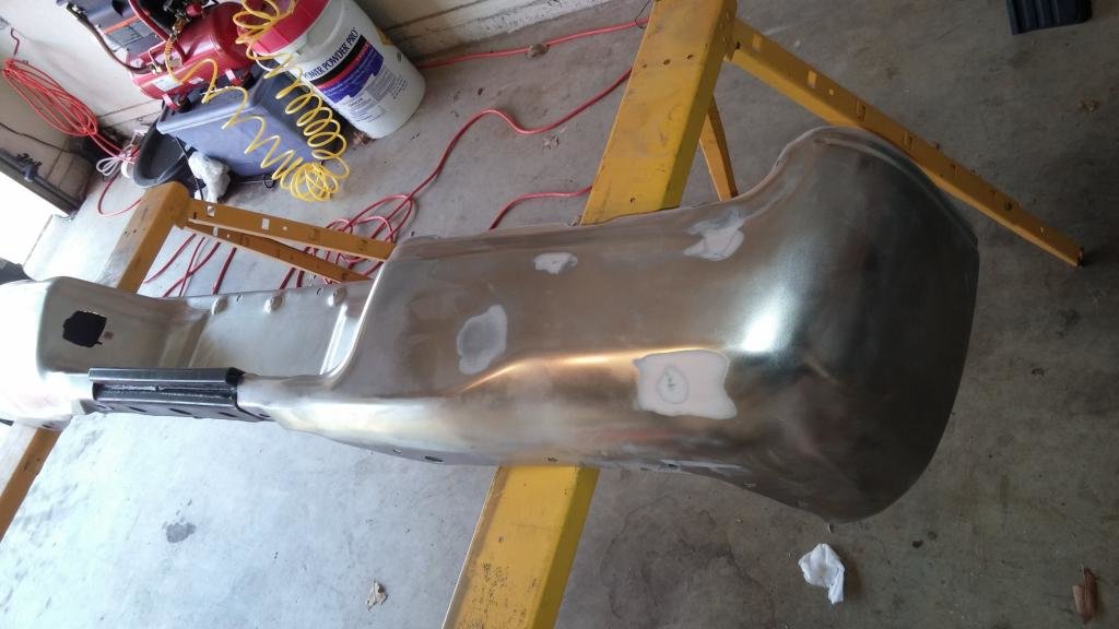

    Next, I sanded the heck out my bumper for 3+ hours changing orbital sander pads frequently. Plus i filled a few dents with body filler and sanded it down

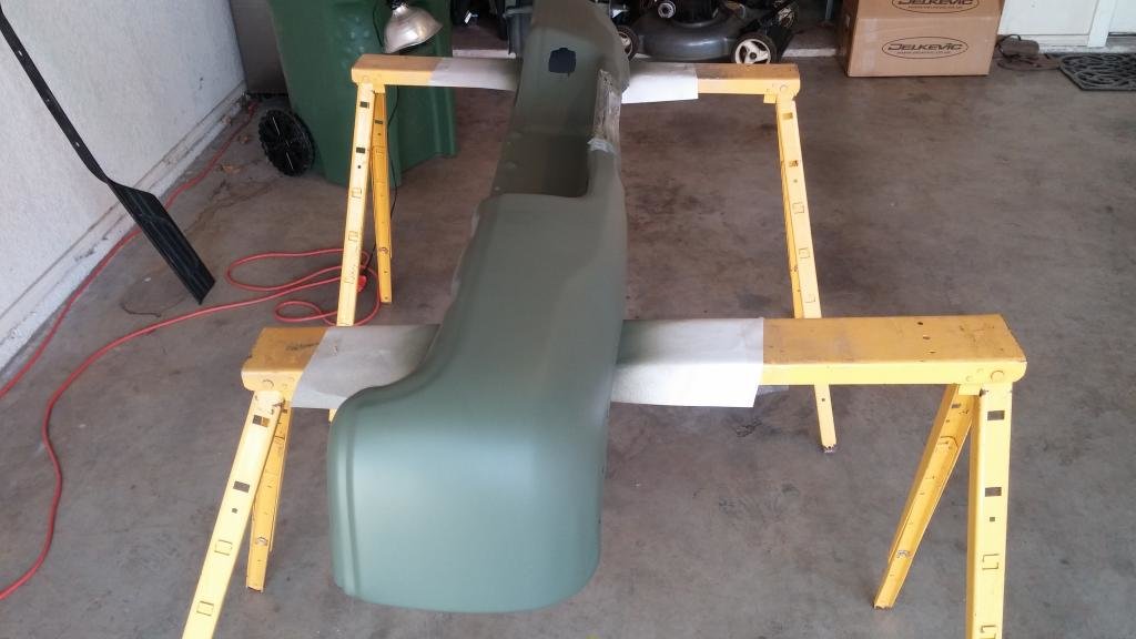

    Then clean surface with duplicolor prep towel and paint 3 light coats of etching primer

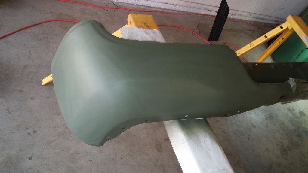

    Then I wet sanded the primer with 400 grit paper. Then blew out all the dust with my air compressor and re prepped the surface with another duplicolor prep wipe

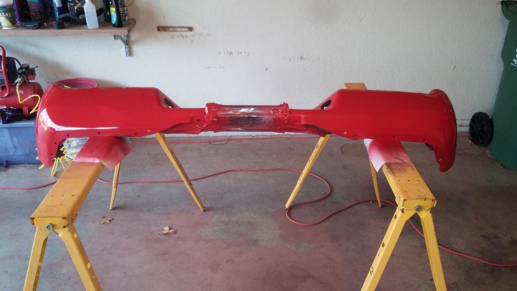

    Then threw on 3 coats of base coat giving 10 mins of flash time in between coats. It will look dull but should be smooth

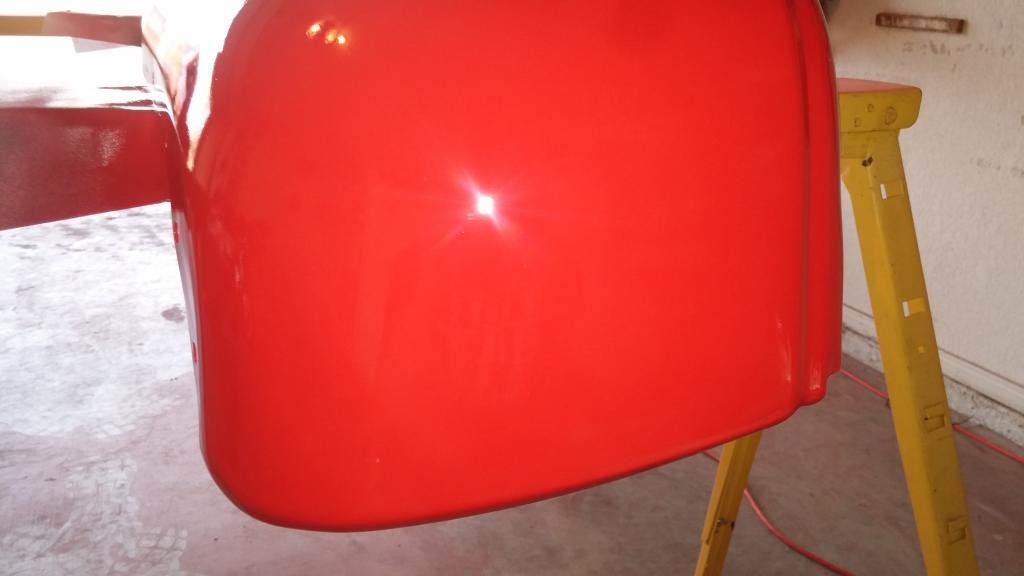

    After 1 hour of the last coat of base, I began with the clear. I did 2 thin coats of clear and the third pass I did a "fat" coat without letting it drip. I think it turned out well.
    I will let it dry overnight before I reinstall everything. After a few days, I will do a mequiars polish on it followed by some NXT2.0 wax to make it pop.

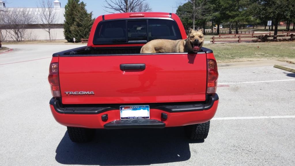

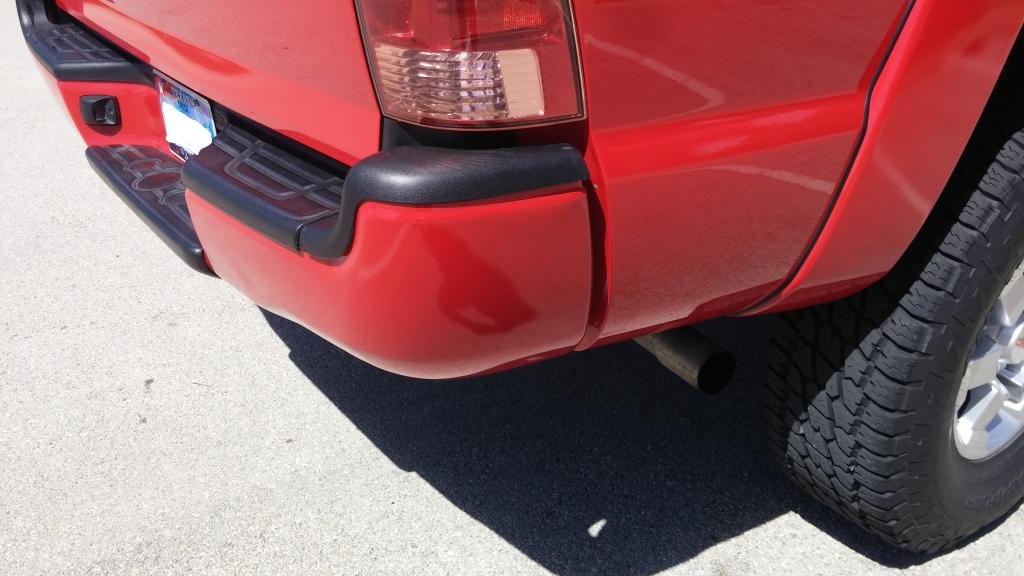

    Finished product. Looks dam close to the factory paint

  5. Mar 20, 2014 at 11:35 AM
    Mops
    Mops Well-Known Member
    Feb 25, 2014
    #124005
    375
    Mop
    NW NC
    Nice job!

    unless you're closer than the camera I'd say looks factory to me :)
    Nice job!

    Looks great to me...factory if I didn't know better! Nice job!

    I have about 2000miles of 50/50 city/highway driving and no chips or flaking at all. I waited to wash and wax it for 7 days to make sure it had cured completely. I even sent it thru the auto wash cause I did not have enough time to hand wash it and the truck had bird poop all over it from parking under a tree. Looks perfect!!

    After 2000miles. Not a single scratch or flake

    only thing i would add is a light wetsand with a good polish to get rid of a bit or the orange peel
