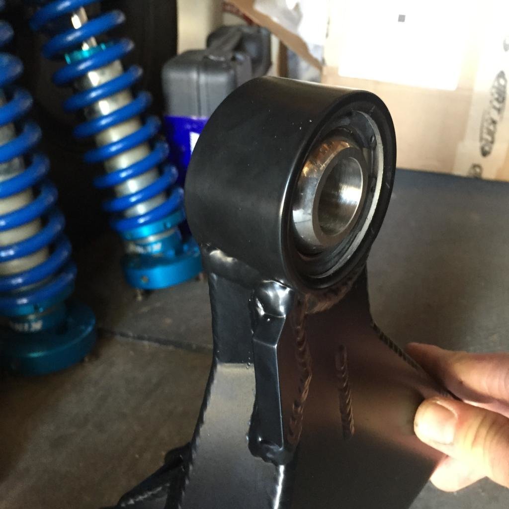

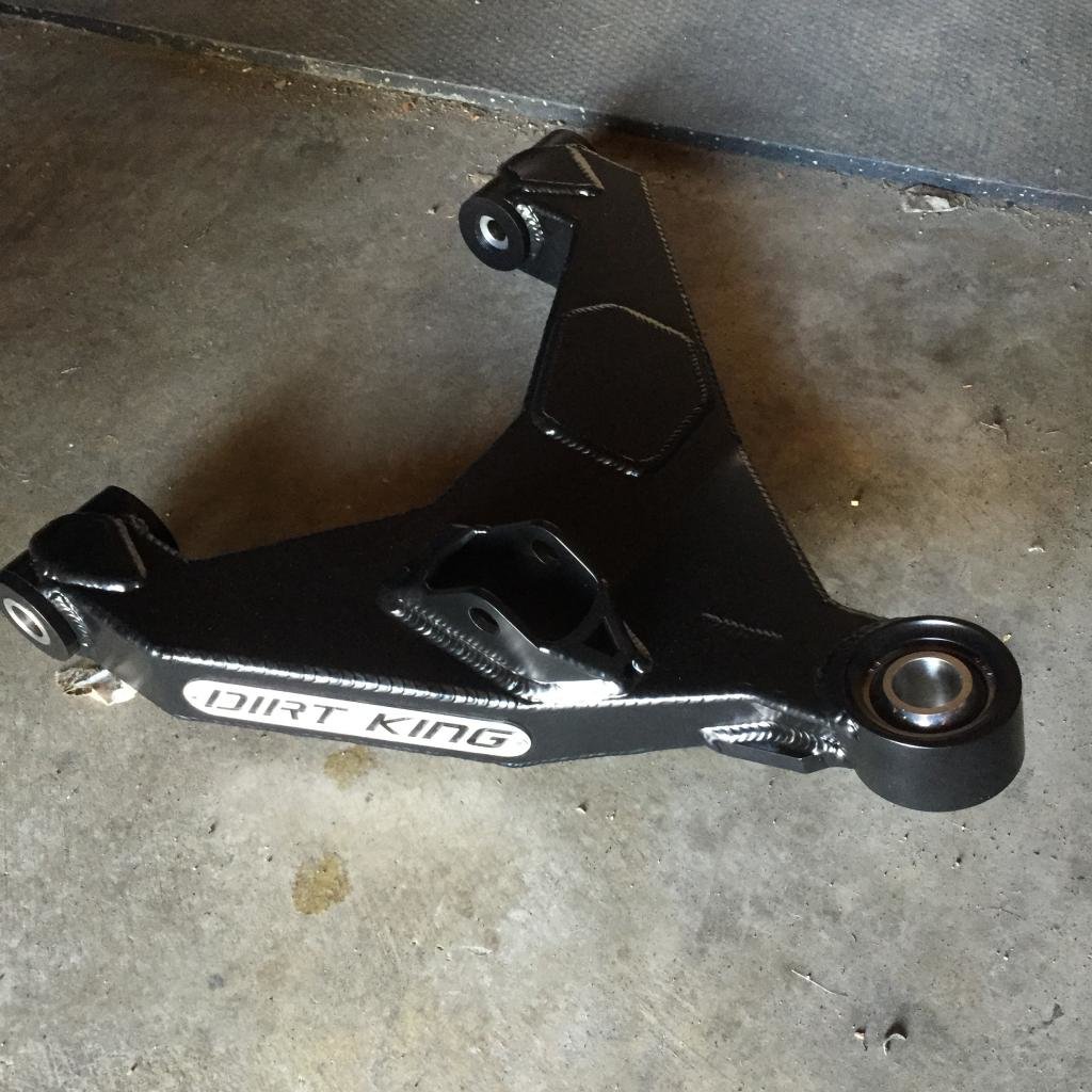

    The DKs have all the bushings on the frame side, and a uniball and bolt that replaces the LBJ on the stockers. If cutting the bolts out you will need new ones, I went with the Moog greasables discussed in this thread, ~$80 for a pair of bolt sets from Rock Auto, PN: K100128, you need two of these kits.
    If you cannot swing the cost for the DKs, the most cost effective solution is to remove the bushings and install new ones as detailed in this thread, though quite a PITA. I would recommend the Moogs based on my experience with the Whitelines, even though I have not actually used the Moog bushings.
    The bump is attached to the frame for both, DK provides a spacer for the bump to move it down a bit due to the design of the arm the strike pad is further away, and the spacer makes up for this difference.

    I don't know about the TC issue, do you have more info? The DKs have a stop built in that you can grind down to fine tune, I have not messed with it at all yet, but it does feel to limit the wheel more than stock, but I haven't proven that by any comparison yet, so it could be just my perception.
    You can see it here next to the uni, looks like a gusset.

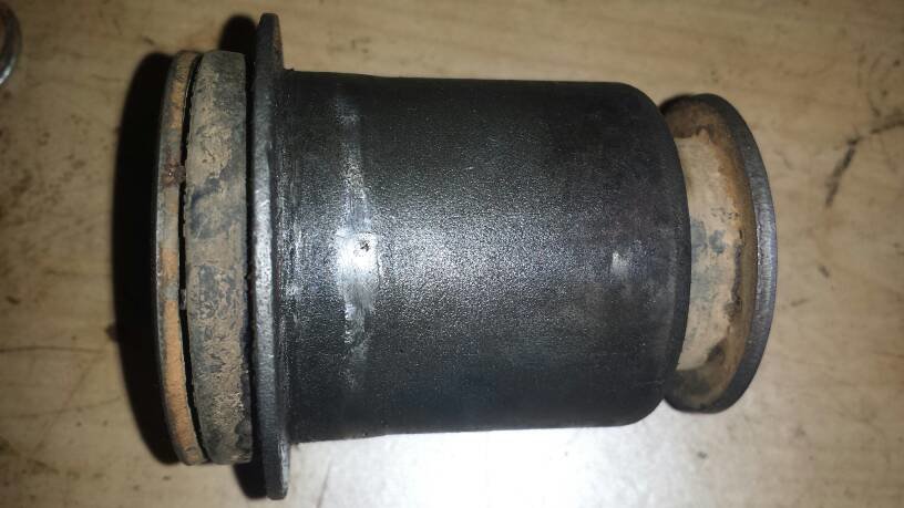

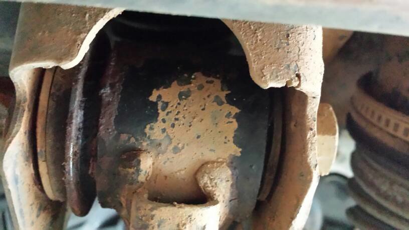

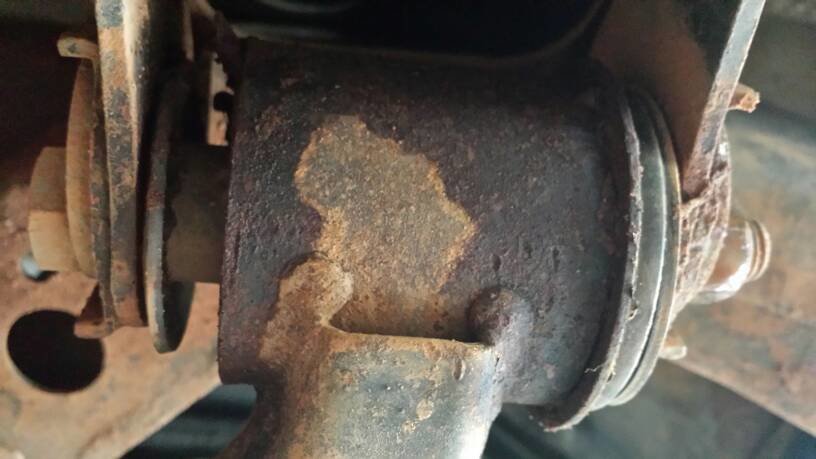

    The moog front (smaller) lca bushings are not working out for me..
    I finally figured out my Pop,Clunk,Bang,Knock in the front end. The diameter of the Moog bushing sleeve is too small and is "breaking loose" from the LCA..

  19. May 17, 2015 at 10:42 PM
    #559
    Haslefre
    Haslefre Well-Known Member
    Jan 27, 2012
    #71523
    18,835
    Brady
    TN
    2019 Tundra
    Some flags and center console divider... lots of things on the wanted list.
    Is your lca mount loose too? Either the video is playing tricks on my eyes, or it is moving a lot more than it should be.
  20. May 17, 2015 at 10:45 PM
    #560
    Sandman614
    Oct 26, 2010
    #45273
    36,024
    Tim
    Garner, NC/Boone, NC
    '06 SR5 Off Road
    The bushing is loose in the LCA. The camera is strapped underneath on the LCA looking up (upside down) lol. What do you mean by LCA mount?
    Edit: oh, I see.. No the frame/lca mount is staying still and the LCA is moving. But the camera makes it look reversed being strapped to the LCA.
