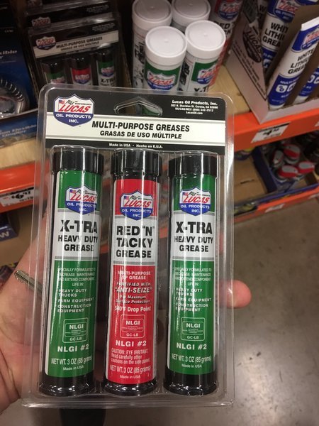

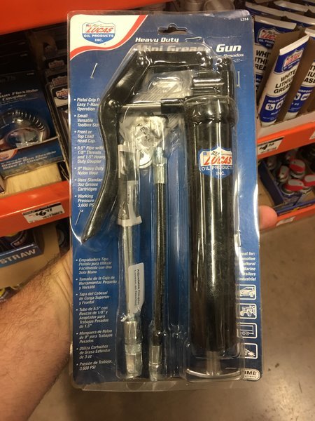

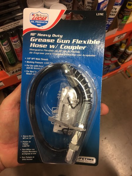

    So I was Home Depot and saw this set up , any good for greasing my shit ? Opinions ?
    A flexible extension ?
    Replacement lube
    It's a "mini" grease gun , but will it work ? Is it decent ? And is that the type grease I want ?
    I don't need a fancy snap on or mac grease gun , I just want something to crawl under and get the job done . Is this brand shit ?
    Thanks for your input

    I wish my Home Depot sold a setup like that.
    ready6delta likes this.

    Serious ? Think it's good ?
  20. Jun 4, 2017 at 7:07 AM
    #60
    Lester Lugnut
    Lester Lugnut Well-Known Member
    Mar 3, 2010
    #32477
    2,822
    N of Mex-S of Canada-E of LA-W of NC
    '15 Tacoma PreRunner V6 SR5 Auto
    Yes I do. The pump holds 3 oz. tubes - the smaller version. I have a grease gun that holds 3 oz. tubes and I prefer it. Easier to handle when you're crawling around underneath a vehicle.
    igno1tus likes this.
