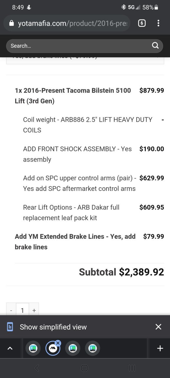

    I was looking at the Bilstein 5100 set up, and was going to add ucas, maybe icon or total chaos.

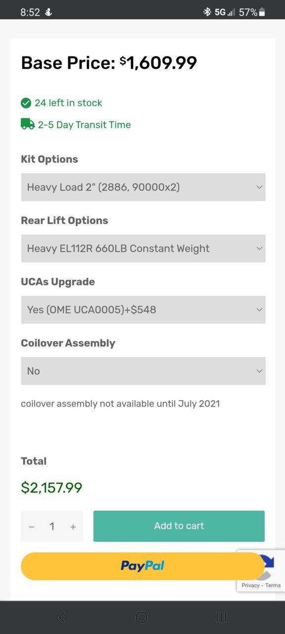

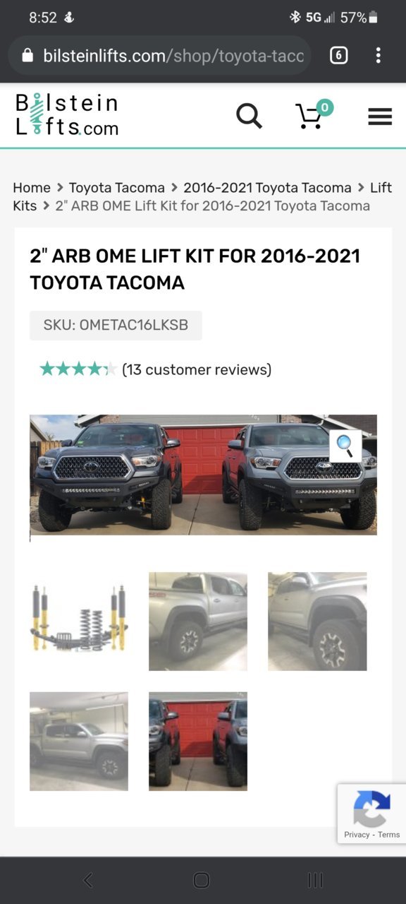

    This? Screenshot_20210722-085220_Chrome.jpg Screenshot_20210722-085225_Chrome.jpg

    the 886 springs from OME are great for added weight. I ran them on my second gen tacoma with steel bumper, skid plates, and rock sliders and the springs held up great.

    SPCs are great UCAs, which allow more caster which is needed if you plan on running 33s. I hated the OME leafs, they squeek like crazy, would recommend Deavers, Icons, or ATS packs. My OME suspension has been fine, I didn't love it, with 200lbs it's squatting a bit on 885 springs, it's not a Cadillac like you can get by spending a lot more on Kings or ADS

    Get 886 if you plan on running weight - NOT 885s. 885s have the same spring rate as 884, just taller.
    I've run 33s with no issues on 3 different rigs. No aftermarket UCAs. So not sure they are needed, though maybe you could get better numbers with them.
