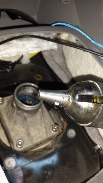

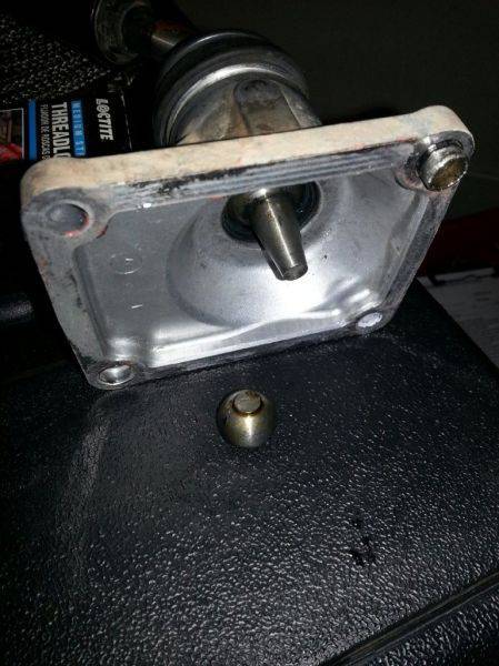

    Here's a little thread revival.
    This happened to me last July putting it into reverse to back into a parking spot. It stayed in neutral, so I was able to push it out of the way. I didn't want to drop $200+ on a new shifter, so I just welded the ball on and made it a permanent fixture. The conical clamp exerts excess stress on the stock ball, and thus it shears off. Not a perfect design, but the stock shifter wasn't made to have that extra inch added to it. It can't be said it's a faulty toyota part, but rather a toyota part breaking due to strain above its working tolerances due to the URD add-on.
    20140726_153458.jpg 20140727_101446.jpg20140806_133741.jpg20140806_140045.jpg

    well that looks like a solid fix.
