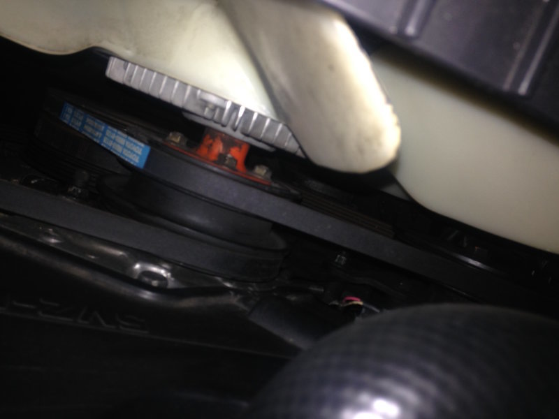

    it doesnt show a tow package but i bought the truck with the factory hitch on it. but have orange fan clutch....? and no transmission cooler.. i dont think there was ever a complete tow package offered by toyota for first gens. i think they just bolted on a hitch...?? and possibly a different color fan clutch?IMG_0715.jpg
