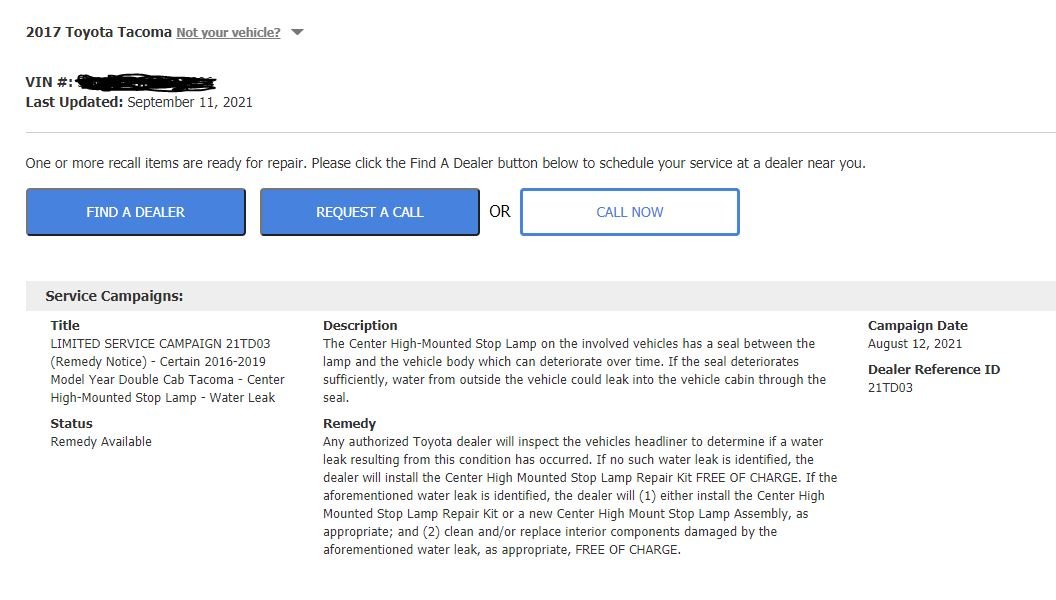

    I was looking at recalls on my truck and see there is actually a recall for the third brake light leak. This has not affected me but according to the recall, I can take my truck in and they will do it anyway like they should. In the past on some recalls, they look at it, determine it don't need it and send you on the way.
    Just a heads up for those who don't know. Also, in the past, If you had this repaired and paid out of pocket for it, if you have receipts, they will reimburse you since it is now a recall. Worth a try.

    Ya, going to schedule mine next month when work slows down a bit. See if they will do the TSB's (T-SB-0062-18/T-SB-0058-18) for the ECU flash while they have it anyway. Mine is a 2017.
    They are mailing out recall notices this week as well.

    Thanks for the heads up @suprafastcelica. I just checked my VIN and it came up too. Wonder if this has any relation to the email my local dealer sent me on Sept 12 saying there is an open safety recall for my vehicle.
    @nightcrawler did they end up replacing it? Mine doesn't leak either, but it's prob worth doing if it will prevent it later on.

    When I made the appt it said this "LIMITED SERVICE CAMPAIGN 21TD03 (Remedy Notice) - Certain 2016-2019 Model Year Double Cab Tacoma - Center High-Mounted Stop Lamp - Water Leak"
    ends at 2019...but I dunno if there are any 20's or 21's that may have had this issue.

    What's the official fix? Do they need to remove the stop light to install a gasket or does it sit over the light on the exterior only? I had mine leak in March 2020 and got denied warranty on it at the time so I repaired myself with some industrial RTV. Its been bone dry since but I don't want the dealer messing with that if they have to remove the light for the service

    They remove the brake light and add a different gasket which appears to have some sort of adhesive to it.
