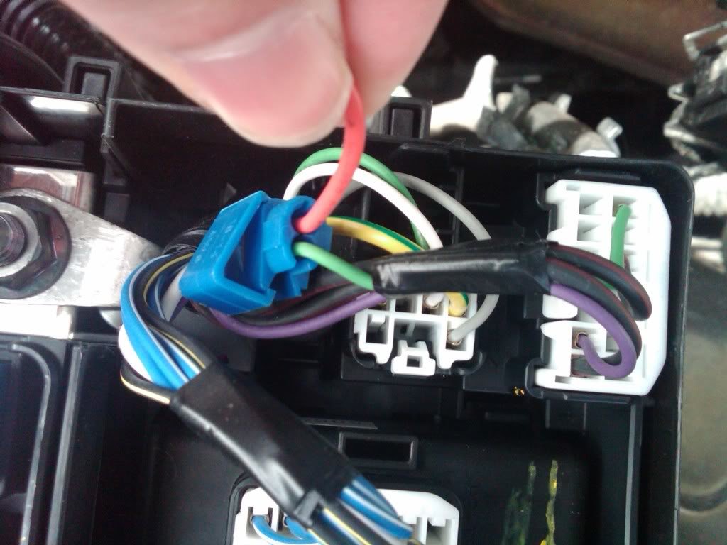

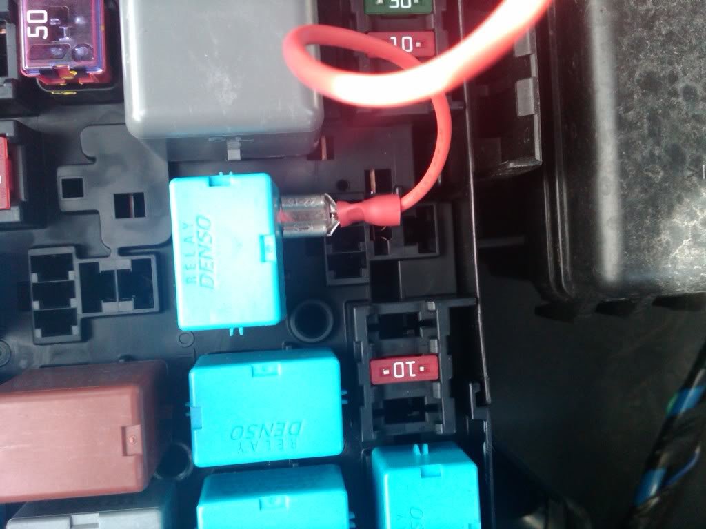

    Ya i know what to do at relay but what do i do at green wire

    Just get a wire tap to tap the wire from the relay to the factory wire you have to splice into. I'll run outside and get you a pic.

    Ran the red wire from the relay to the green wire. At the green wire I just used the blue wire tap to tap my red wire from relay to the green wire.

    Bro you rock! so that it you just end the wire at the splice thing at the gree wire?

    Yes, sir, obviously used the part of a blade connector for the relay, then just had the wire long enough to reach that green wire and used that connector there to splice into it and that's it. Other types of wire taps you could probably use, I just used that kind since I had a lot of them laying around.
