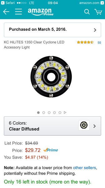

    Which rock lights are you using? If the are self grounding, then it gets more complicated.

    Quick test. Disconnect the ground wire that you have booked up to the blue wire from dome light. If the lights stay on then your lights are grounding through the mount. If that is the case, you will need to wire a relay.

    Yeah that was it!!!!!! so now I'll find a way to secure them to the underbody of the truck without them being grounded thanks for the tip appreciate it
