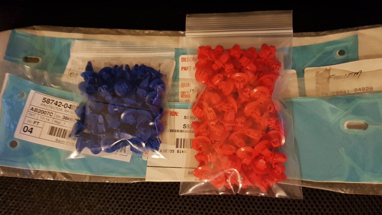

    Splashliner clips -
    https://smile.amazon.com/gp/product/B07B638VF6
    Flare clips -
    https://smile.amazon.com/gp/product/B01A4MHYWA
    NOTE: when you first take the flares off, make a note of which hole has which clip (red/white). Easy enough to fit them up (one is larger than the other) just easier to take a pic for reference. snap clips onto flare first when reinstalling

    Yes you can if you don't mind the wait. ;)
    I've got enough for 3-4 sets for only $6-7 shipped from China.

    Lol, yeah but they take a long time to come from China. I didn't mind the wait cause I didn't need them right away. Otherwise I'd order from Amazon or ebay US sellers too. They also sell em at auto parts stores now but only in 2 packs or so, expensive but it's an option if you just need a small quantity same day.
    Before they made aftermarket I used to buy them from the dealer for like $1.10 ea with my discount.

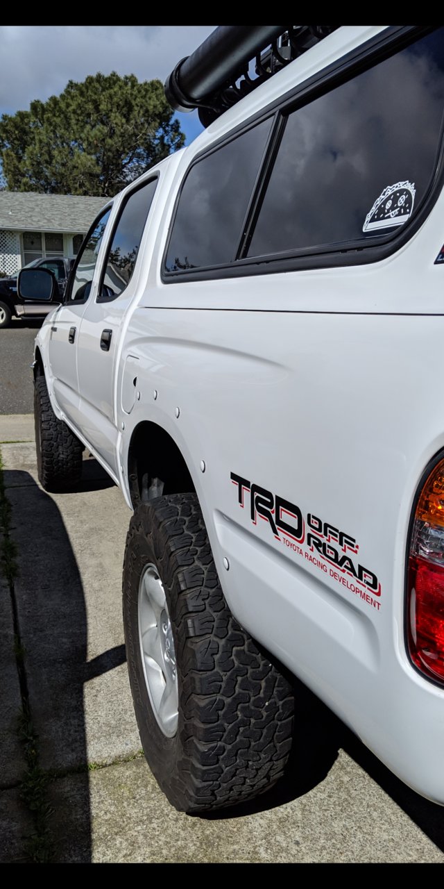

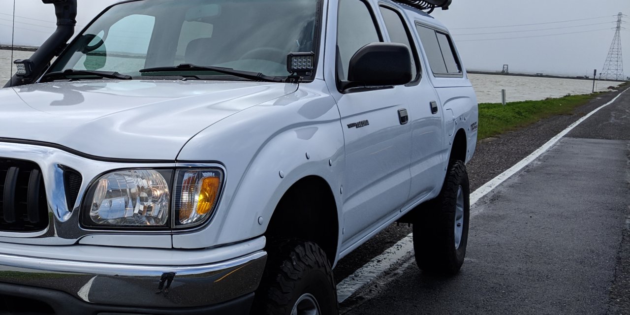

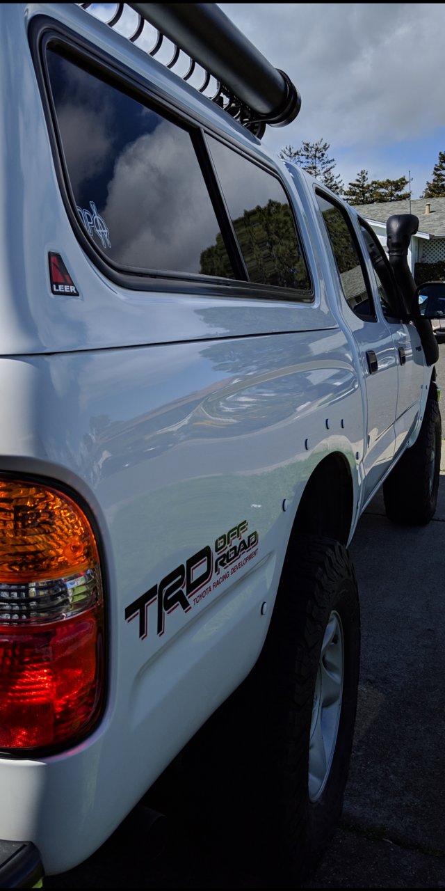

    Anyone got any pics of flareless setups?

    Not the best but here you go...

    Looks pretty good. The caps in the holes dont look bad at all.

    What did you use to cover the holes?

    So there are a couple of different ways to go... This one looks the cleanest but seems like a huge time investment.
    https://www.tacomaworld.com/threads...the-fenders-after-removing-the-flares.304366/
    Others have used hex allen bolts to plug it up (https://www.tacomaworld.com/threads/who-runs-no-fender-flares.472199/page-2#post-14255901 & https://www.tacomaworld.com/threads/1st-gen-double-cabs.371543/page-60#post-14611248). Not a bad look but I went with this for now -
    https://www.tacomaworld.com/threads/diy-fender-push-rivets.557983/
    A trip to your local fastener isle and you'll come up with something of your own. Lots of possibilities.
