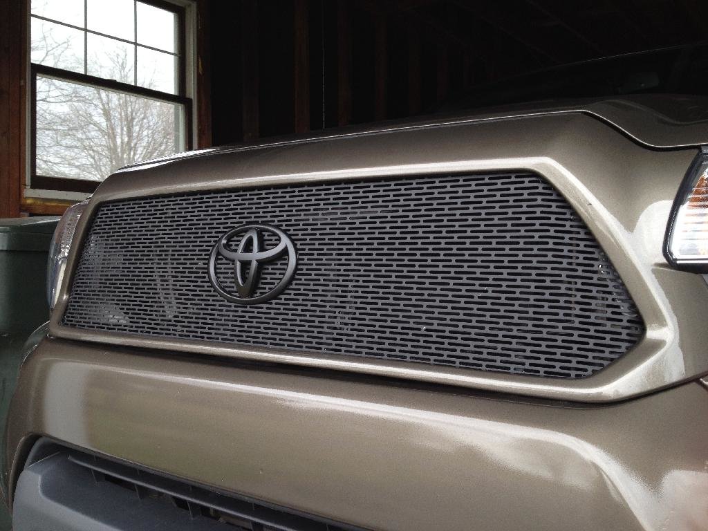

    Not a fan of the middle of the grill sticking out past the out edges of the shell. Thats why I changed the factory grill on mine. This cost me about $40.

    Same color here, how did that cost you 40.00? Was it pre cut to size for that grill???

    Nice! That's the kinda grill I've been looking for with the black mesh and dark colored "TOYOTA" lettering. Where did you pick that up at?

    Grill? or lettering?

    The lettering. I've seen the same black mesh grill type but I can't find one with that lettering already on it

    It doesn't come with it and you have to modify it to fit..
    Here's the part number: Toyota Part 75311-90K00

    Got some JB weld some nuts, bolts and plastic washers. Used this method of taping on the emblem to the grill to line up where the bolts would go in:
    http://www.tacomaworld.com/forum/2n...nswer-converted-into-mod-write-up-w-pics.html
    Marked it with a permanent marker, processed the JB weld, lined them up with the dots I made ahead of time and JB welded the bolts to the emblem being careful not to move them. Let it dry for 24 hours and test fit them. Came out perfect.
