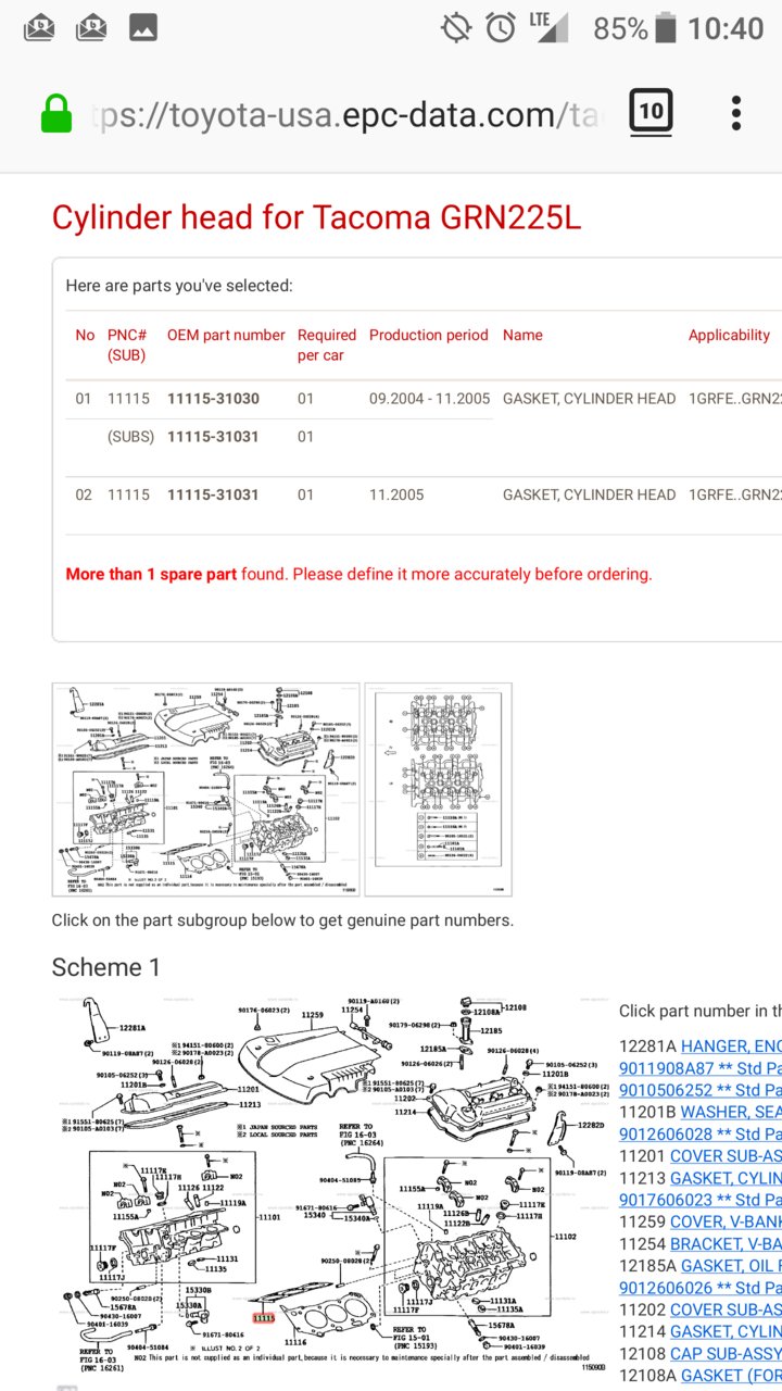

    Example....
    Head gaskets...
    Pre November 2005 Vs post
    Thanks for the link, I'm finding it interesting

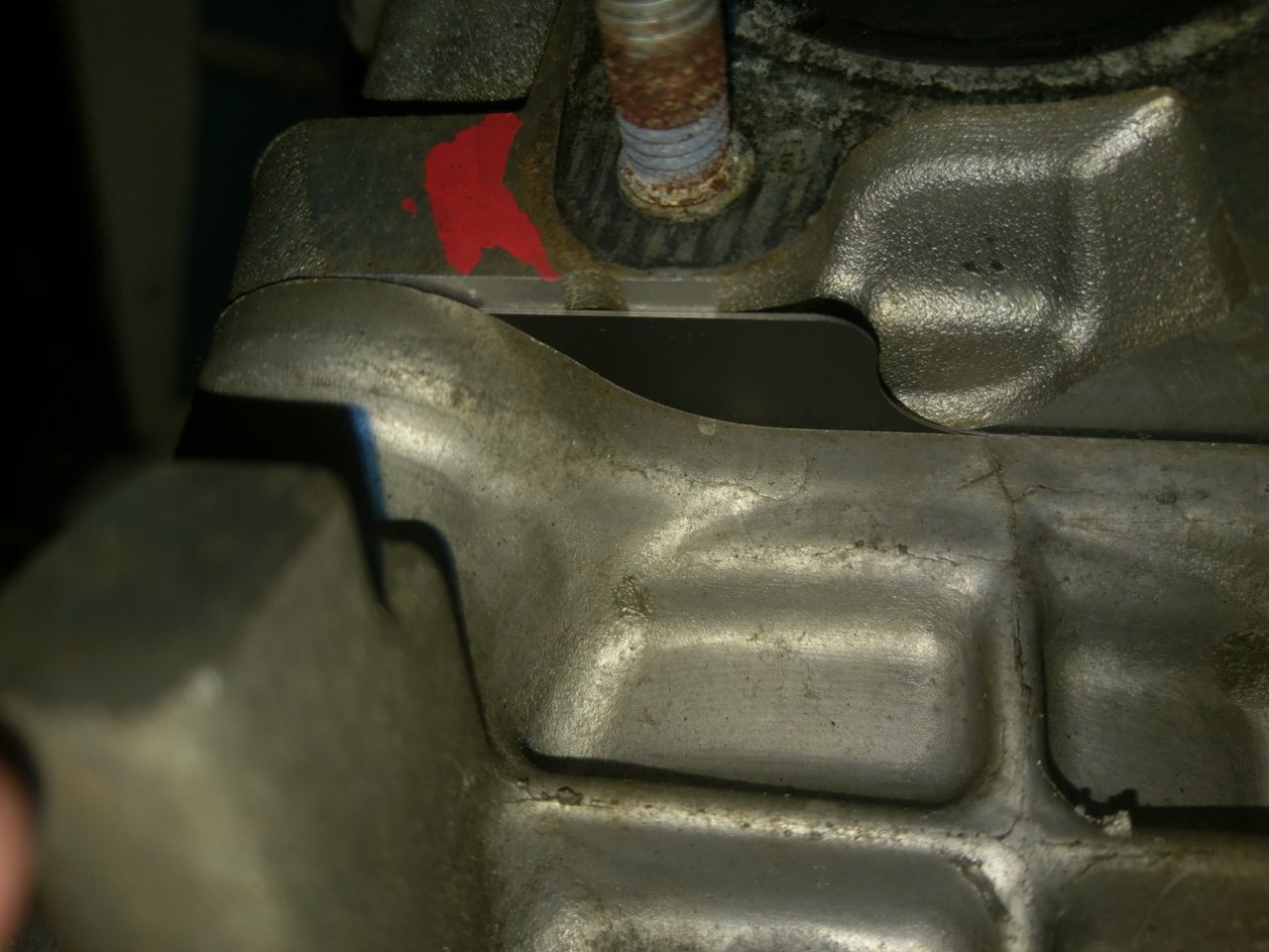

    Can anyone in here with more knowledge on this help this gentlemen? Mechanic milled his heads and valves .005 and now it's throwing a p0012. I remember reading about milling down the heads on these trucks and it causing the timing to be off, but I do not have much knowledge on the subject other than that. Figured someone in here with some experience might be able to chime in

    Milled the heads and valves the exact same amount? Sounds like a generic answer. Get a flashlight, look at the heads gasket between the heads and block on each side. You should be able to see, above the head gasket where they milled the heads. Did they mill bank 2 more than bank 1?

    .005 milled off both sides . He even had the guy that milled it take a look again
