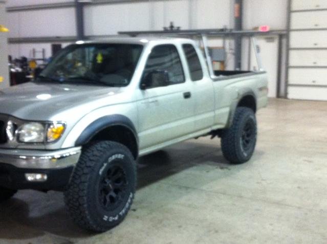

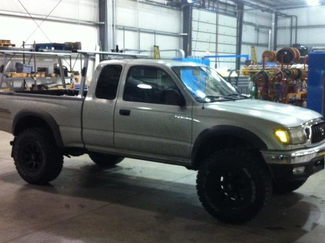

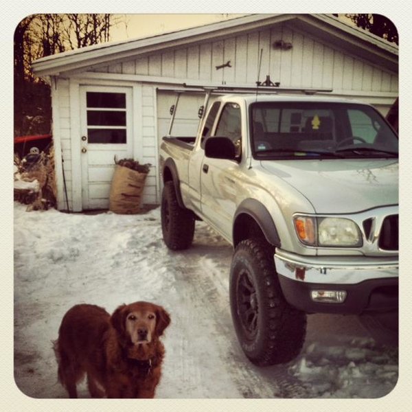

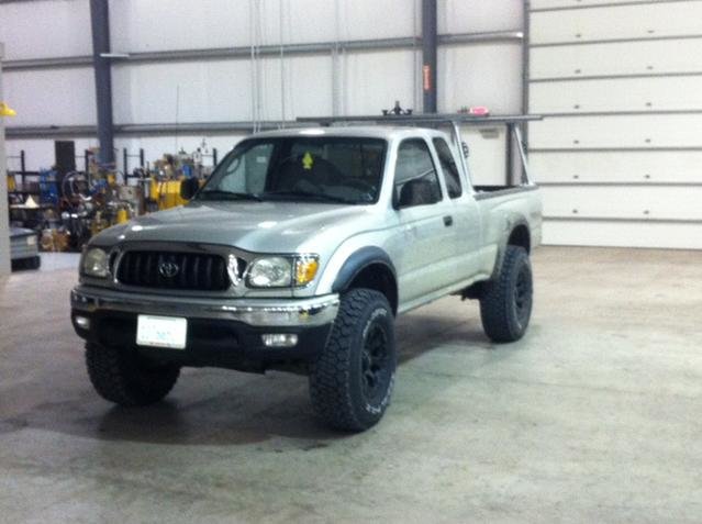

    So here it is with my wheelset finally installed. I had to do some fender trimming. I'll send my pictures of that soon too.

    Looks good man, glad you got everything worked out.
    Did I miss what the rear setup was? Also what's the BS on your wheels.

    I have the Toytec OME 3" lift with leveling kit. I used an AAL and nitrochargerxs in the back.
    My wheel BS is 4.49". I have no frame rubbing issues. I had to do the pinch weld mod to get my tires to work. I still have to trim a little more too.

    Looks good. Let me know where else you are trimming. I'm ordering 285s soon so I'm curious where you are trimming.

    Looking good! :thumbsup:
