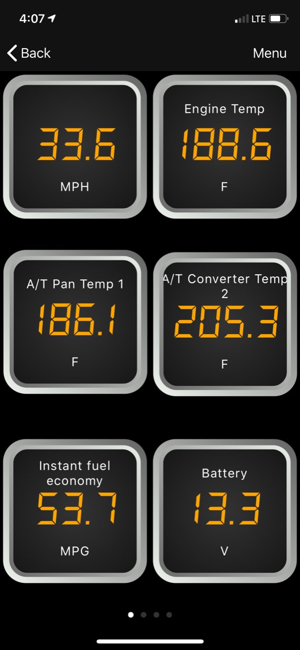

    I know this post is old, but I bought the "toyota enhanced diagnostics" and it has what I believe are trans and converter temps. Can anyone else confirm that's what these are (I renamed them on the shown graphs, when purchased they were marked as trans temp 1 & 2. ) as I'm going to do a drain/refill soon and would prefer to just use this to read temps.

    The 2 temps are for converter and pan. For a D & F , you want pan temp.

    Correct, I just wanted to confirm I had them marked correctly. So I have them backwards? #1 is the converter?
