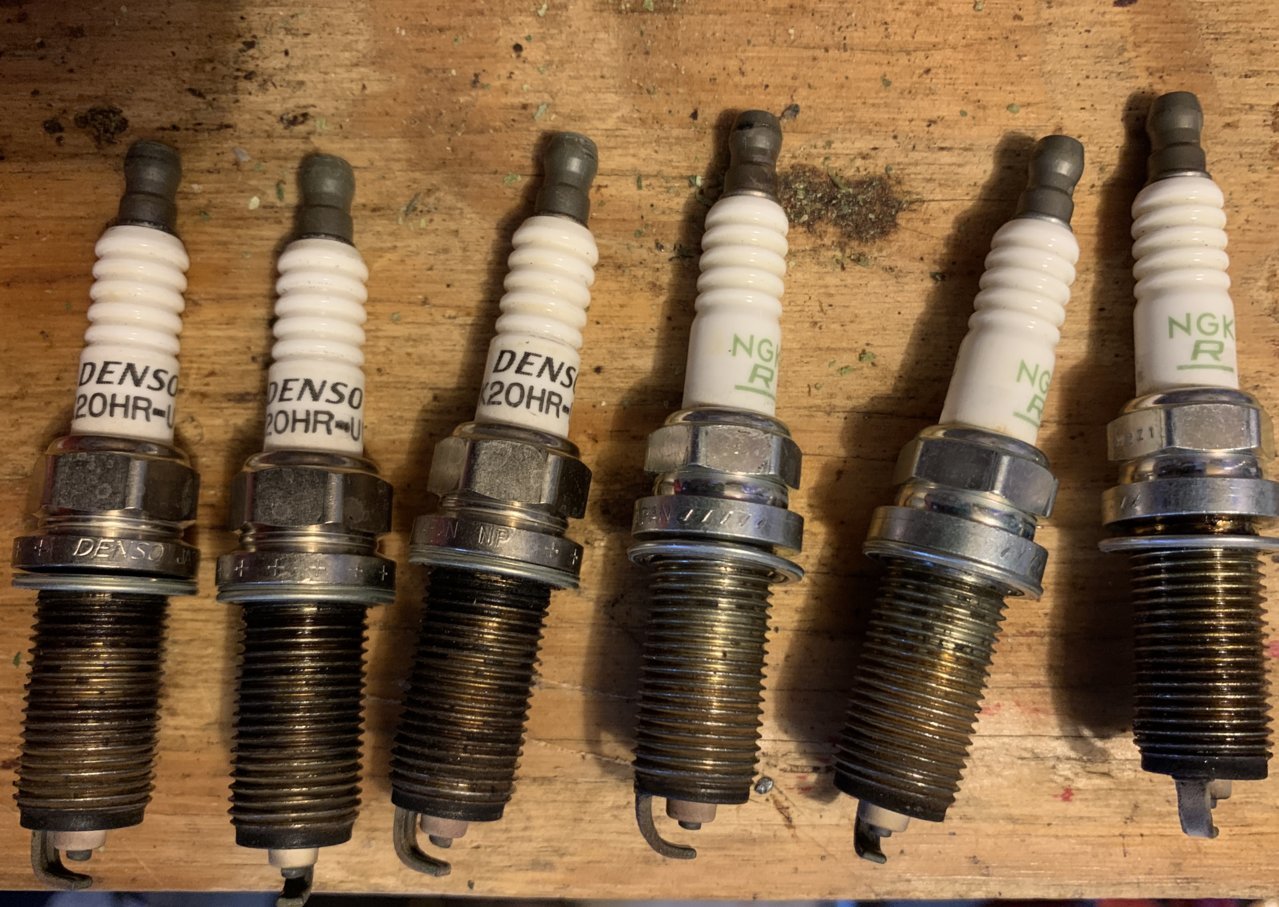

    Did mine today and it took 1.5 hours. The ones I took out were Denso on the passenger, NGK on the driver. I did a quick time lapse video. Also, I found it useful to use a socket swivel as pictured. Really helped on a few. I used the recommended spark plug, I bought locally from Toyota and they were all pre-gapped to .044.

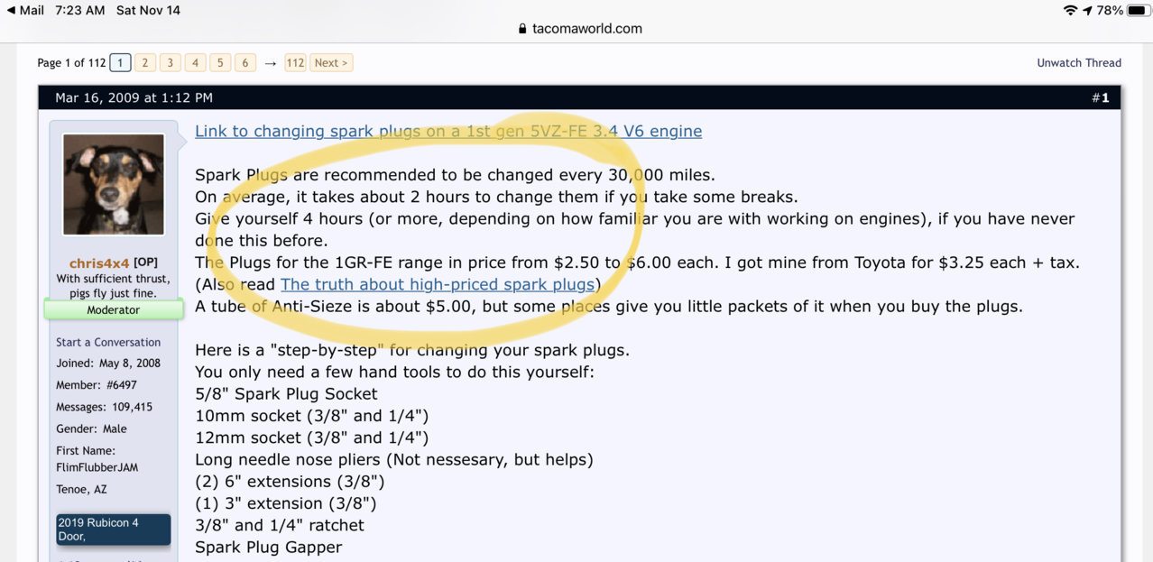

    First time doing this vehicle. I read back and most of us took 1.5 - 2 hours. Glad you’re gifted! Here is the original post, highlited for your convenience. It looks like I came in under the average so looks like I’m all set. Thanks for your concern though.

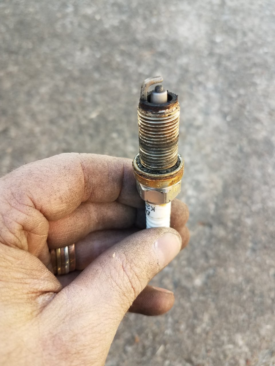

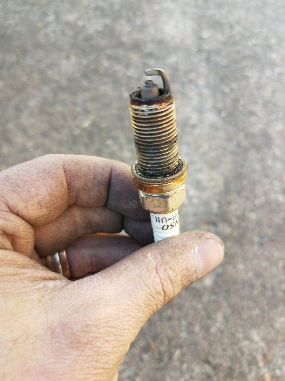

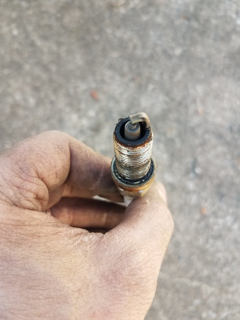

    I just changed mine yesterday and they seemed to have a lot of gunk built up on the threads and around the crush washer. Is this normal? I don't remember what they looked like last time I changed them. Also the 15ft lb of torque scared me a little bit seemed to tight to me20201128_113115.jpg 20201128_113052.jpg 20201128_113035.jpg
